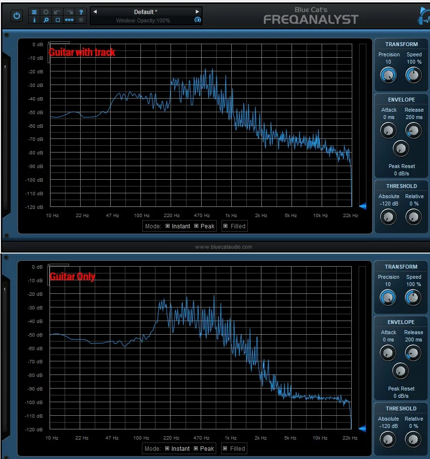

Comparing the first section to your clip with the guitar, the hiss was at about -47dB. The hum part was about -40dB, so 7dB of additional noise. The guitar section peaks at about -4. But, the hiss is clearly audible. I'm not sure where that is coming from, the ZED, your guitar, your volume settings (improper gain staging), pedals (do I hear a bit of a compressor? The hiss seemed to pump a bit).
The hum you are getting when you don't touch the guitar shouldn't ever be an issue, as you HAVE to touch the strings to play the guitar. The hiss, on the other hand, is a bit of a problem, although with a full band playing, most people wouldn't notice it. But people who listen for that stuff definitely would hear it. ~43dB S/N isn't a very good level.

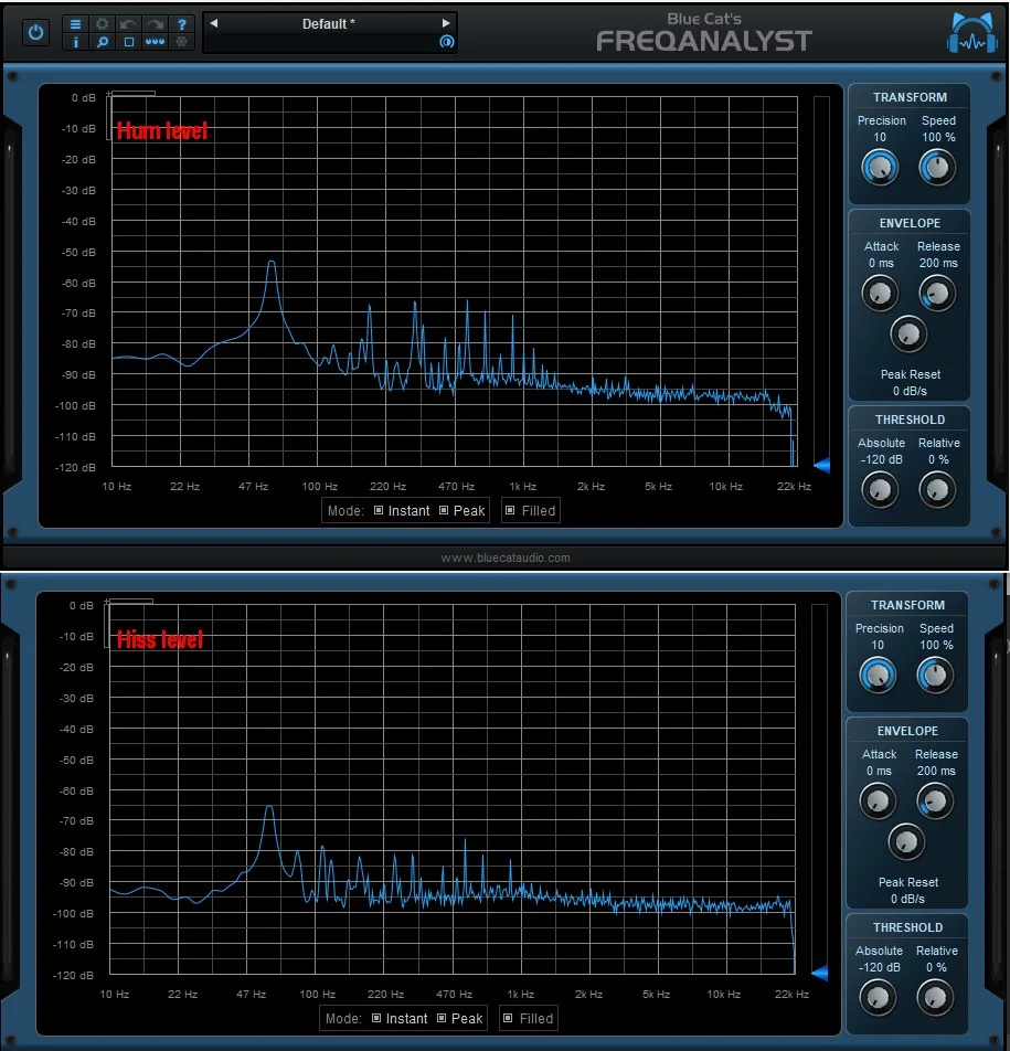

Here are the noise profiles for the 4 sections (ignoring the first couple of seconds were you got some hum.
The main hiss is primarily around -90, but there is still some hum that pops up to about -65dB. The hum section is more like -52dB for the highest peak. The highest peaks for the music parts are around -20dB.

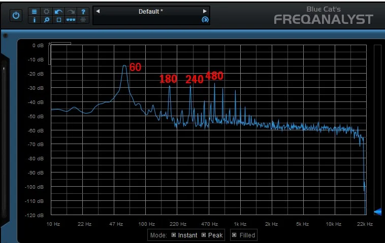

The hum is classic... .60 cycle and multiple harmonics which you hear more than the 60 cycle unless you have a subwoofer.

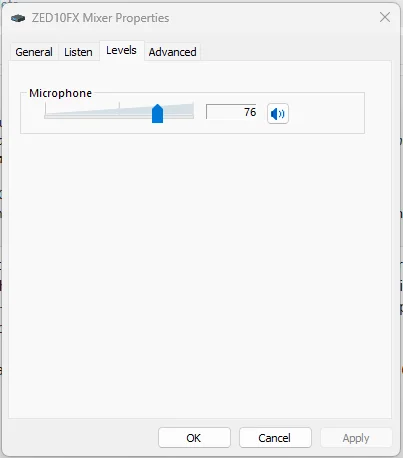

I am not sure of the exact mechanism but the old 16 bit converters in many brands of USB mixers had this problem. Windows defaults the "gain" for the input device at 100% and this results in the hash, similar to what we see in your spectra. The fix is to reduce input gain drastically in Windows Sound Control (as per the attachment) to 5% or less. The hash now drops to around -80dBFS but you have to increase the analogue drive to compensate. A&H fairly quickly fitted 24 bit converters which did not have the problem. We later in fact got a Soundcraft Notepad mixer which was 24 bits and very quiet.
Note, this is not a slight on 16 bit converters overall. There were and still are 16 bit devices that deliver close to the theoretical 96 dynamic range.
Level 5 wouldn't even be audible for the input level in windows?!? I have it at 76 as it is now...

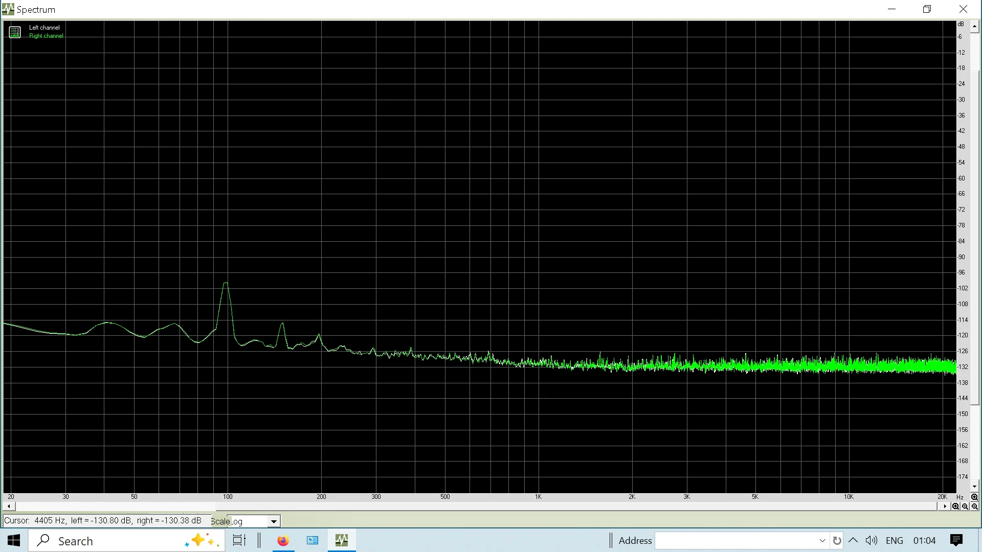

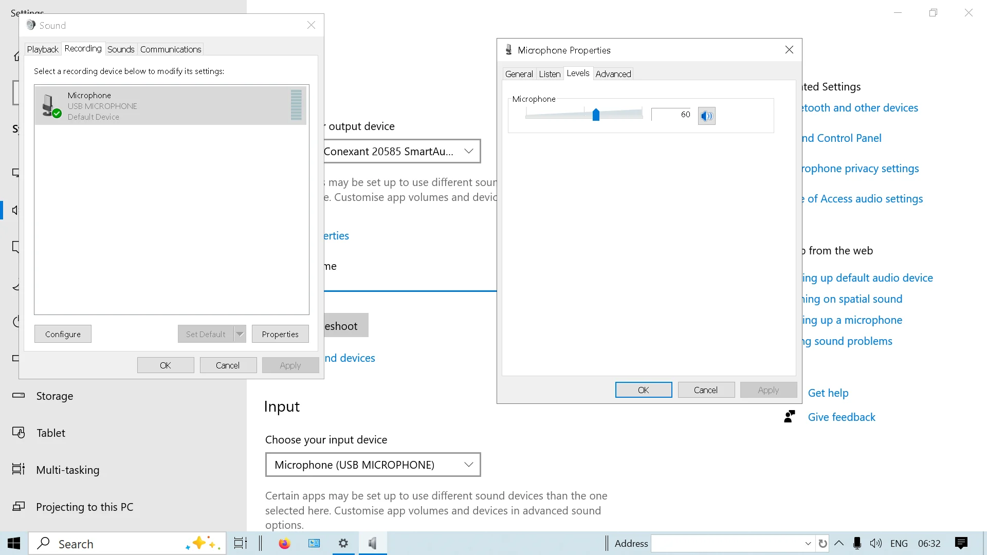

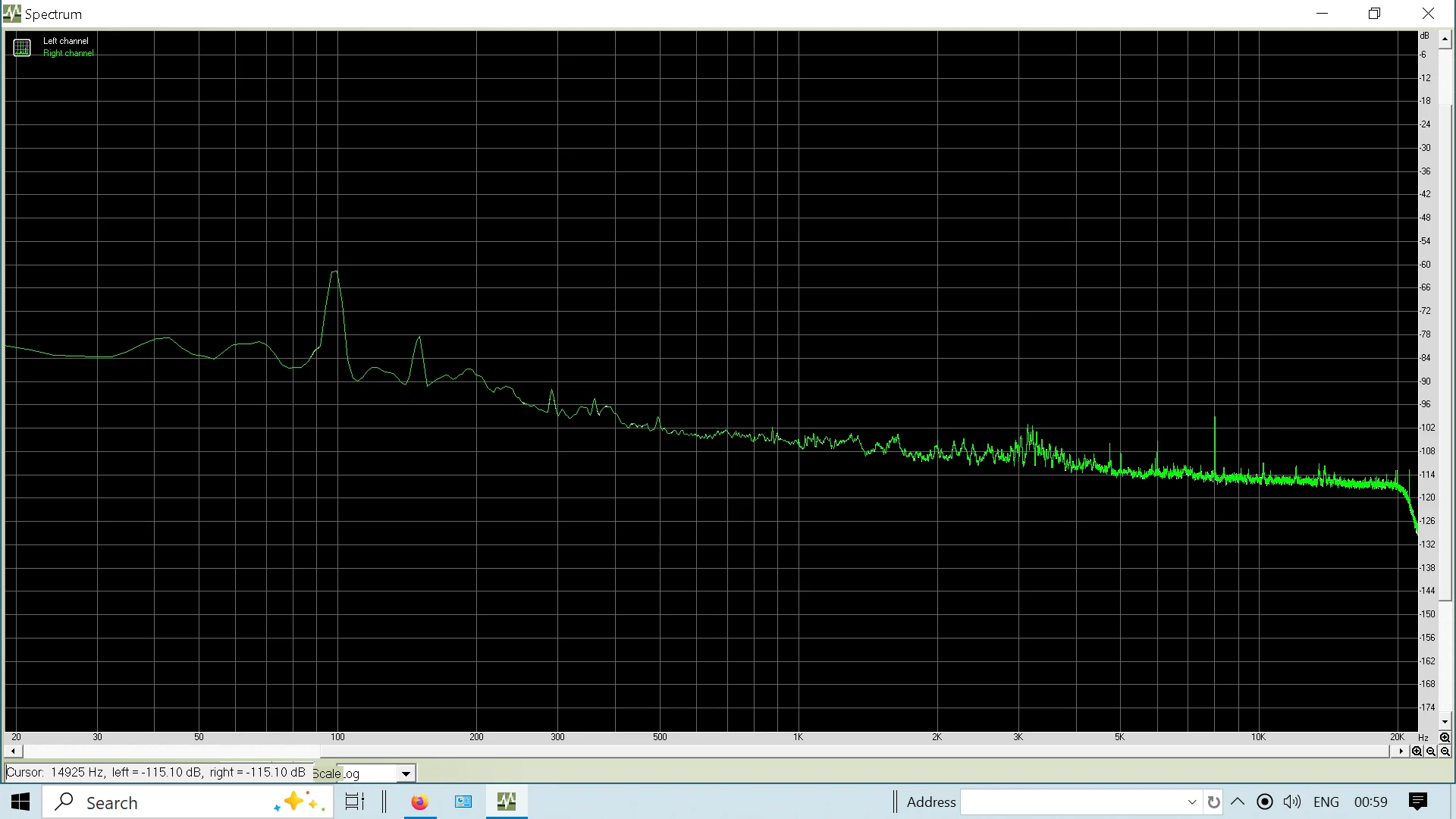

I am ONLY talking about the Zed 10 and its possible 16 bit shortcoming! My USB mic is nowhere near as noisy as I recall the Zed being. The 100% spectrum shows a spike at precisely 8kHz. Ideally that should not be there and is an artifact of the mic's converter I would say. The hum at -60dB is because I have the laptop on charge. Note it is at 100Hz, not mains at 50Hz.
The 6% spectrum shows that the 8kHz 'whine' has been subsumed into the noise floor. Hum as you can see is not at -100dB.
Do note! These decibel figure do not indicate the actual noise levels. Right Mark Analyser is not calibrated. Note too that even at 6% gain the mic still worked. I clapped my hands and got an indication. The optimum seem to be around 60%.

You guys keep posting these images, I have no idea what they are.. I'm not as techy as you
The plots are not really 'techy' - they're just a left to right display of frequency, with amplitude on the vertical scale - 20-20K, the full audio spectrum. There is a hum at 100Hz, and another just above 150Hz - usual UK mains hum as was mentioned in the topic earlier is 50Hz, but the first harmonic of it is 100Hz. Learn to read these, they're really a good way to see what you are hearing.
