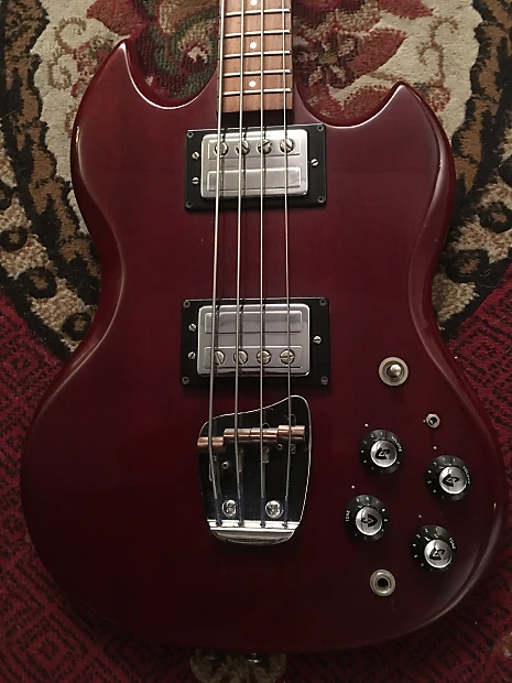

Bill's bass is an old Guild JS2 bass which even has humbucking pickups. There are no pedals on his end, just a clip on tuner on the headstock. There's a cord direct to the instrument input of one of the mixers. That's why we were really surprised when he plugged in and when the faders were pushed up we clearly heard "News radio 84...." coming through our headphones. Unfortunately, the radio station is a 50,000 watt AM station, and the towers are about 2 miles down the road. Like I said, I suspect there may be some guitar cable issue at play here.
Heck, I was even playing my new H-530 with P-90s which are single coils, and there's NO shielding inside a hollow body guitar, yet I didn't have a bit of a problem.
