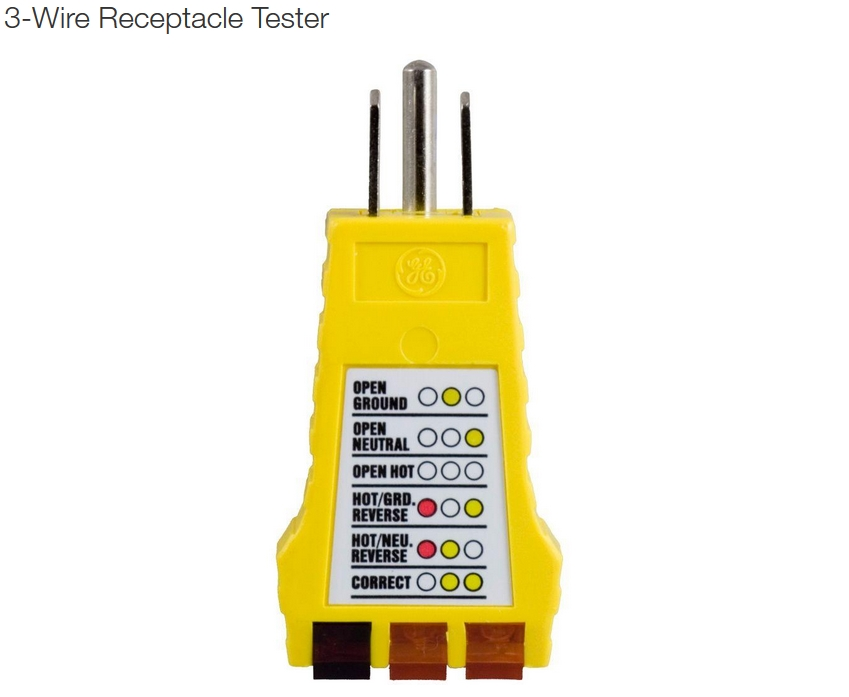

Don't assume things are right, the noise could be a warning things are not right. Even a simple plug in tester like the one below can save a life, I carry one for when I am setting up live shows to check the power points.

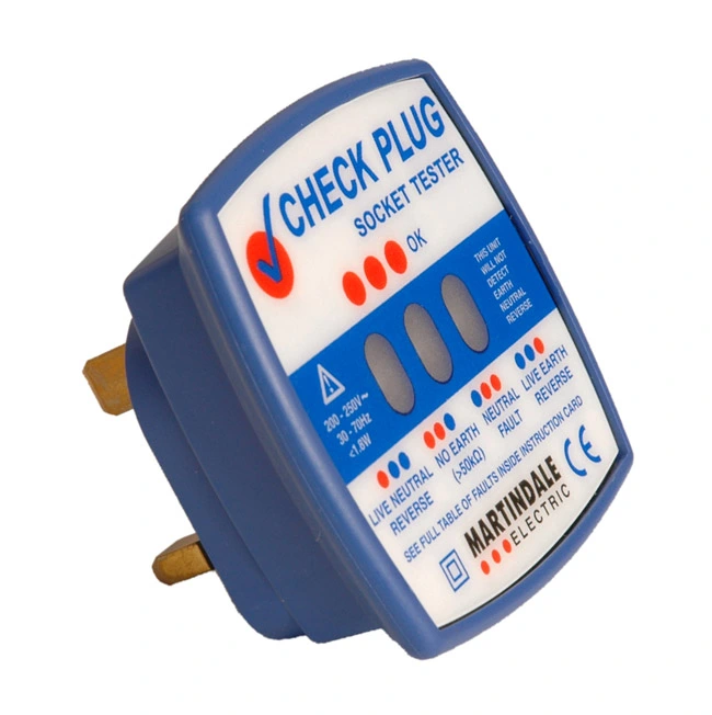

Ironically, Martindale had to do a recall on a similar product here in the UK when a few were found to be potentially (no pun intended) dangerous.

The 'yellow' American tester shown above gave me some erroneous indications a while back when I checking some circuits. It is designed with neon lamps and resistors and seems susceptible to capacitively coupled AC and it was showing partially lit lights for a circuit that had an open, but had some AC coupled to it from an adjacent leg. Most times that tester works good, but this was an odd problem.
I bought a solid state tester which has seemed more reliable in identifying wiring problems and it wasn't much more in cost than the yellow type......
