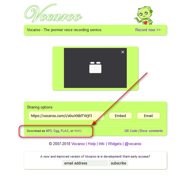

Mark, what did you do to get that link to play please? I pasted it into Fire fox but just got the Voccara website, no sign of OP's audio.
Dropbox I can handle (sort of, it grabs everything, runs all the time and I don't like that so I don't have it installed) but now there are SO many obscure bloody sites!!
Jus' paste a freeking MP3 for 20 second tests chaps! I don't then have to record it again, just stuff it into Samplitude and convert it to 16 bit 44.1kHz .wav for Right Mark anny. (cos, if 16 bit wavs wos allowed for short tests???)
I had to look a bit as well.....

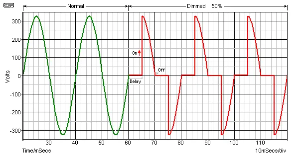

The main light in the room i have this gear set up uses a dimmer switch that actually emits a weird buzzing noise when turned on. You think that could have something to do with it? Because i too am starting to suspect it has more to do with the electricity here than with audio wiring and the equipment.
Dimmers can be particularly 'noisy'. They work by 'chopping' a clean sine wave into smaller chunks which deliver less power/voltage to a lamp. The chopped up chunks tend to have sharp rise and fall edges which can create harmonics. Kill the lights that are fed off the dimmers and see if there is a difference. I had mentioned in an earlier post florescent/CFL lighting. Some of these can put out noise if they use electronic ballasts. LED lights also have electronics in them which could be suspect.
