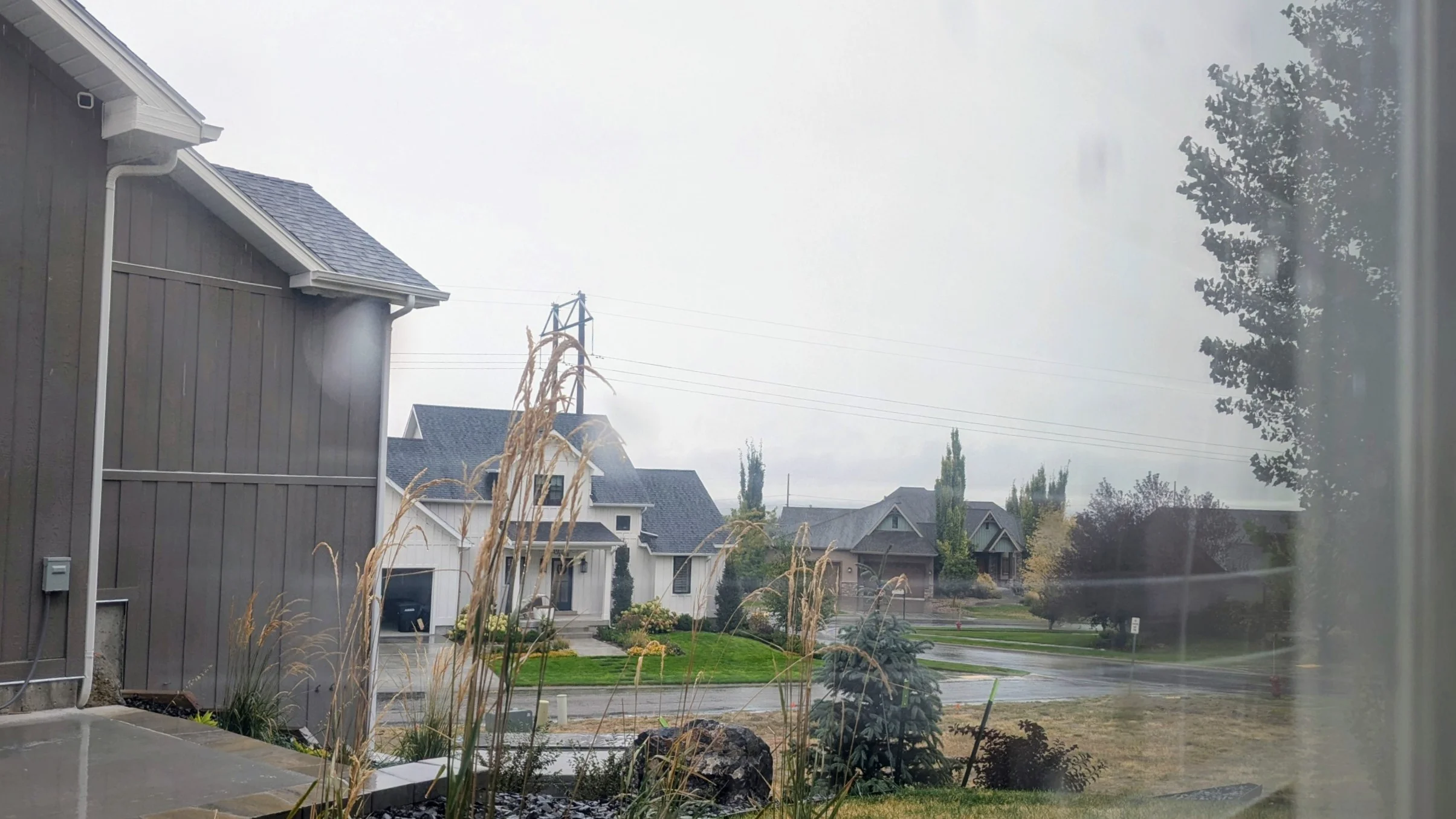

I don't know how far they can cause interference or noise so here's a photo taken from the window so you can see how far those power lines are. At that distance, can they still be the source of my issue?
Almost certainly not. The thing with interference is that it drops of VERY quickly with distance due to the inverse square law. double the distance and the interference drops to ¼! double again and it's a 1/16 of what it was. If the quality and volume of the hum changes as you spin through 360 degrees, then you can track it down reasonably simply. move to one side of the room and do the spin with the guitar on a strap. There should be two peaks. one will be at 90 degrees to the neck in front and the same behind. find the maximum interference direction, and the source is on that bearing. Then go as far as you can away from that position and repeat. The direction should be different. but the source is on the new bearing - where the two cross is the source. This will fail if the interference is being propagated by your house wiring. However, it can help you find things like wall wart type power supplies misbehaving, or individual bits of kit if they are causing it.
I have pylons close to my house like that.
They have never given a problem.
Just unplug or switch things off. No current - no transmission.

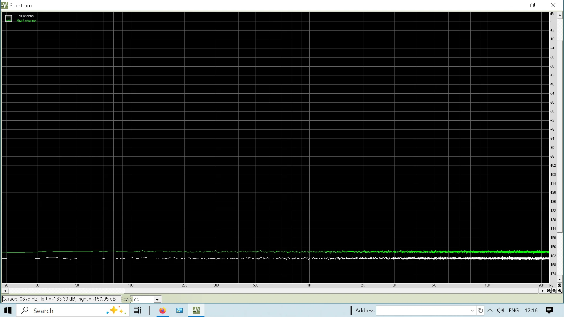

Yes, bang off the main breaker(s) and run laptop on battery. The OP's noise has two features that tell a story?
Firstly the main (huge!) peak at 60Hz. That can only come from direct mains 'injection' almost certainly 'magnetic' and likely a transformer. Equipment hum will be 120Hz (100Hz EU) because nobody uses half wave rectification these days!
The second observation is the EXTREME DIRTINESS of the rest of the spectrum! That suggests to me a poorly designed or badly shielded Switch Mode PSU. OR! The UMC is noisy. Try a recording with gain at minimum and ideally input shorted. I shall do the same for my KA6 in a mo'.
That was done with the inputs switched to 'Line/insrt' and at minimum gain i.e. the converter noise plus the line preamp residual.
Purty clean innit?
