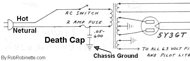

I remember back in the late 60s/early 70s when there were no grounded plugs, just two wire nonpolarized plugs. Amps had capacitors on the power lines. These later were called "death caps" because if they failed, they could put mains level voltage on the ground line.
Many amps had a polarity switch, which would swap the power and ground lines. If your amp and your PA had them switched in opposite directions, and your mouth hit your mic while you held your guitar it could flat out light you up! It was worse than putting a fresh 9 volt battery to your tongue. My Guild Thunderbird amp has both a polarity switch and a "hum balance" which has a pot and capacitor. I learned to walk up to my mic and tap it with my finger.

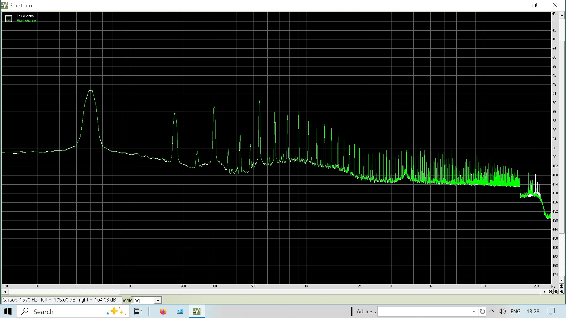

Here's what I did first with the attached file.
The first 20 seconds (about -70dB):
Volume pot on guitar all the way down
Guitar channel volume also all the way down

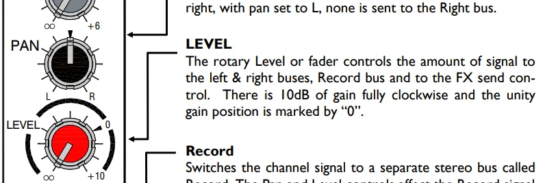

The second 20 seconds (about -38dB):
Guitar channel volume turned up to unity "0" position as shown below
So the noise is present even when the volume pot is turned all the way down, and gets louder when I increase the volume on the guitar channel of the mixer.
What does this mean?
Geeez! That's nasty! I would not be at all surprised if that is due to the overhead lines. I suspect there is also some electro-staic pickup as well judging by the higher harmonics. Do you know the line voltage?
