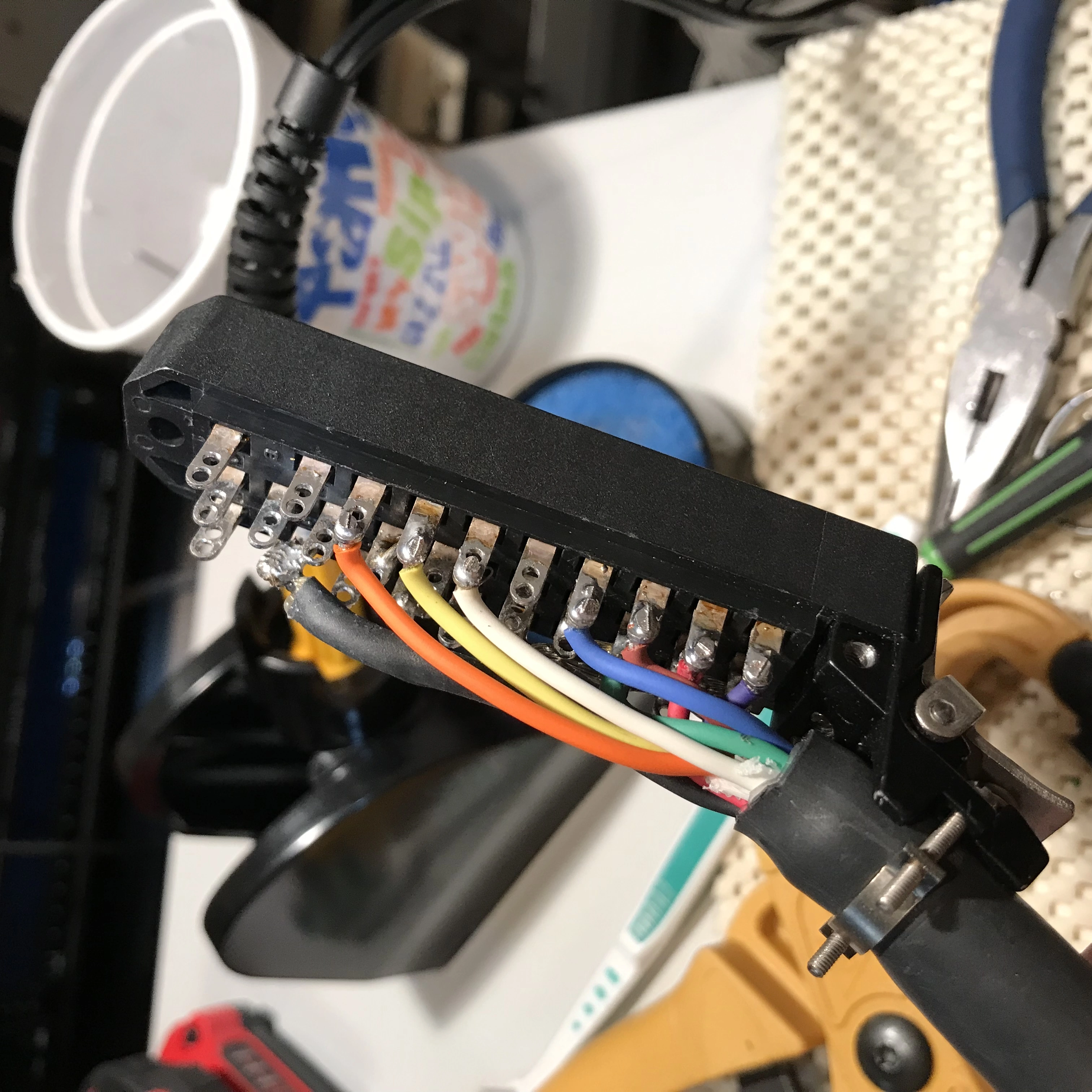

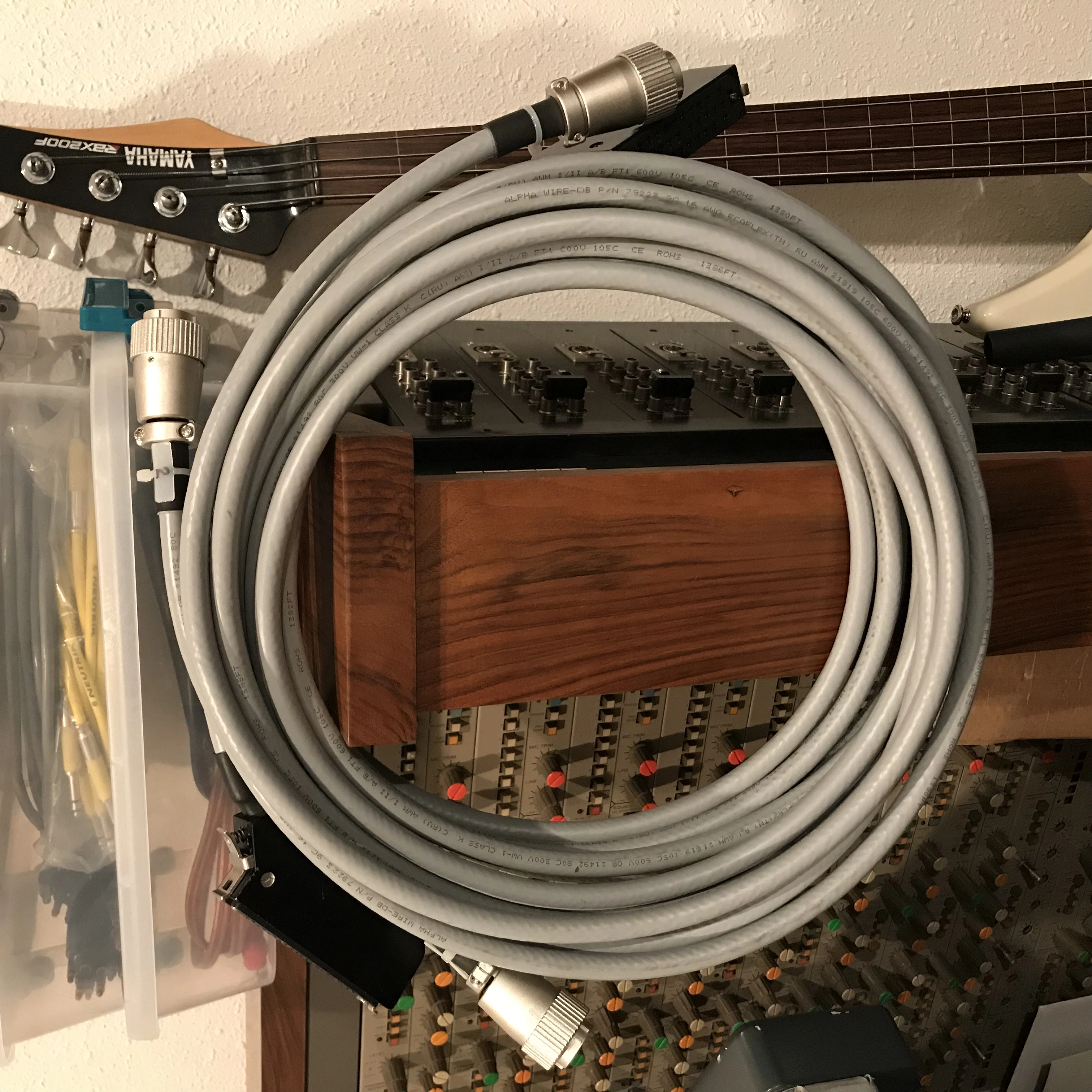

This one was easier since it was only interfacing one power supply:
All done:
I will say it was extremely satisfying to, for the first time, thread in the locking rings on the power supply connectors and latch the frame connectors in place…safe and secure.

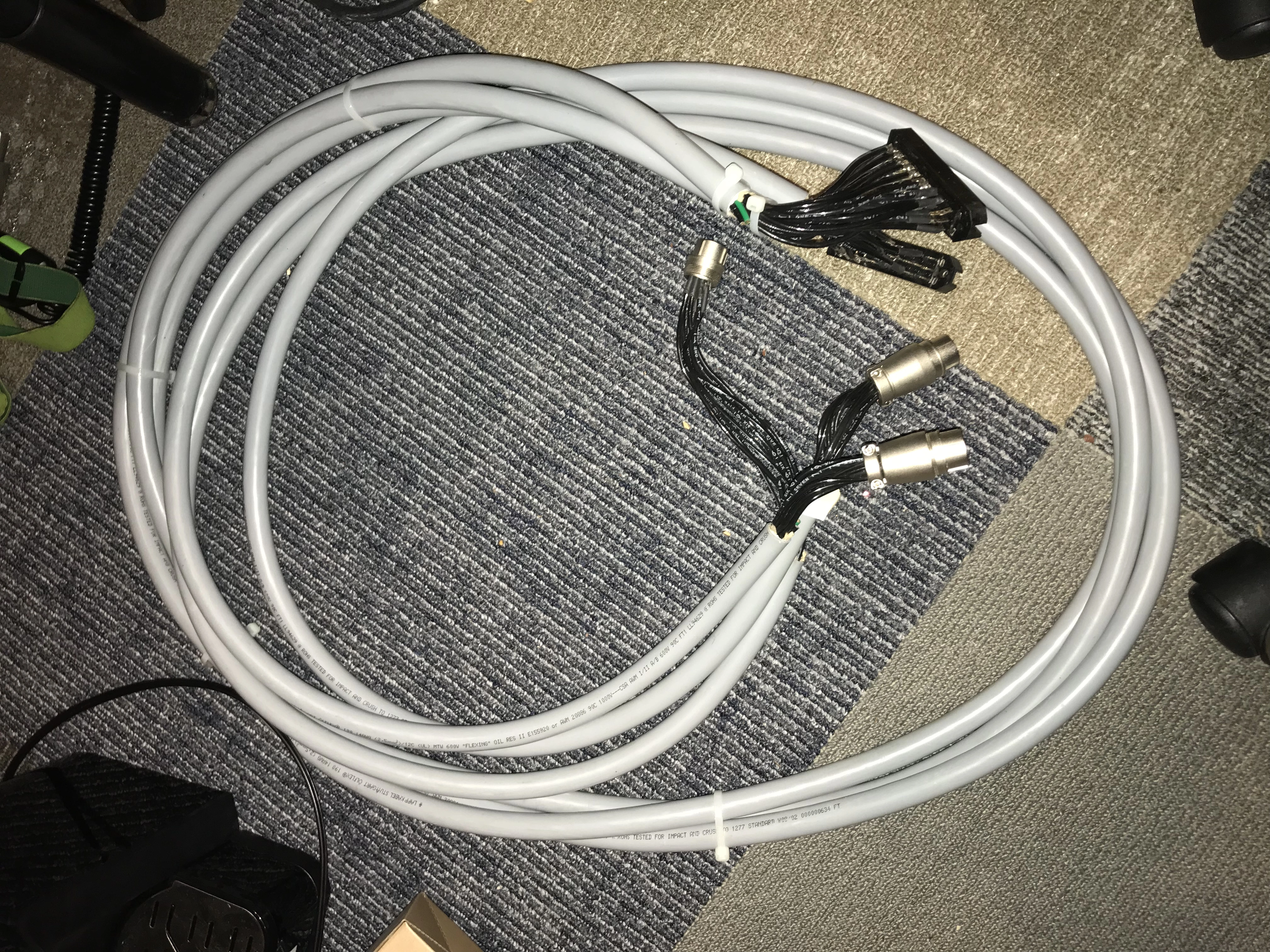

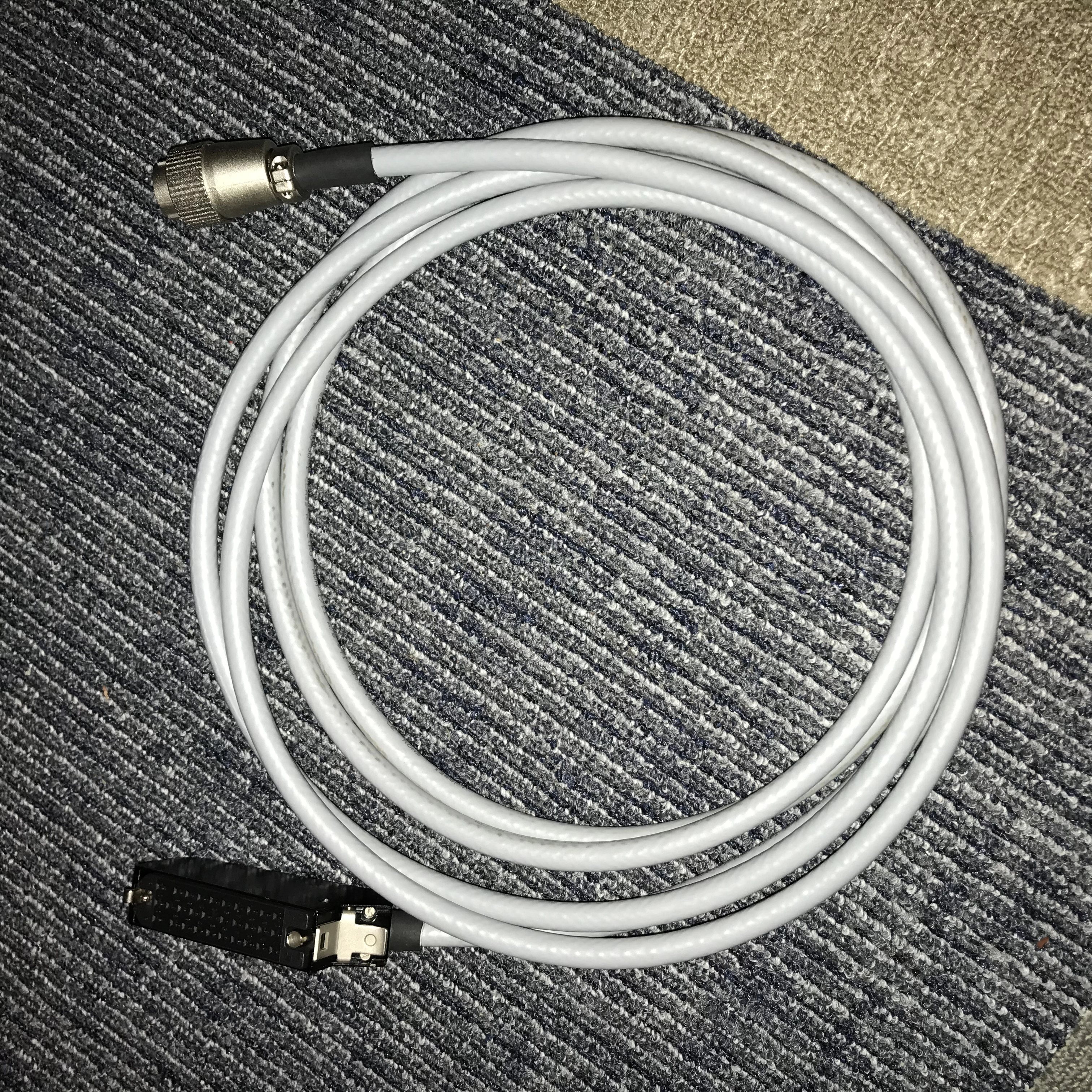

By comparison here is the set of non-factory umbilicals that came with the console…which have now long since been scavenged and the rest disposed of. Good riddance:
