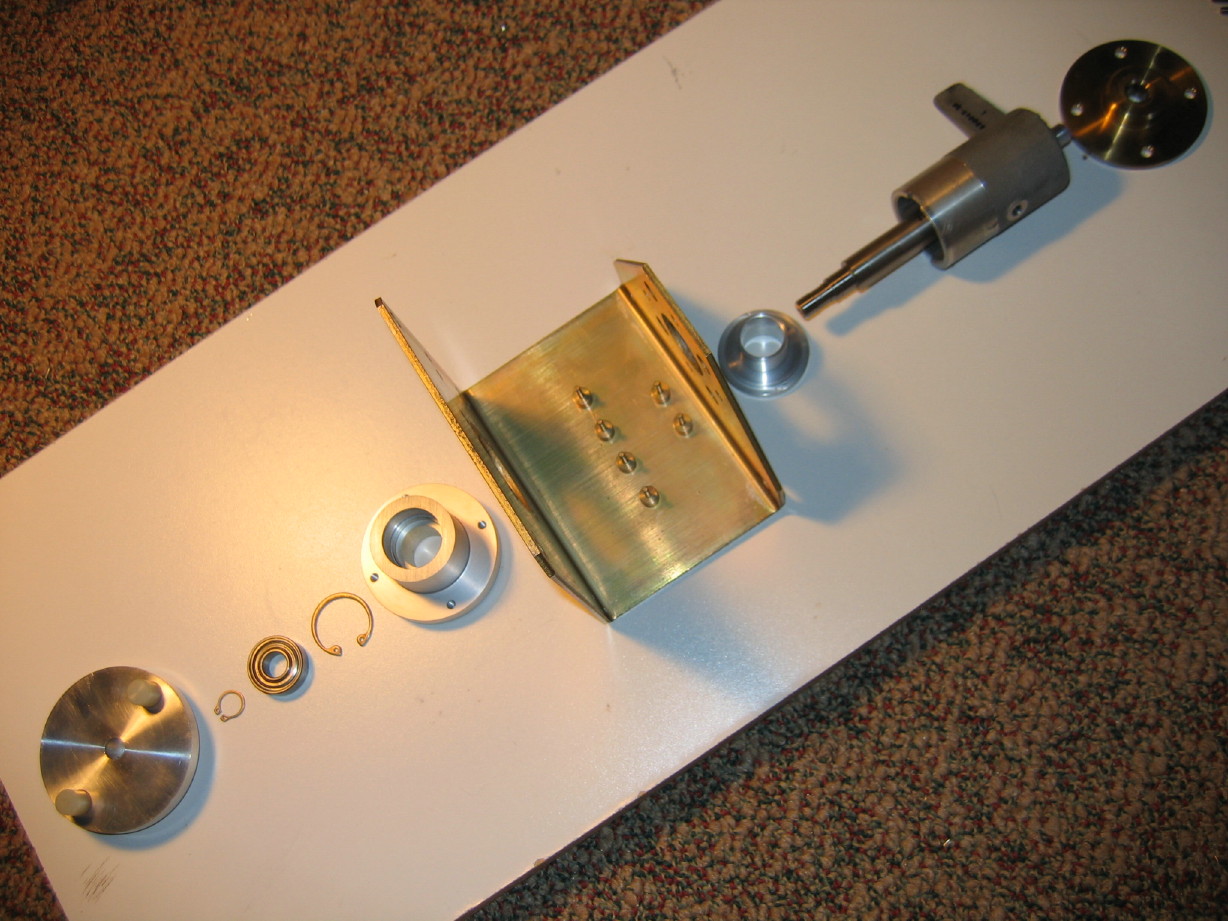

Once that comes back I'll confirm the bearing type and get some new ones ordered along with a new top bearing for the motion sensor actuator assembly. And by the way here is an "exploded view" of that assembly after having disassembled it:

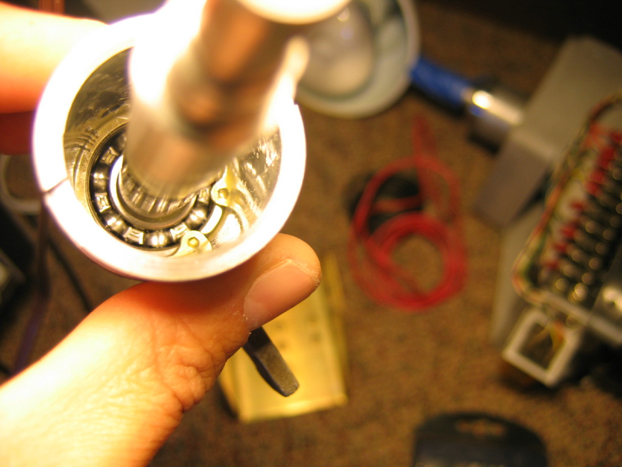

And here's the tail bearing deep down inside the actuator housing...the one I ain't gonna mess with trying to remove...the one I STILL need to go get some mineral spirits to clean out:

Gotta go get some mineral spirits today to clean up the motion sensor actuator...it was too much a success putting the fluid in the flywheel to ignore putting the 10,000 centistoke fluid in the actuator...

Movin' along...
Well, Muck, over-engineered or not it is back together and works incredibly well...I'm impressed with how effective this mechanical device operates.
Motion sensor assembly repaired and reassembled

Here's the new nose bearing I had on-hand:
And the reassembled unit overall:
It...works...like...a...charm.
The 10,000 cs fluid in the actuator was the ticket!
