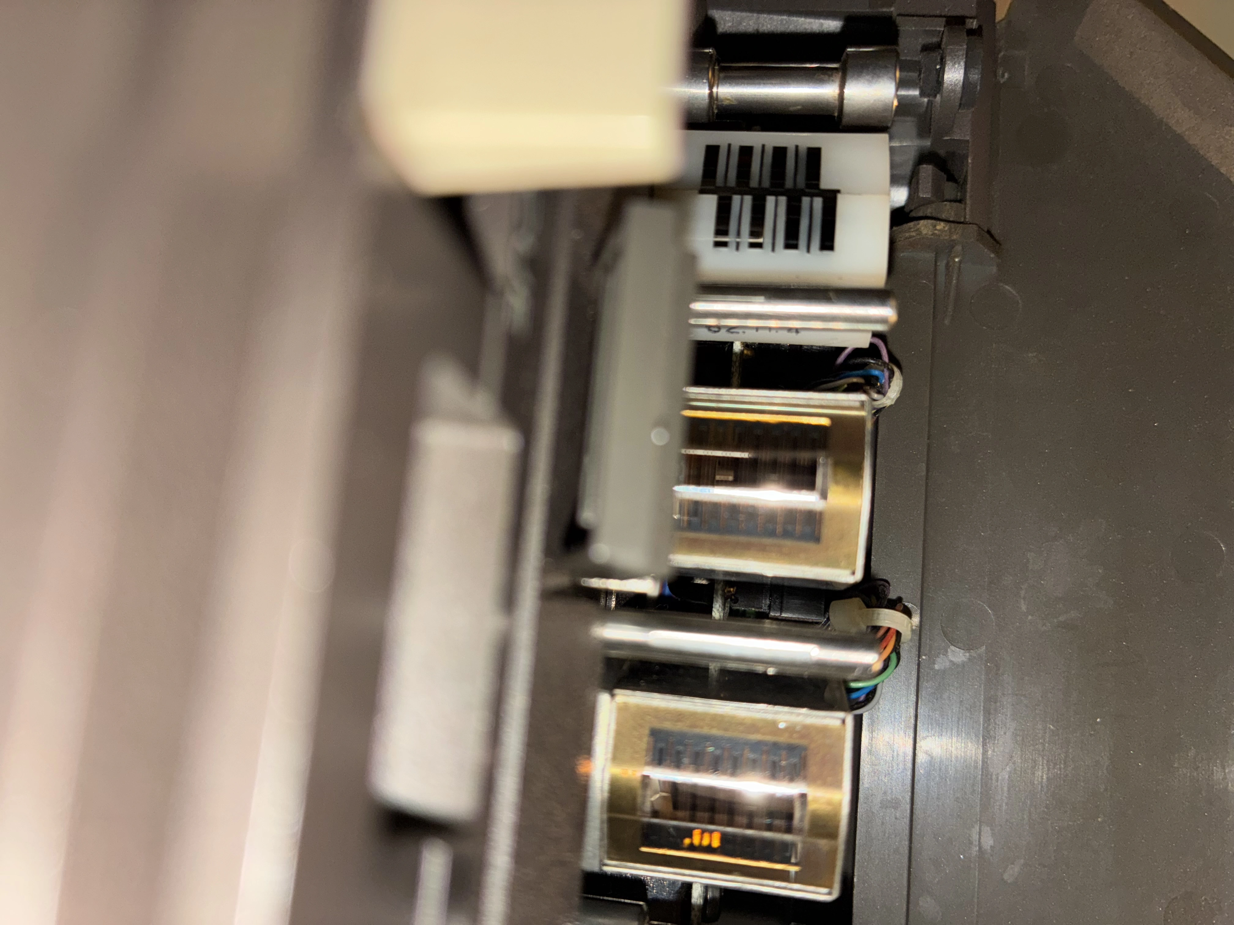

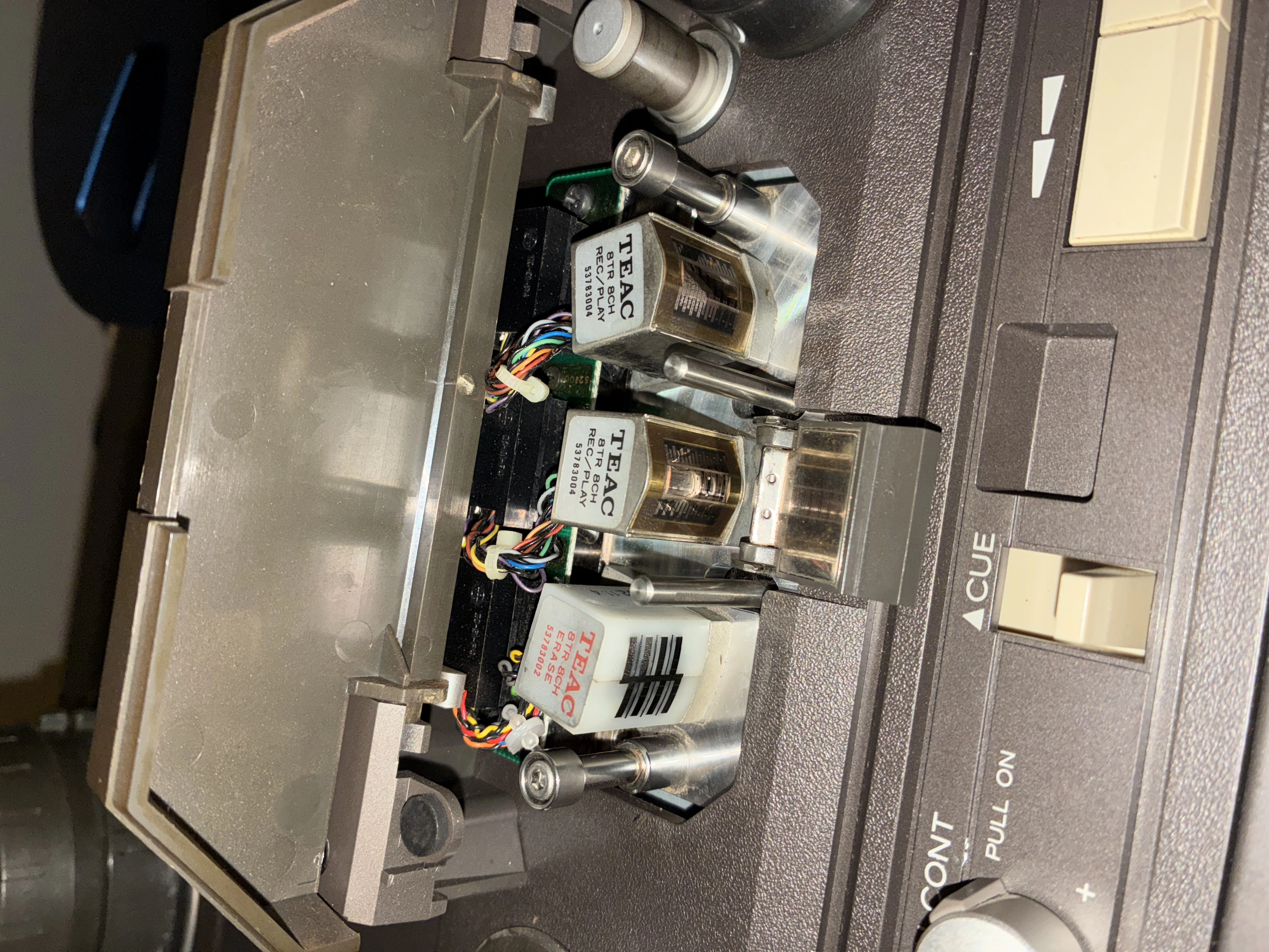

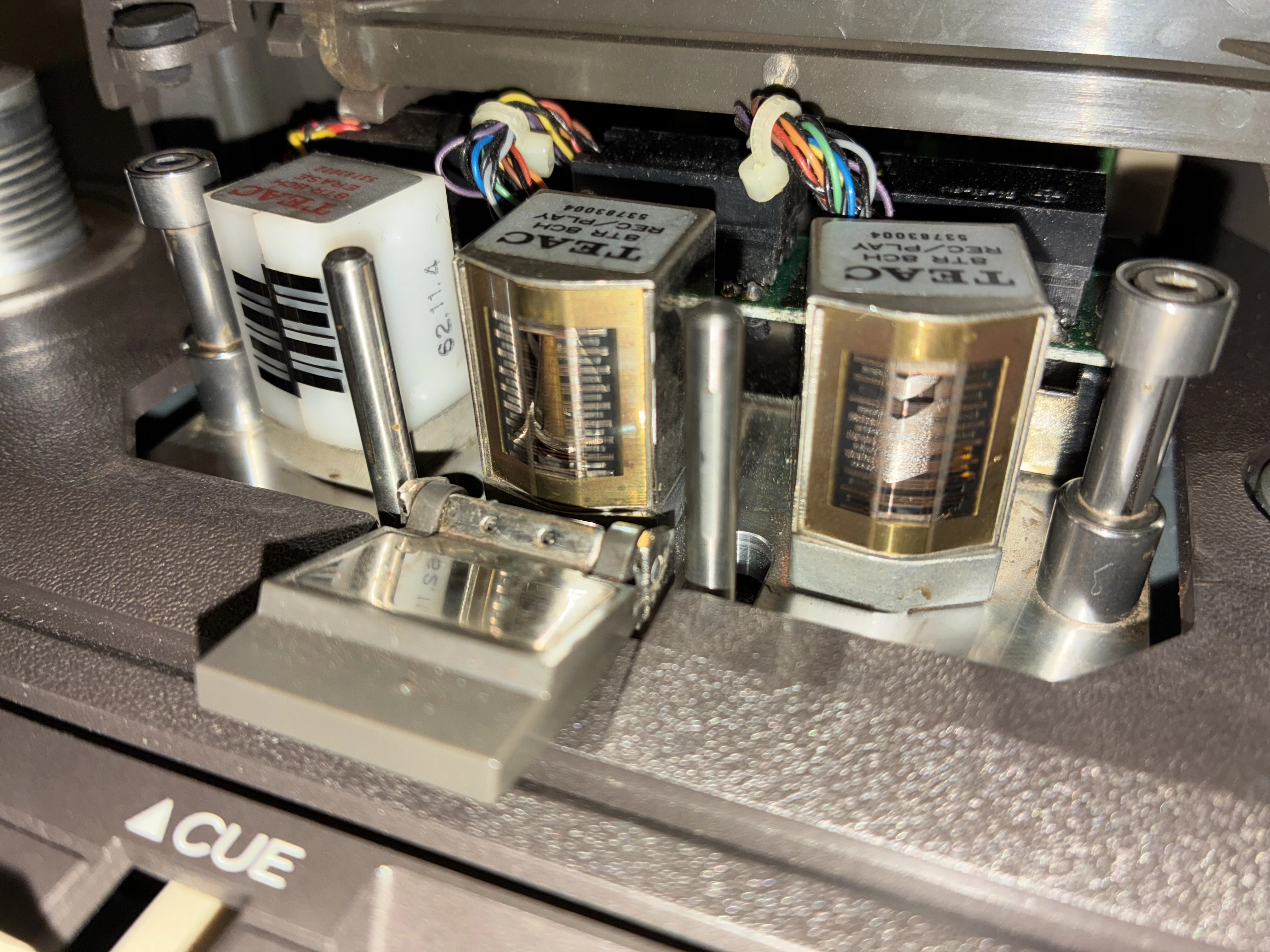

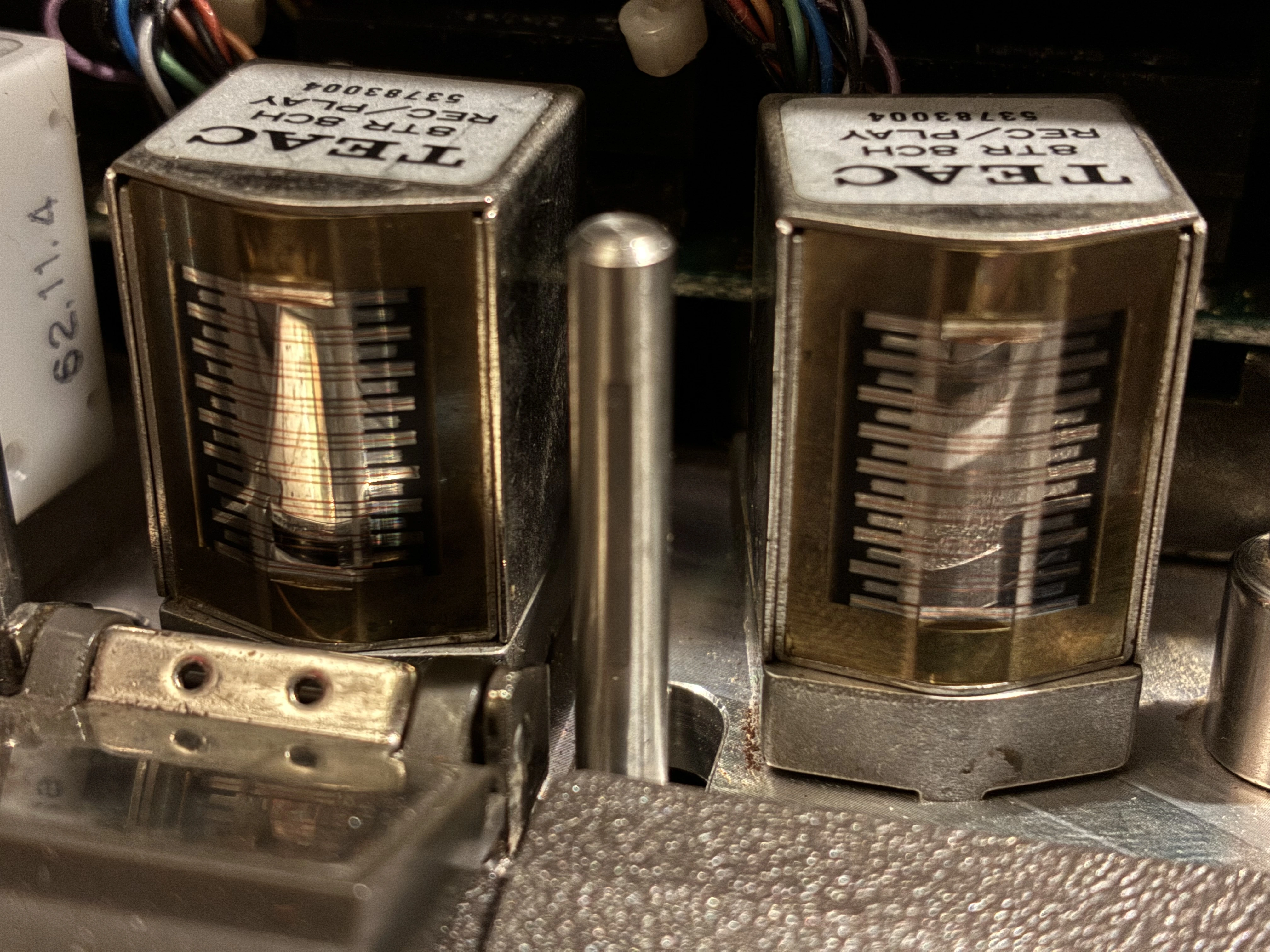

i’m not at home right now, but a month or so ago i took some detailed pictures of my tape heads. unfortunately i didn’t get a pic of the lifters, which i'm assuming should be examined from where they contact the bottom of the tape.

The lifters are right there in all three pics. One is between the erase and record heads and the other is between the record and reproduce heads. The pics are blurry but it looks like lower than average wear. There’s no way to know without actual evaluation of the heads by a professional, but if the lifters and heads are original to the machine and I was a betting man I’d say they’ve got plenty of life left.

Like I said earlier it’s a little hard to tell from the pics because the heads and other tape path components are out of focus, but I see a lighter than average wear pattern in the lifters from what I can tell.
