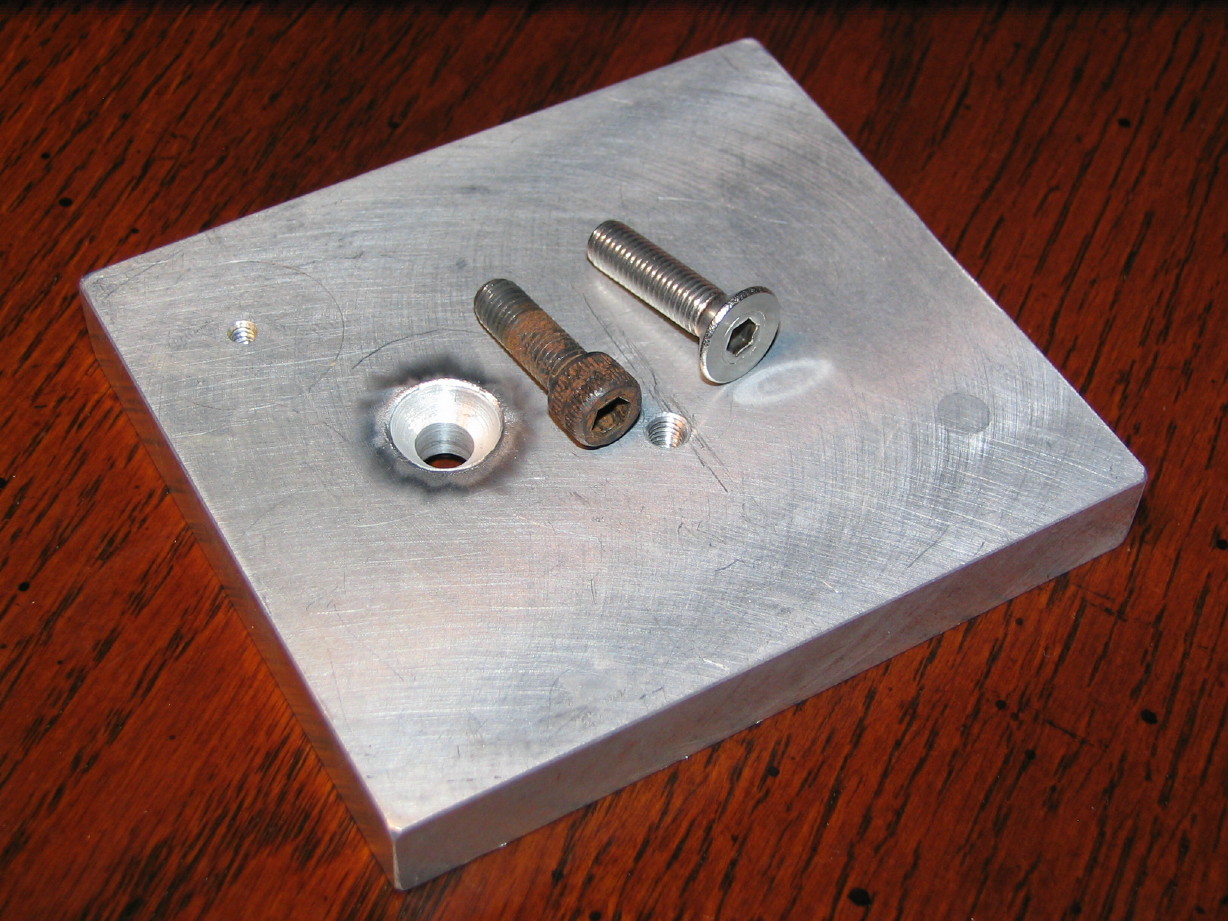

Here's that 1/4" flat-head machine screw I found that I needed to mount the 440-8 rotary guide...the stock screw for the 440-8 is on the left, the new one is on the right:
Had to get it in a flat-head type so that it would be relatively flush to the bottom of the guide mounting block...see?

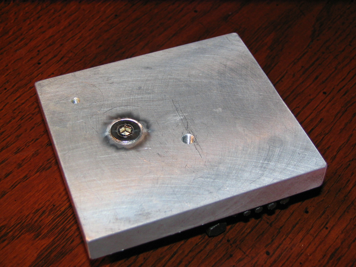

Flip it over, slide the custom shoulder washer over the new screw and it looks like this (with the guide base laying on its side to the right...you can see the 3 set screws there on the bottom to adjust the tilt of the guide if necessary...):

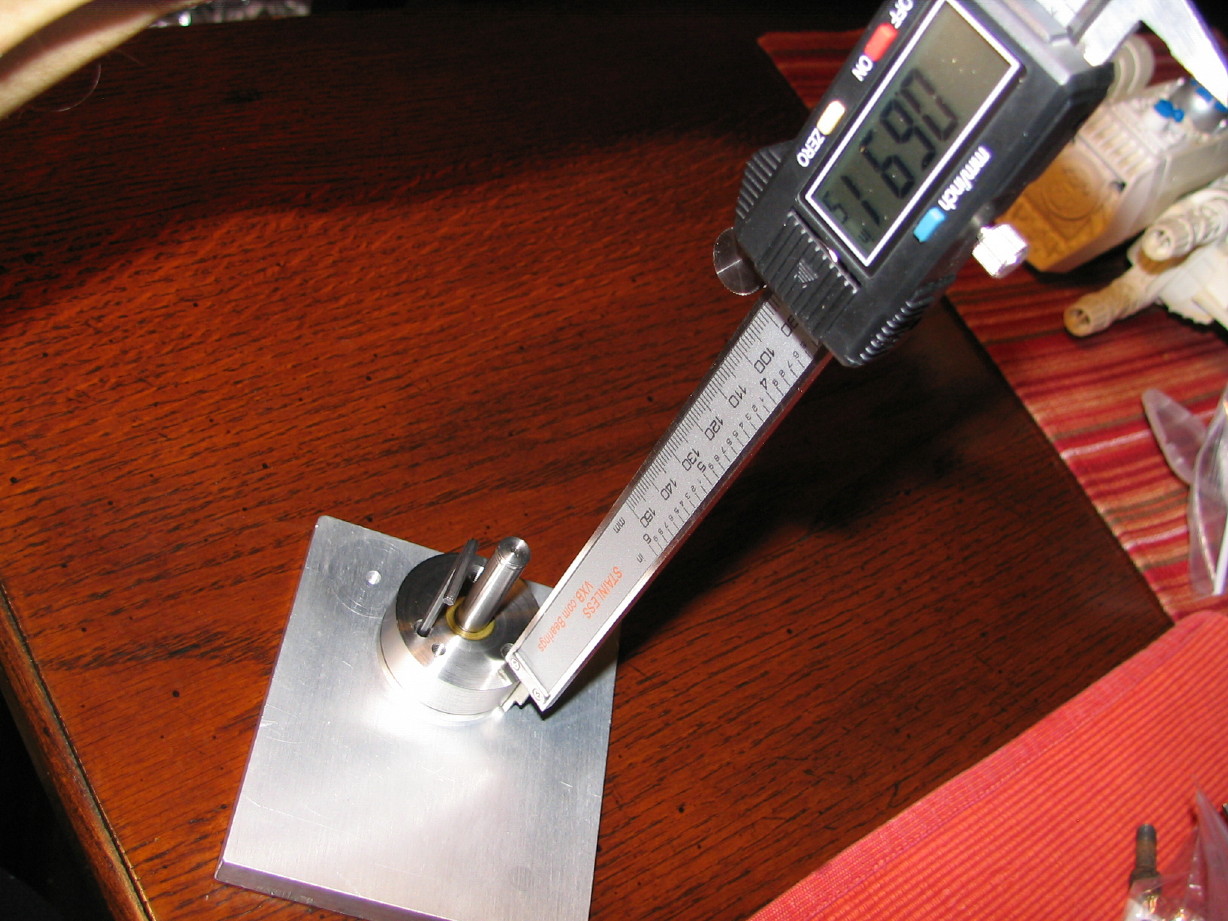

Here we are with the guide base secured and I'm measuring the height of the base over each set screw to get it level. I'll tweak it later if needed...:

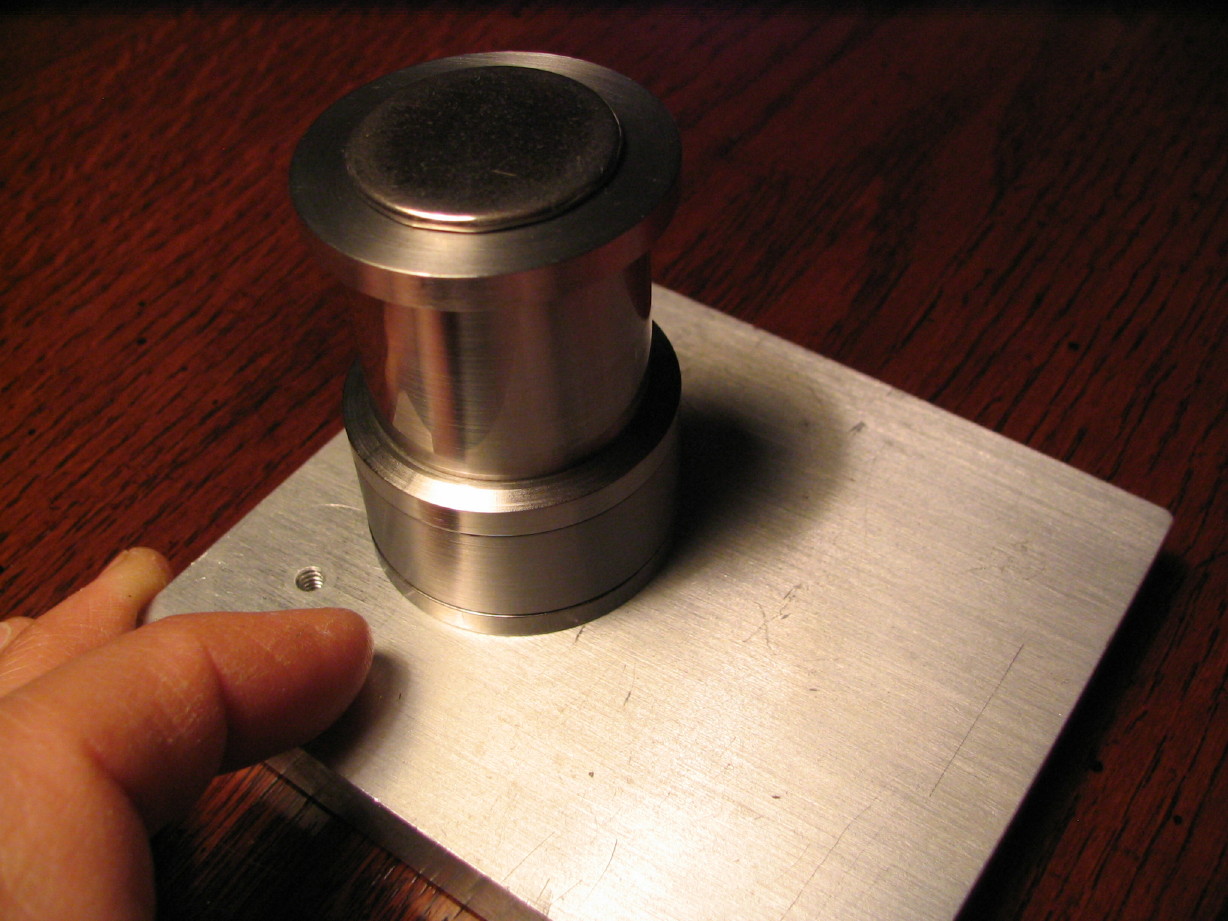

And here's the finished assembly along with my finger for size reference...shiny-chunky...(the guide...not my finger):
