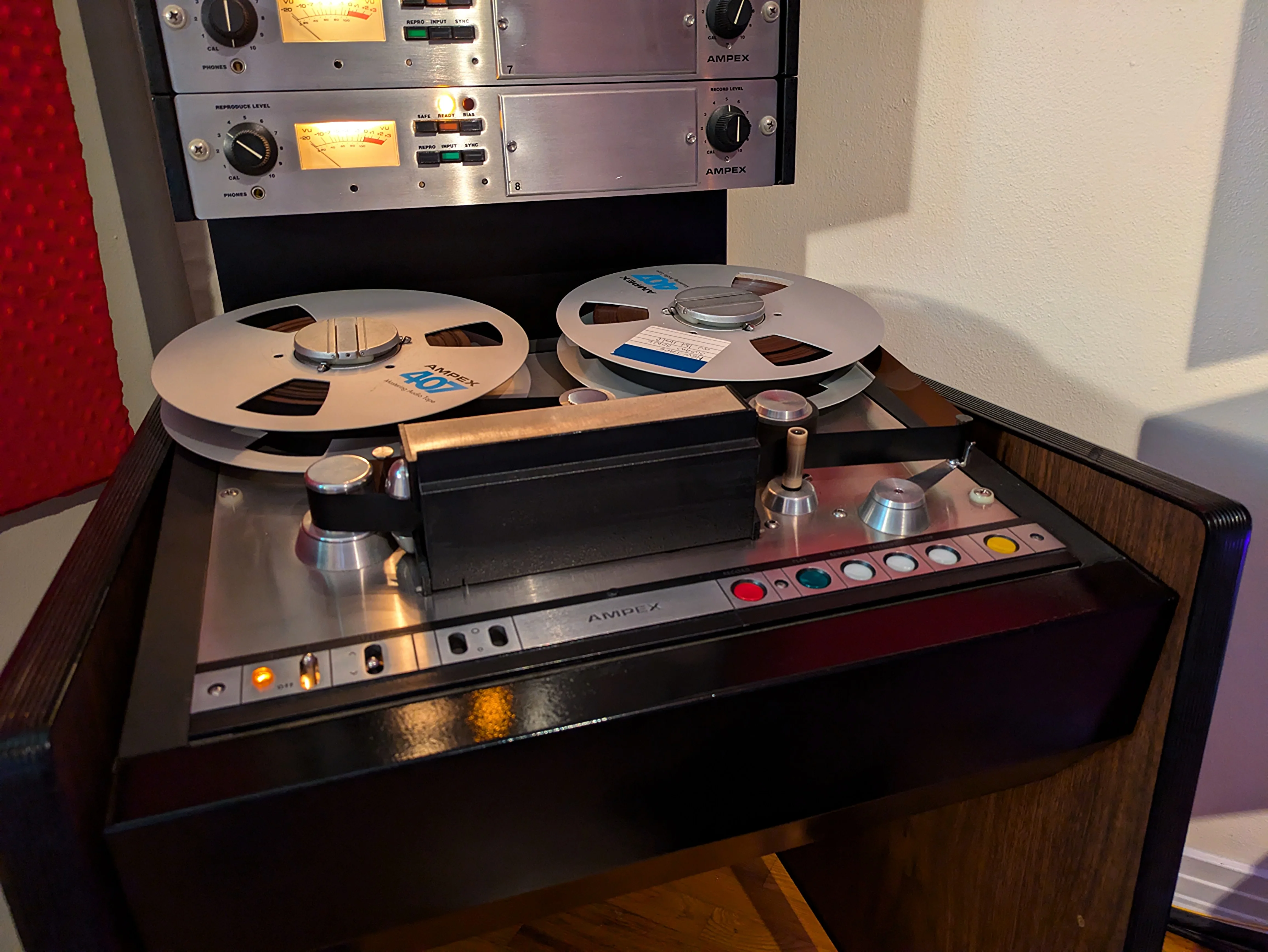

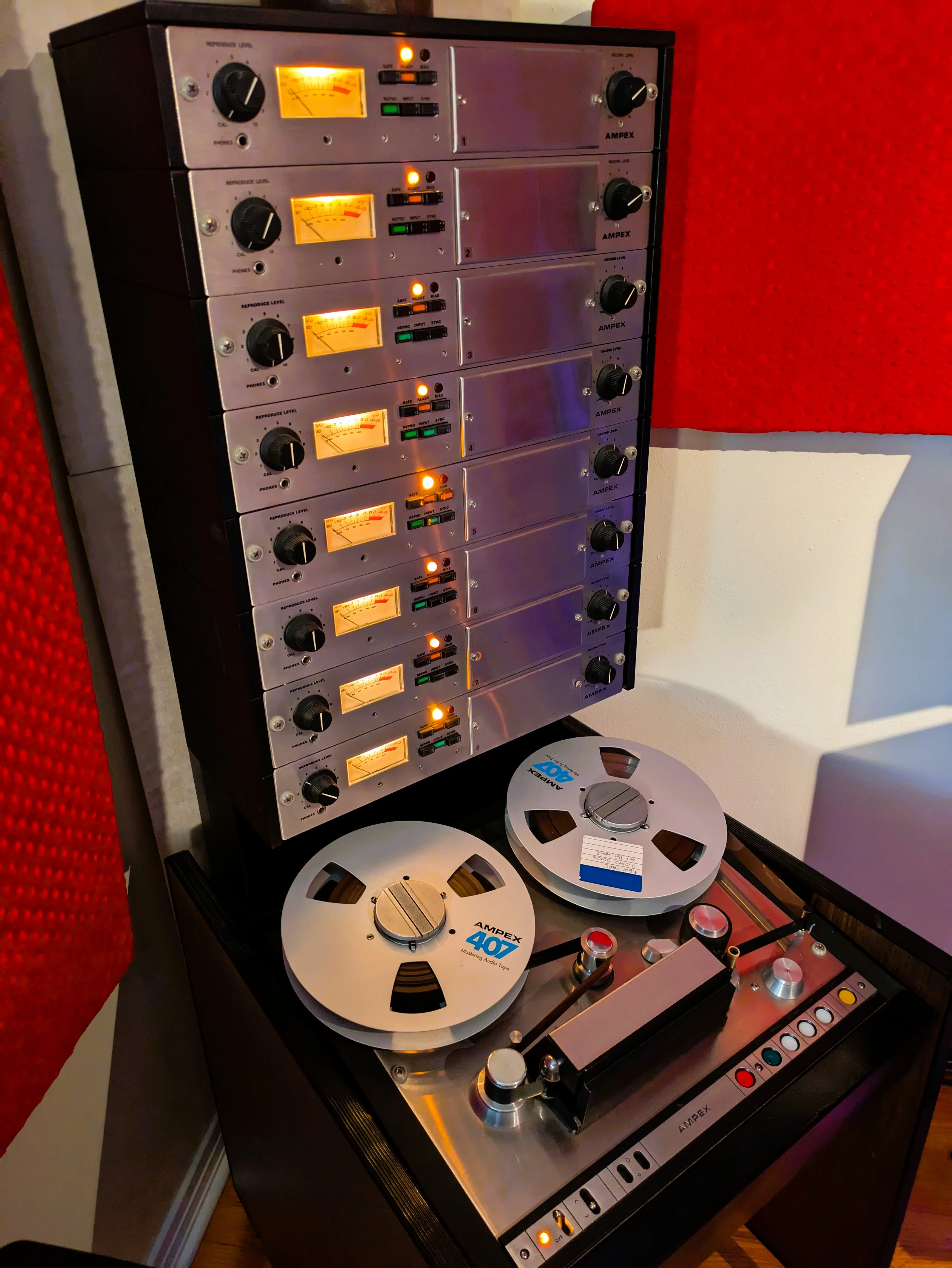

I have a 400c 1" 8trk I've restored, clean, touch ups, new electrolytic's in the channel cards, transport, power supply motor caps etc. I have the DC motor with this deck and it is my understanding the C models only came with AC capstan servo motors. So that is confusing. My question is on the roll around under the transport by the fan (left side) there is a factory sub chassis (steel yellow zinc plate) about 3x5x5" with a small transformer on the outside and one Cinch cable that comes out of the box and goes into the transport. The sub chassis has access pots you can adjust. Any ideas? Is that anything to do with the AC Servo Capstan? I can't find a part number or description in my 440c manual. I'll try and get a picture

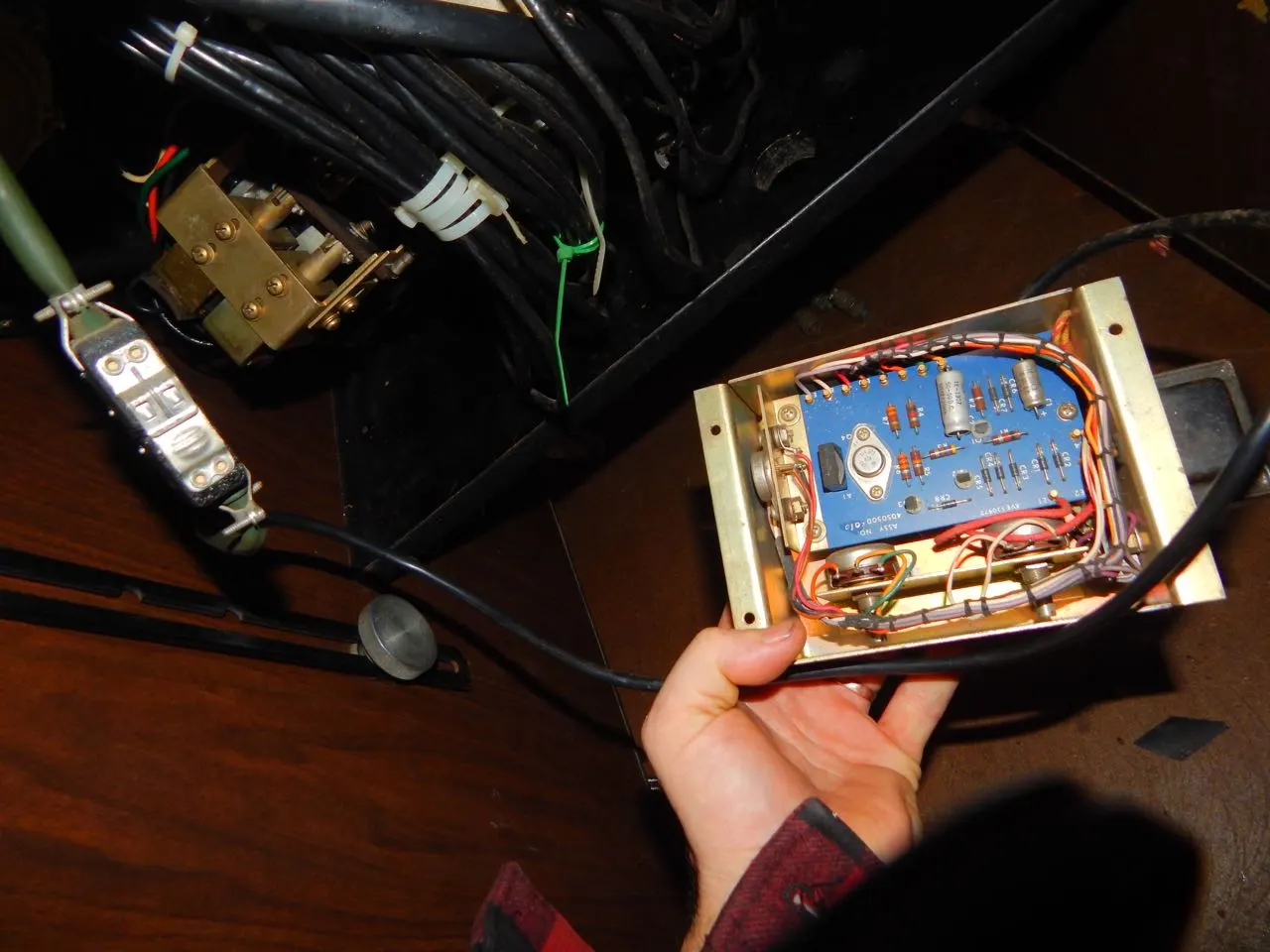

Hey Sweetbeats! Oh right, I get the two motors AC/DC mixed up. So the cable goes to the transport chassis though a small hole and grommet. Here is a picture of the underside of the box.
There are two Allen Bradley pots (the best back then) you can tweak. I never have. This deck has the AC hysteresis sync motor then with the fan blade and it has a porcelain sleeve for 30ips operation. The previous owner explained that the servo was removed and the porcelain sleeve (according to him it was one of the best sleeves) was put on the replacement motor.

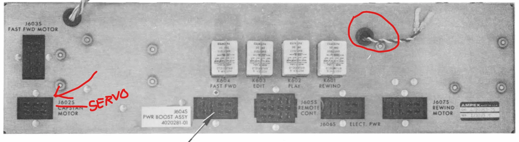

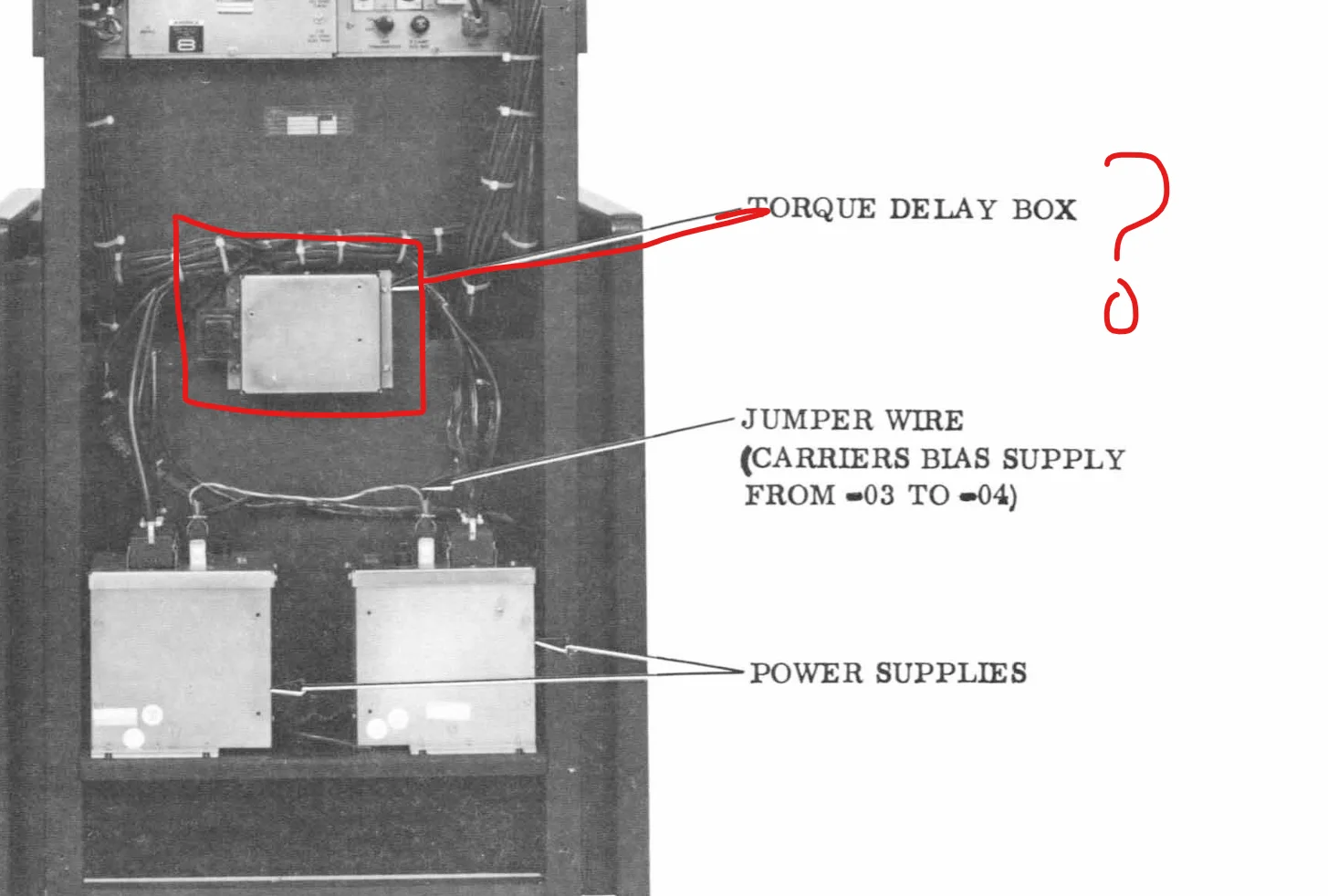

I have the 1981 Ampex 440C manual hard copy my understanding it was the last issue and I cant find any mention of this box. But this is a 440c 1"8trk and I cannot find the supplemental manual for the C only the B from 1969. Was there a C supplemental for the 1" 8trk?

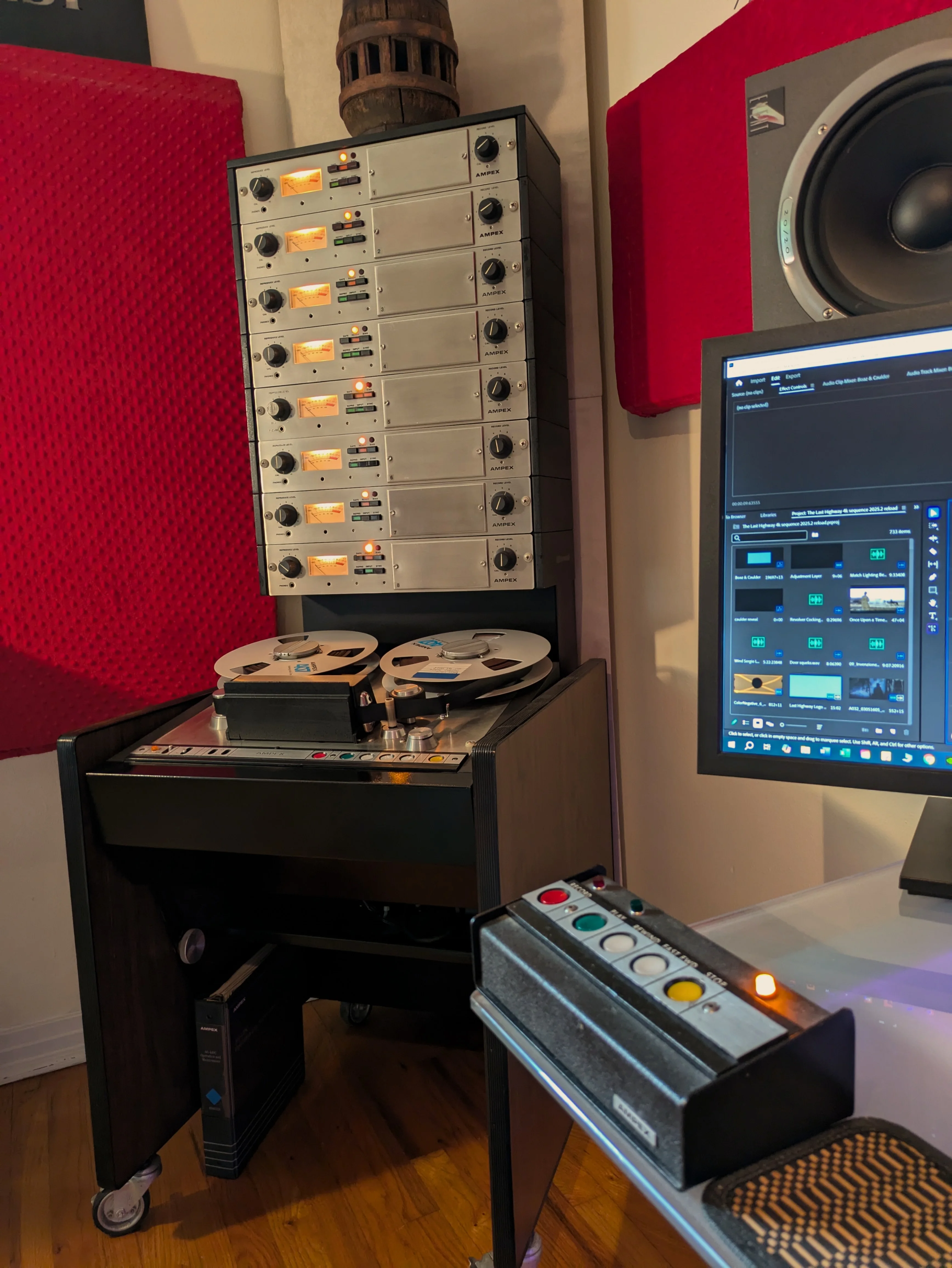

Deck after deep cleaning, paint touch ups etc. See the 1" 8trk B manual from 69. The box on the back looks exactly like mine from the grainy picture but mine is not mounted on the back and is factory mounted under the transport.
Next the wire with the cinch plug goes into the transport (see picture) chassis hole on right. And note the transport chassis on mine on J602S says Servo motor not capstan motor like the B supplemental manual. It does have the same 6 pin cinch females chassis mount plug.

the circuit board in my small sub-chassis box has the same part number in the supplemental manual 4050500 "torque delay card" . I think?? they just changed the location of the torque box on the C machine. I'd like to put the original Servo motor back in as this deck had one to start.

From the B 8trk manual:
"Modifications to the basic AG 440B machine to 8 track include the additional four channels, changes to the tape transport control box, the addition of a torque delay box, the addition of a power boost assembly, and an additional power supply. For improved ventilation, a fan has been installed below the tape transport. Following are the changes which have been made to the control box circuitry. (Refer to Figure 16, Dwg. No. 4840184, the revised tape transport wiring diagram. See also Figure 2, 3, and 4. ) 1. 2. 3. 4. 5. 6. Resistors R604 and R605 are now 35 ohms, 55 watts, variable to 10%. Line power fuses F601 and FG02 are now 5-amp Slo-BIo fuses. Receptacle J604S on the control box chassis, previously available as an input for a GO Hz amplifier, now receives the cable from the power boost assembly. The reel size takeup and rewind switches are not functional on the AG 440-8. The position of these switches is of no significance, since they are internally by-passed. Resistors R606 and RG08, the small reel takeup and supply tension adjustments, are not functional. Fixed resistor R610 has been added in series with R604 and R605. The Torque Delay box is mounted on the rear of the console and delays the torque to the supply motor until the tape is up to speed. (See Figure Cl 18)"

That box…from the blurry picture of the guts of the box I was able to read the p/n off the PCB and, looking in the manual above, I find that is the torque delay module. The AG-440 was never designed to handle 1” tape…none of it. It was a kludge. So there were things they needed to glom on to it to get it to work acceptably well as far as tape handling. In order for it not to take forever to reach proper speed in PLAY, the torque delay module effectuates a delay in the holdback tension of the supply reel motor, so the capstan drive and takeup tension aren’t working against that when you go from STOP to PLAY. There is also torque boost module that gives the takeup motor some extra juice at the same time…that’s the big box smack in the middle of the underside of the transport where the signal electronics power supply usually goes on a standard 1/4”~1/2” AG-440.

So its a torque box, mystery solved thank you!

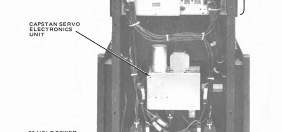

Aha, so this large box "servo box" I do not have on the back of the unit. That is missing. So beside the servo motor I must need this as well. I wonder where this plugged into. I will not refer to your 1974 manual deeper. I want to solve this mystery.
I'm also going to look close at the back of my deck and see any signs of this ever being mounted on it. If not then the story I heard (that it had a servo) when buying it may not be true.

Yes just took a look on the back of the unit, you can clearly see the faint outline of where the servo electronics unit was mounted, so they story I got was accurate, someone removed the servo and switched to the AC capstan with the sleeve, this would explain why it already had servo speed daughter cards. I'd like to put this unit back to what it was and the extra servo speed accuracy would be welcome. Do you have a servo electronics unit :P
I haven’t owned an AG-440 for about a decade and a half…I might have some random parts somewhere around here but certainly not a hen’s tooth complete servo motor setup. I wish you luck. The DC capstan didn’t necessarily provide better speed control. It provided the ability to interface primitive sync setups, which are truly not worth the effort, and it provided access to 4 transport speeds. It’s more complex and more difficult to repair. Also more rare. The original may have failed, driving the swap to the AC setup…much simpler, motor is much easier to rebuild, it locks to the AC power frequency, which is quite accurate…and you’ve already got the 15/30ips option with a nice porcelain sleeve. Ideal setup if you want access to the 30ips on an AG-440 and don’t otherwise need the DC setup, which you don’t. I’d leave it alone.
