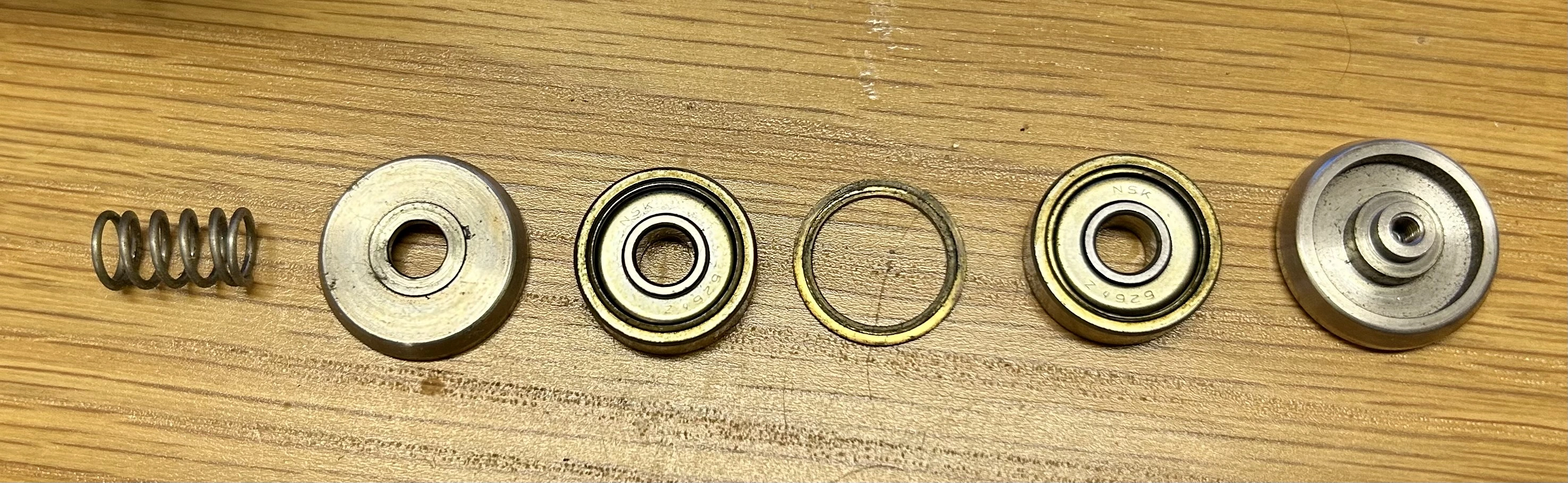

Second question is : on the 58, while transport functions seem to be working fine, I have a little trouble with the two tension arm rollers. According to the attached picture, is this the right way for them to be set up ? The washer on the pic is present in only one of the two tension rollers, I guess that's a problem. I'd like to know the specs of that washer so I can purchase another for the other roller, and also if it's supposed to be placed at the bottom of the assembly or at the top ? That's not shown in the manual. I'm not sure if the two rollers in the middle are supposed to move and roll freely along with the tape movement or if they're juste supposed to be "static" while the tape runs across them. In any case, the quick tests I've done showed that the tape rubs against the rollers but the rollers themselves don't move. Maybe I've screwed up the assembly of those rollers in a way I can't quite understand, but when I screw the top part the pressure of the spring on the bottom makes it impossible for the two middle rollers to move freely when tape is rolling.
That special washer goes in between the two roller bearings. Yes these are rolling guides…they use standard 626ZZ shielded bearings…two of them stacked to make the 1/2” rolling portion. The special double-shoulder brass or bronze washer, again, goes between the bearings. The top and bottom caps (and BTW your bottom cap on the guide in the foreground is upside-down, which is probably why it’s not working right…) are static. These are height-adjustable guides. All the info you need on how to adjust them is in the manual. See pics below of one of mine…But to adjust you loosen the socket-head cap screw on the top using a 1.5mm hex bit, and then turn the top cap clockwise to lower the guide, counter-clockwise to raise the guide, then lock it in place with the socket-head cap screw.

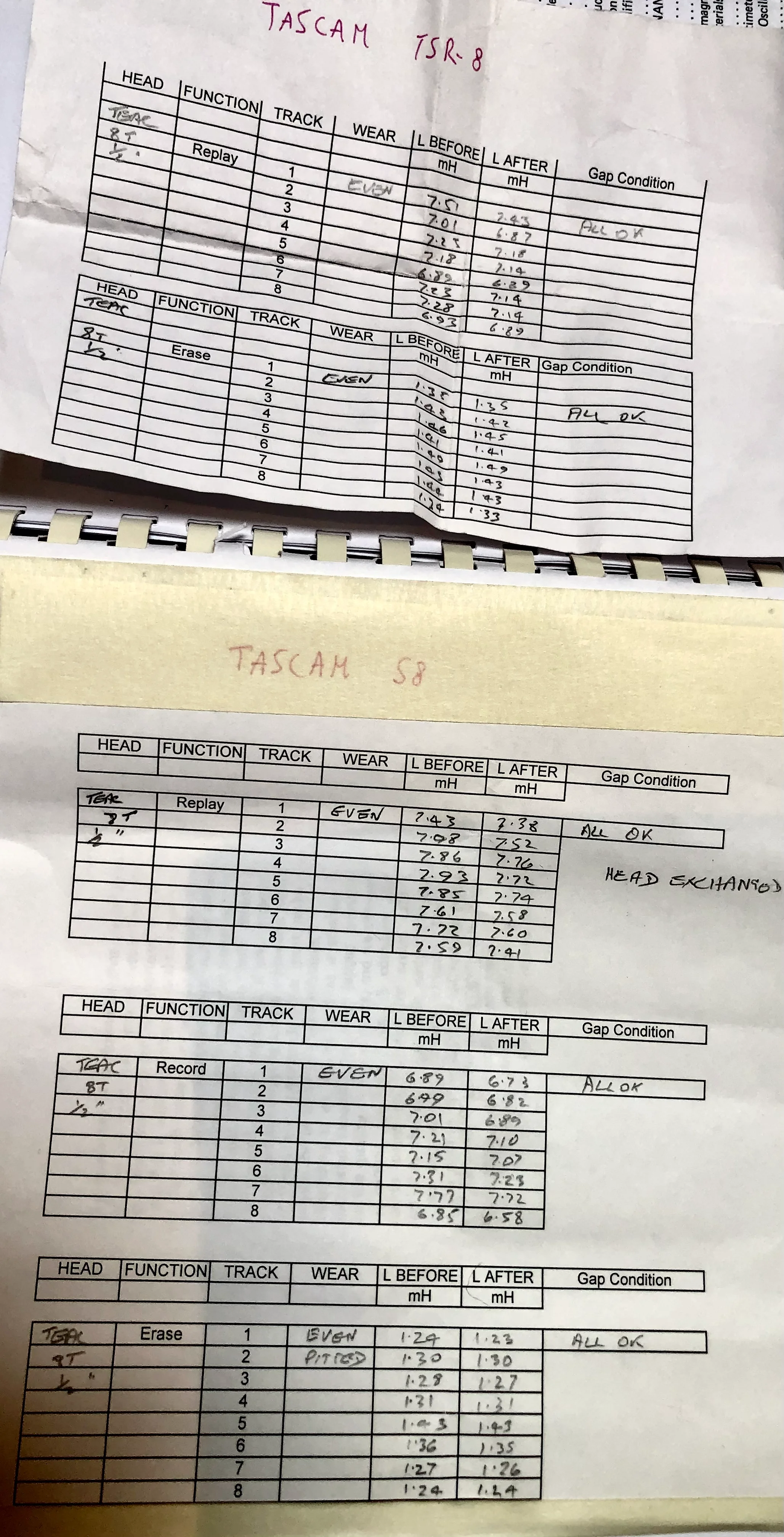

The main reason why I was thinking of setting up bias is because I sent both my TSR8 and 58 headstacks to Terry Summers to be relapped at the same time, and asked him to take the least worn heads and to install and align them on the 58 headstack, because that's going to be my main machine and I'm gonna use the TSR8 mainly to dump tracks for downmixes. So at least one of the TSR8 heads was installed on the 58 and vice versa.
So…wow…okay…so you had heads re-lapped and you swap-a-ronied heads around. So if you changed the R/P head on the TSR-8, yep…you’ll need to check the bias tuning and trap adjustments. And if that head from the TSR-8 went into the sync position on the 58, then same thing there. Is that the case?

3 : So…wow…okay…so you had heads re-lapped and you swap-a-ronied heads around. So if you changed the R/P head on the TSR-8, yep…you’ll need to check the bias tuning and trap adjustments. And if that head from the TSR-8 went into the sync position on the 58, then same thing there. Is that the case?

3 : Indeed, only the the Repro head of the 58 has been swapped with the Sync/Repro head of the TSR-8. All other heads on both machines have stayed where they were originally installed.

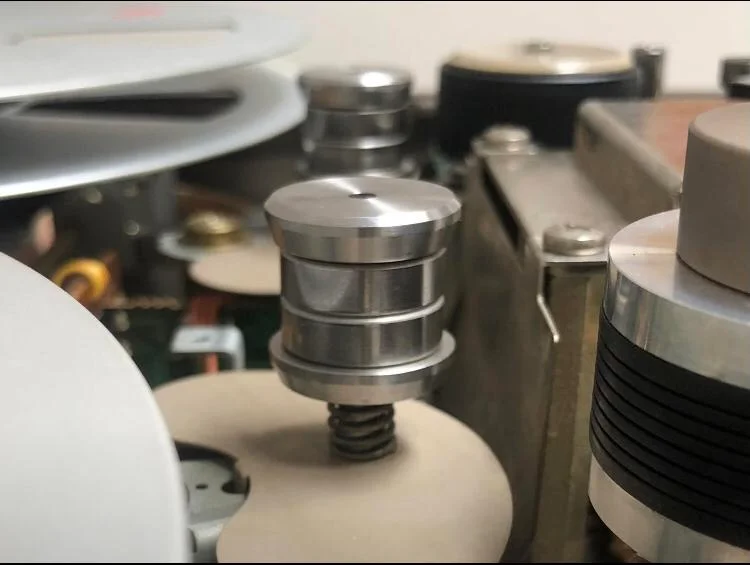

As far as the 58 tension roller go, I've installed the left tension roller exactly the way you had it laid out in your picture above and sure enough : the bottom part was upside down on my machine, pretty silly on my part sorry about that...
It's much better now but on the left side the two roller bearings with the washer in between them still don't roll as freely as the right tension roller bearings (which don't have that washer in the middle, either me or the previous owner must have misplaced it). Removing the middle washer on the left side gets it rolling much much smoothly, so I might settle for that, and I can finally get going with calibrating the 58 !

Regarding the tension roller…no, no, no. The washer is not optional. And if it’s not rolling as smoothly with the washer in place then either the washer is misaligned (the shoulder on each side of the washer should nest inside the outer race of each respective bearing, essentially linking the two bearings together) or you might need new bearings. They are 626ZZ bearings. Do not go cheap…get proper Nachi, NSK, SKF bearings or the like. But the reason you can’t exclude the washer is this: the spacing between the upper and lower caps with the bearings and center washer is about 13.1mm. The spacing *without* the washer is about 12.5mm. The NAB standard width of 1/2” tape is 12.7mm. If you exclude the washer the tape will not fit between the upper and lower caps, and will curl at one or both edges. This is not an option.
Got it !! I'll try to swap around the 4 roller bearings to see if one combination works better than the other. But at the very least I'll need to find a second washer with the correct specs, problem is I can't really measure the washer dimensions accurately (especially the "depth", for lack of a better term).

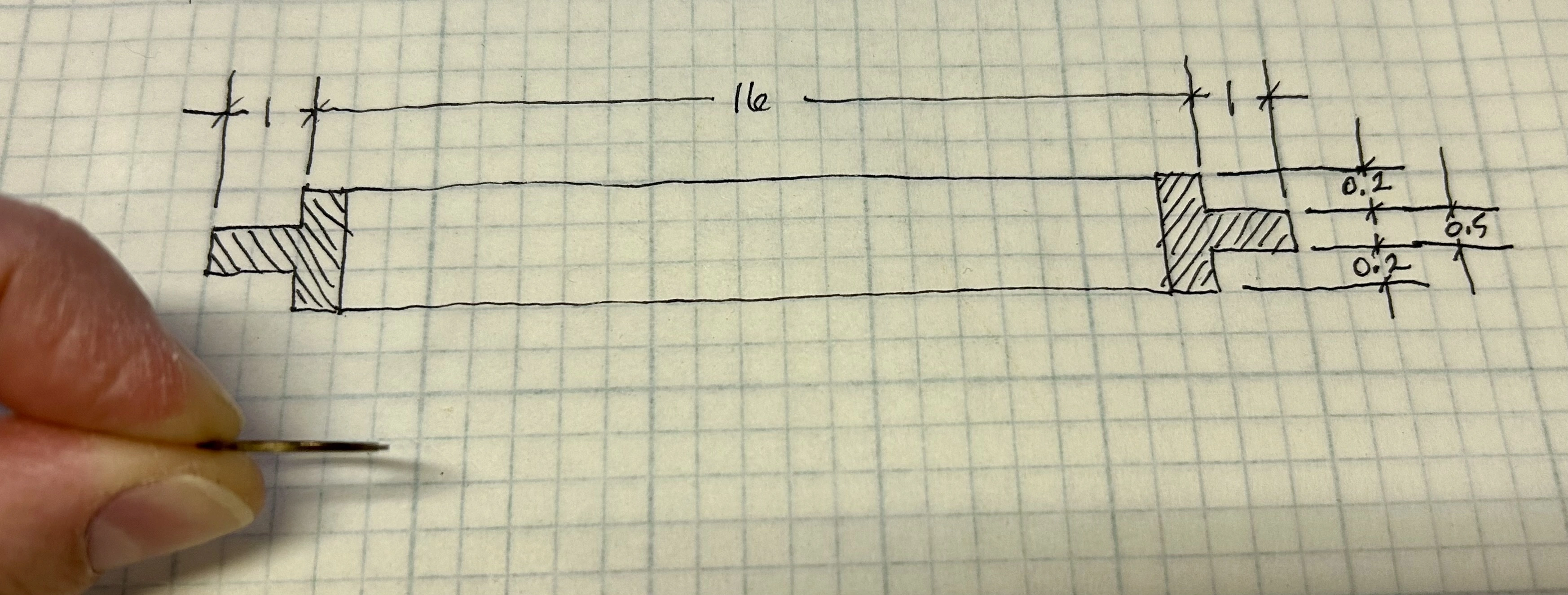

Here is a cross-section i drew up of the washer…it is not to scale. Dimensions are in millimeters:
I believe the material is brass. It is a precision part.
I’m reasonably confident you’re not going to find this off-the-shelf…i suspect this was custom made for or by Teac.
The other alternative is to find some precision shim washers with an ID of 6mm, OD no greater than maybe 12mm, and 0.5mm thick…these are precision parts and can usually be found in stainless steel and brass…and if you can’t find 0.5mm thick maybe you can find something that adds up to 0.5mm, like stacking five 0.1mm washers. These would go in between the bearings. This wouldn’t be as ideal as the factory part because the outer races would not be coupled, but it likely has no impact…regardless, I’d put the modified roller on the takeup side.
Wow thanks so much, that's gonna help a lot. I'm sure I'm gonna find that missing shim washer by accident in a couple of years but yeah I'll need a replacement in the meantime. I found a couple of places online that sell 06 x 12 x .5 steel washers for nothing, however I'm having a hard time finding brass washers, is that critical ? https://www.bricovis.fr/produit-ron...88-epaisseur-0-5-roncal98805/#RONCAL06/12/0.5
I also might have to go to a local machine shop for another matter (a vintage guitar bridge cover), I could maybe ask them if they would be able to make that particular shim washer from scratch ?
The brass is not critical…steel is fine, but I was talking about stainless steel…the one you linked is raw steel if I’m reading it right (or if my browser is translating correctly), so you’ll want to put a light coating of oil on it to prevent oxidation. Otherwise that would work.
Your local machine shop may or pay not be able to make a copy of the factory part, which is not a shim washer but a shoulder washer. It might take specific equipment like a screw machine to make that part, and not every machine shop has one because it’s typically in a shop that specializes in making fasteners that has one of those, but you can always bring the one you have in and ask…I’d bring it in because they’d be able to more accurately measure it, and look at it and right away tell you if they can do it.

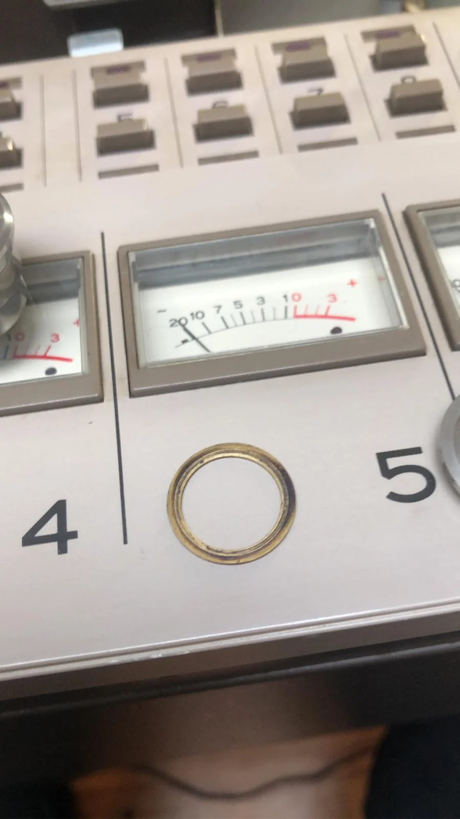

Hello !
I managed to find the missing shoulder washer and installed it, and then I finally went to work on calibrating the 58 ! It's crazy how much faster it went compared to the TSR-8, that was a relief ! Visual check of the tape path was OK, no curling on the edges of the tape. But I guess I'm still gonna get in touch with the machine shop to try and have a batch of these made, just in case.
