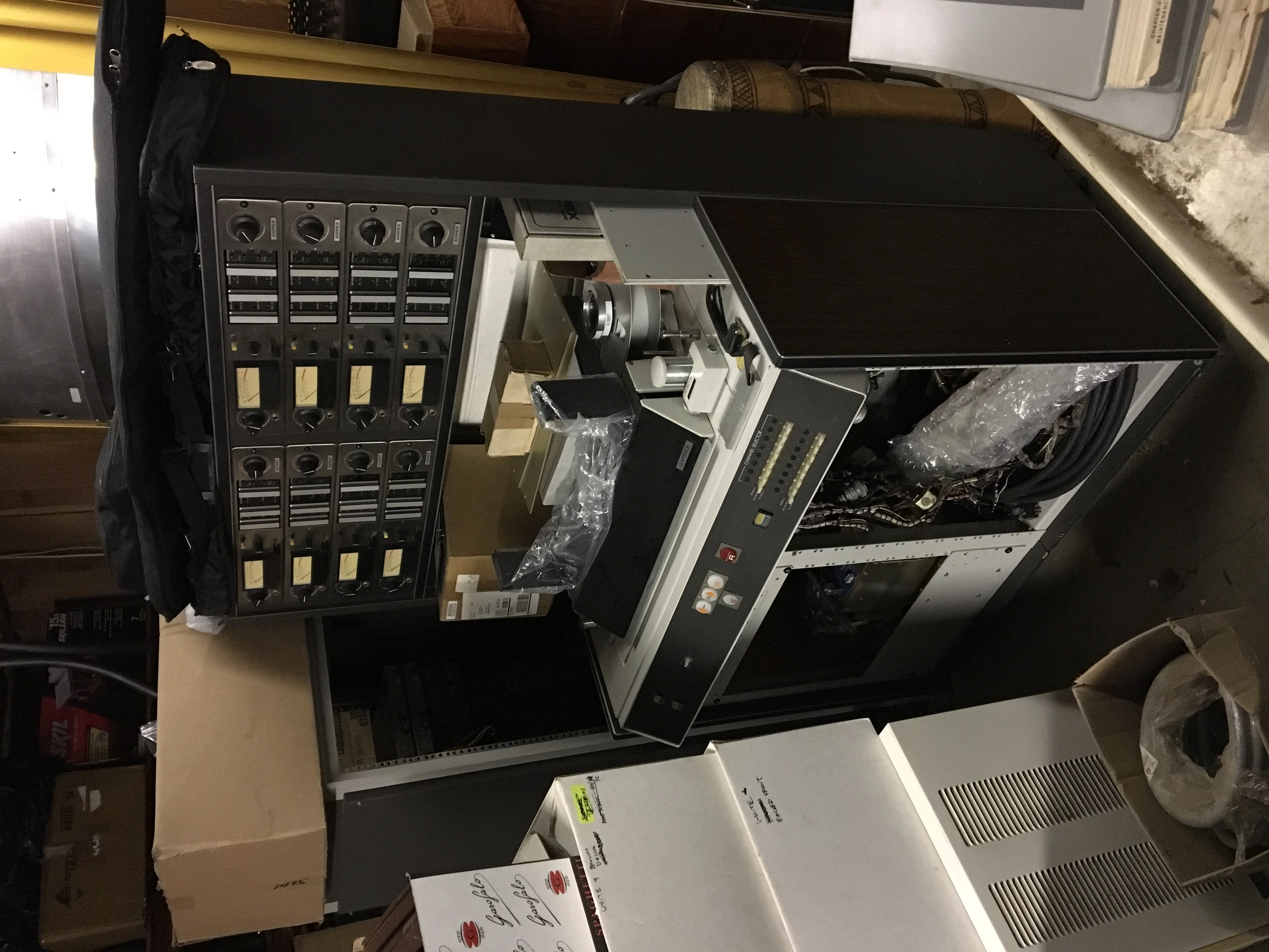

LOL "Im not interested in offers" but selected to have a make an offer button. But, I agree that price is insane. That money would net you a Studer 24 track.
Maybe seller wants you to offer to make an offer?
Looking closer at that transport control escutcheon, I'm pretty certain that is actually a piece of MDF that has been milled out for the buttons...

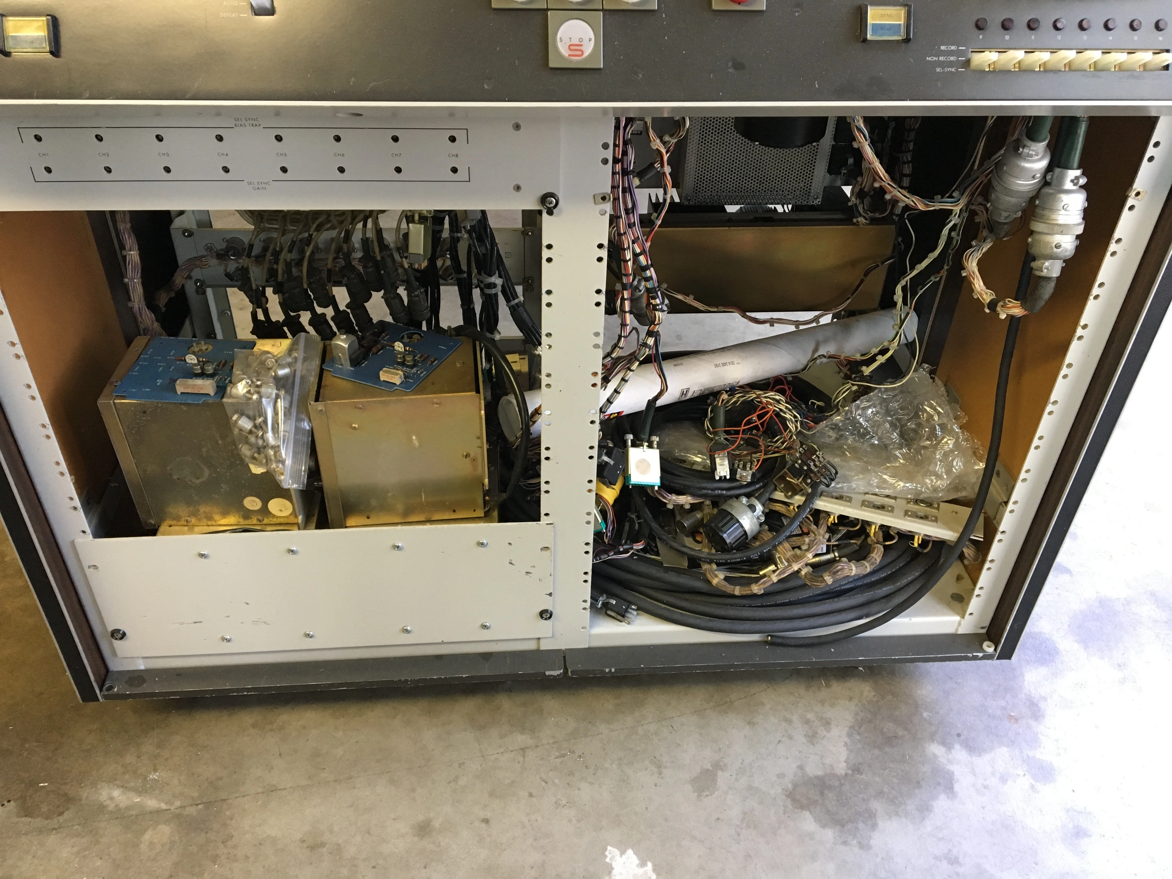

Here's how it looks these days, everything still mounted all pel-mel from the last move three years ago, crap piled in the bottom of the chassis...
You can see spots of mouse pee and a little mousy turd on these power supply mounting panels:

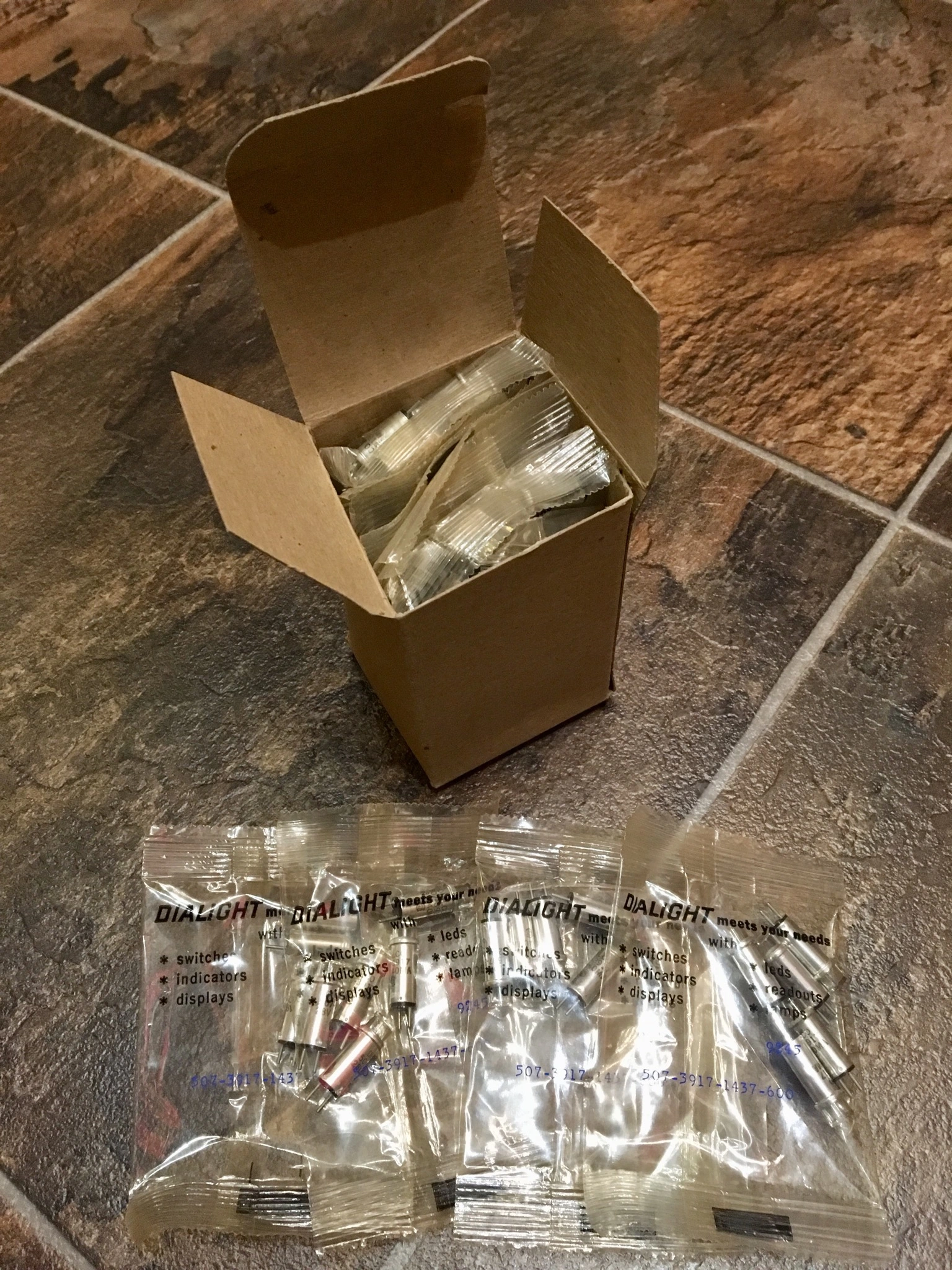

So this is a really minor update, but I have to share what feels to me like a total win.

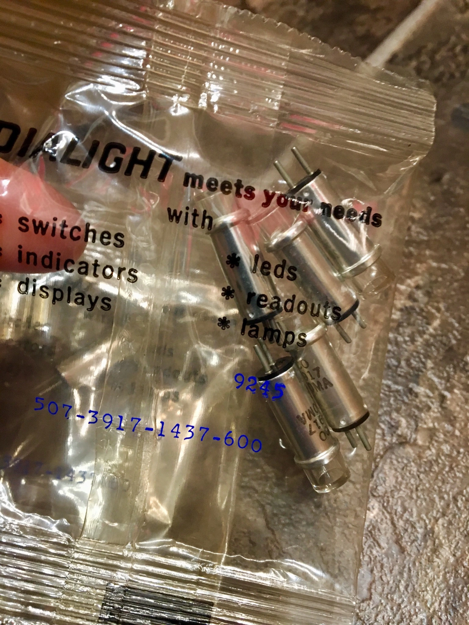

I got these:
If you can’t tell, those are lamps. 28V clear bi-pin base lamps. These go to the VU meters in the amplifier electronics modules. So what? Well, the original Sylvania 24PC lamps have been unobtanium for many, many years, and so all manner of crazy kludgey solutions have been concocted. Replacing with LEDs is what most end up doing, but it’s all a bit of work because of how the originals mounted and/or because they are actually powered by throttled 39VDC power. And for guys like me who much prefer the glow of incandescent lamps particularly for the meters, well, LEDs just aren’t the ticket. It’s gnawed at the back of my brain how I was going to deal with this on my MM-1000 and furthermore just not really looking forward to the labor...but then...a fellow MM-1000 owner tipped me off to an eBay listing for these Dialco lamps that are compatible...NOS...when you can find these lamps they typically go for stupid money but what are you going to do. But these were being sold in packs of 10 for $10. I’m in. I bought 70. Nuts? That gives me enough to replace each pair of meter lamps twice and then some. Plus some of what I have in the electronics are still working. I’m set.

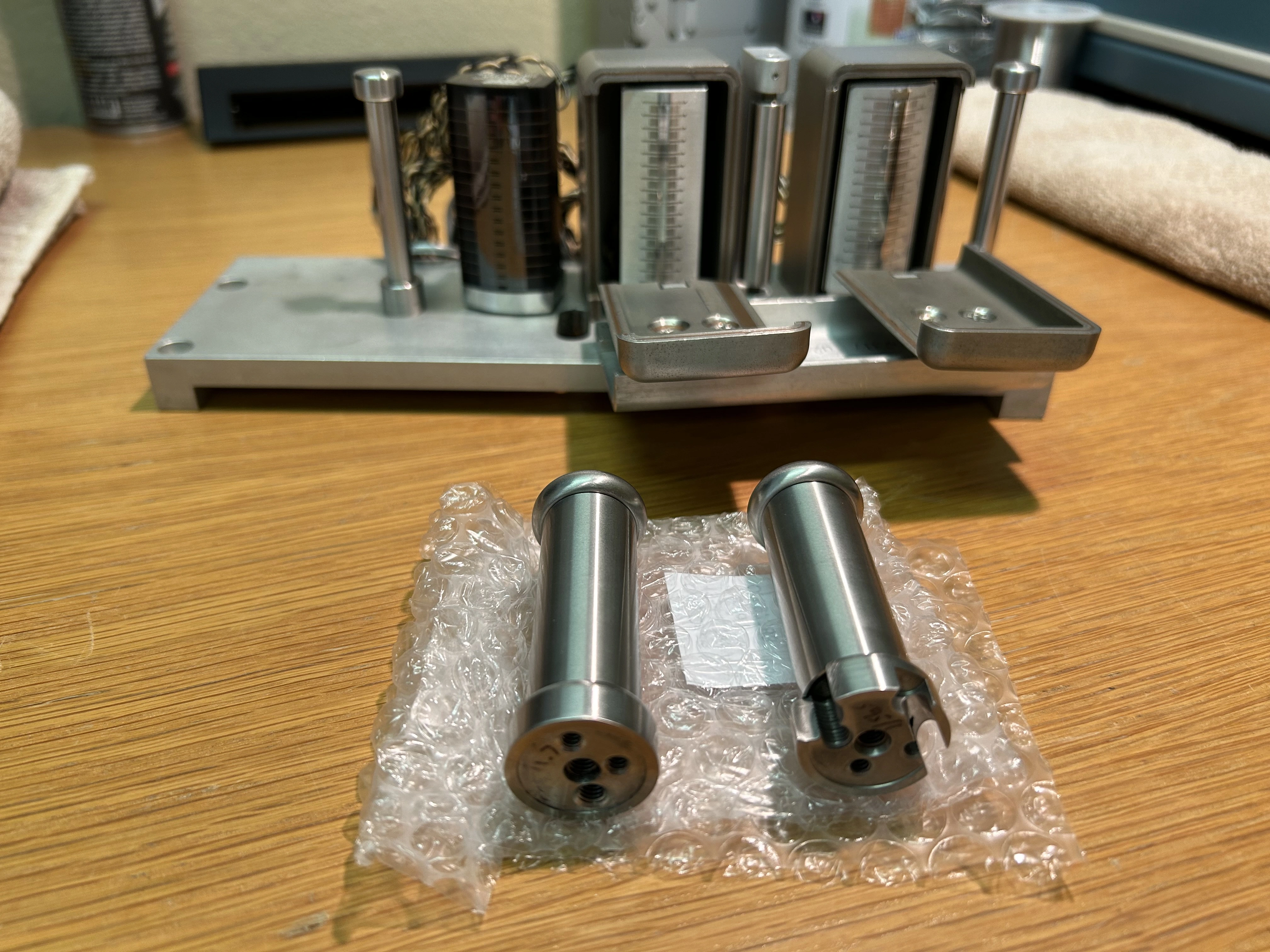

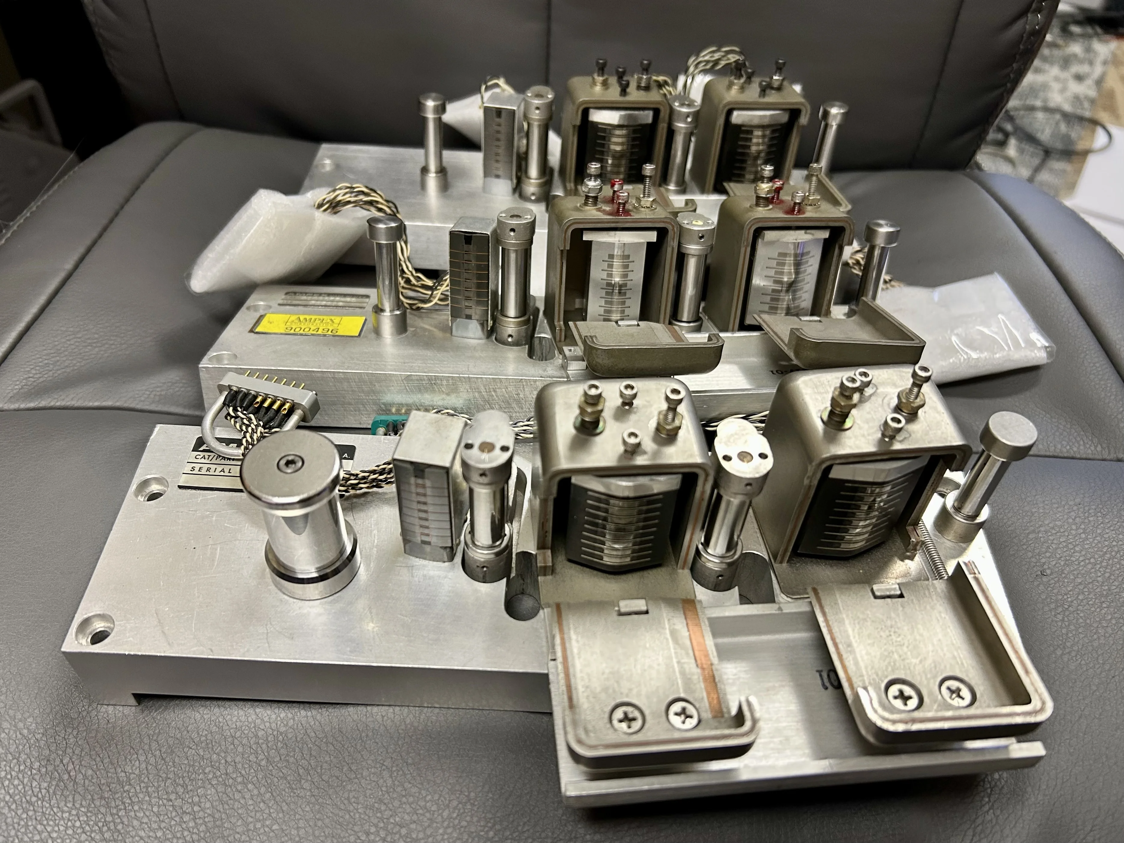

In the meantime I’m getting ready to send the 2” 16-track headblock assembly off to John French for an evaluation as well as have him install a set of rolling guides to replace the stationary guides. These are the guides produced by David at Thin Brown Line. David is very good people and he knows and understands the precision standard around which machines like the MM-1000 were designed and built…a standard that, IMO, is much more rare today. The MM-1000 is not a sophisticated machine. But the engineering standards for the tape path and other moving parts is stringent. So…not sophisticated, but…elegant. And beefy at the same time. So it’s important to maintain that if making changes. David understands that and these rolling guides are exquisite. And it’s not as simple as remove the stationary guides and fasten the rolling guides in their place…they have to be offset mounted to maintain the correct wrap angles on the heads…the rolling guides are much larger diameter than the stationary guides. And then on the outgoing guide the base has precision machining to avoid the guide obscuring access to one of the headblock mounting bolts, and to avoid interfering with the head gate retaining spring. Anyway, a minimum proper thing to do when changing any guiding surfaces is to have the guides mounted by a professional that can set it up with as little change to the tape geometry…so I’m sending it all to John French to do that…evaluate the heads and install the guides and align it as close as possible to the pre-existing wear and geometry.
Many moons later the 2” assembly is back from JRF and installed on the transport, fully inspected and lined up, new Thin Brown Line rolling guides installed. I give you…analog eye-candy:
I’ve continued to tinker here and there on the MM-1000…I’d started to write a lengthy post about all I’ve been doing on it, which amounts to a lot of detail work and resolutions related to issues with the tape path guides and getting the machine fully setup mechanically for both 1” and 2” operation, but part-way into that literary effort I just decided to capture and upload a video to YouTube…link below. I also made an unfortunate discovery regarding the reel idler roller assembly, which the video also details as well as what the path going forward is for that.
What the video doesn’t cover is some additional work-up on headblock assemblies. The one 2” 16-track assembly I have has been evaluated and setup by John French, as per my last post. As for 1” 8-track assemblies I have a total of three of them, as well as a bunch of parts to nearly put together a fourth, but only one of them has been evaluated and setup, and that’s the one with the essentially new AG-440C-8 heads and custom installed rolling guide detailed wayyyyyy earlier in this “Story.” The other two assemblies are comprised of the assembly that came with the MM-1000, a nice assembly with good looking i.e.m. heads, and another assembly with stock Ampex MM-1000 heads in it (equivalent to AG-440B-8 heads) in fair condition. Both assemblies’ scrape flutter idlers were in need of service, and they both needed evaluation and then whatever else from there. So I did some cleaning up on those and sent them off to John sometime in the last year, had the flutter idlers serviced, and had them both evaluated. The stock MM-1000 assembly has heads in not great shape…according to the inductance measurements maybe 25% life left on those, but John set it up as close as he could and it’s a good backup that’s now ready to go. The assembly with the i.e.m. heads…well, almost no wear on them, but, unfortunately, the head height was setup wrong on the reproduce head…though the wear was minimal, the only way to resolve that is a relap. I wanted it done right, so I had John relap the assembly, which required very little work because of the minimal wear…it’s all set now for the long-haul, and the inductance measurements came back still showing them as essentially new in spite of the relap. I’m going to call it 90% life remaining. Here’s the trio, the assembly with the ‘C’ heads in the foreground, the i.e.m. assembly in the middle, and the stock assembly in the background:
