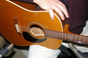

You can see my mic setup in the pic below. This is by no means the only way. I’ve done well with an X/Y setup, and even an over the shoulder setup—but this was my setup for the song in question. My mics are probably closer to the guitar than you normally see recommended. I’m not an aggressive acoustic player—and it was about 3 in the morning. As long as my playing’s not gonna clip the mic, I like a nice intimate, up-close sound.
The neck mic is at about the 12th fret angled in towards the soundhole. The body mic (not shown well here) is actually behind the bridge, also angled towards the soundhole. Nothing’s right on the soundhole. That’s too boomy for my tastes. Besides, my hand is there when I’m playing. Note: all other things being equal, the signal from the body mic will be hotter; so I tweak my preamp so my tracks come in at the same level. It’s just easier for me to mix when everything’s roughly the same.

In that situation, if I were going for a stereo recording of a single take, I'd put the condenser on the neck side and the dynamic down on on the body. But if I were going to double track (which I always do if it's not complete improv) I'd probably not even use the dynamic. I'd use the condenser on the neck--experimenting with placements slightly closer to the soundhole to get some more bottom end--and play it twice for my stereo effect.
It sounds odd, but of the two placements, the neck mic (angled towards the hole) is the "main" mic--not the body mic. Both give you some stereo, but if you use just one, the neck position is usually a more balanced picture of your guitar's sound.
