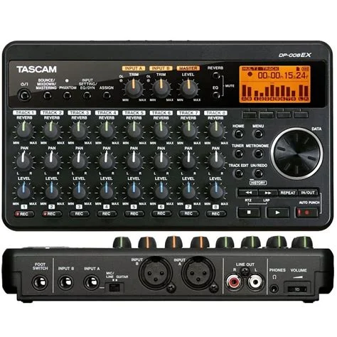

The DP08EX has XLR ins.
I was going to suggest that, but it seems it has been discontinued in the US, South and Central America. Unavailable at Sweetwater, Guitar Center, even Amazon. Now they only show the DP06 in that form, and the Portacapture X6 and X8 in the portable form. DR40X says discontinued, but still available at some places like Amazon, Walmart, Sweetwater and B&H Photo in the US.

Not 100% sure - but I believe that this model is no longer offered new. In north America anyway.
Just checked, and Gear4Music here says not available either.
Sounds like a new model is coming.
