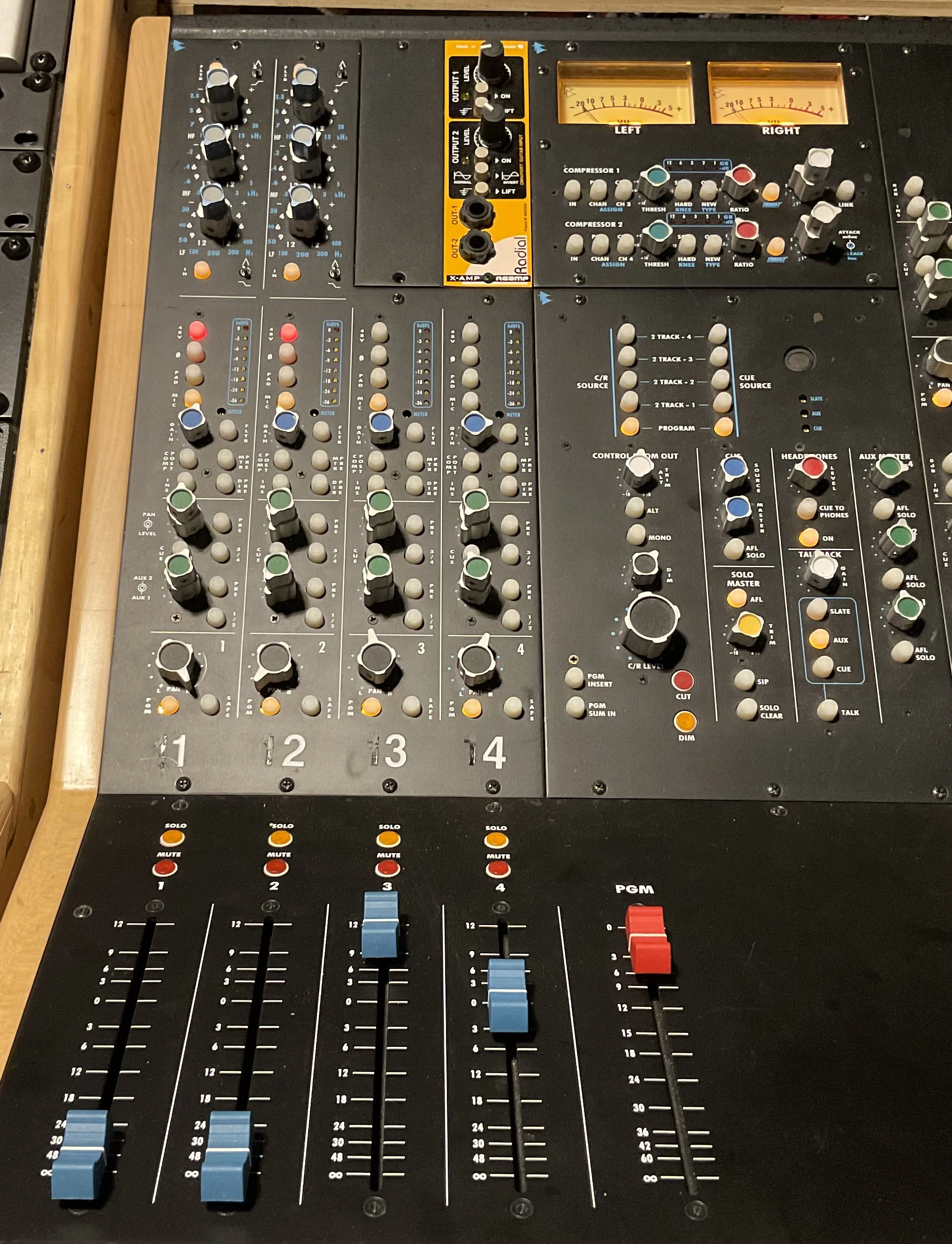

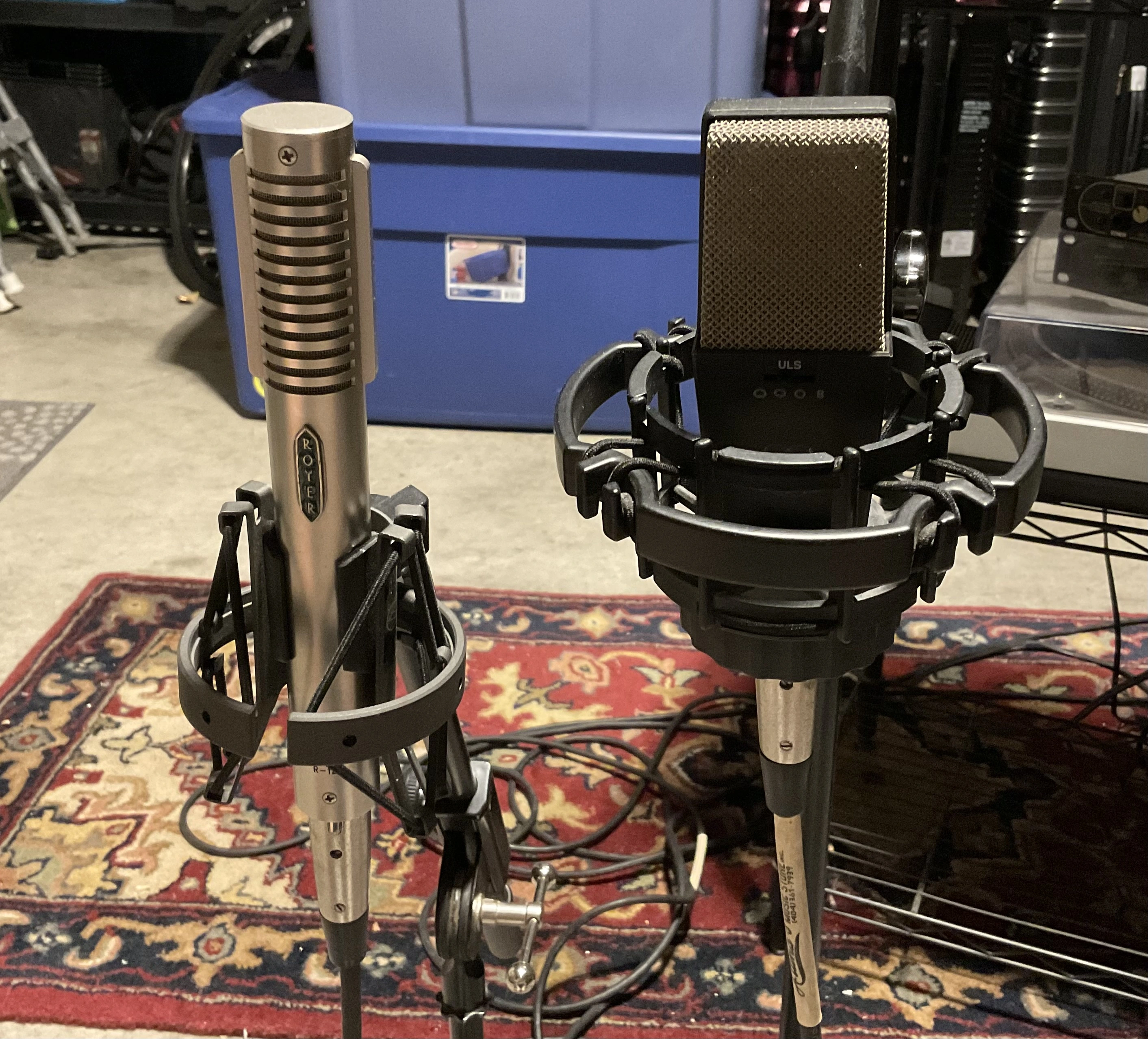

I have been using a two mic setup lately. I aim them both at the 12th fret or one on the 12th and one on the lower bout. Lately I’ve been using a AKG 414 and a Royer R122 with a small bit of compression. I try not to EQ much as the guitars I use are not usually boomy on the low end. See photos in my next post.

I’m currently using this set up with both mics pointed at the neck joint. Sometimes I move the 414 down to the lower bout on the treble side.
