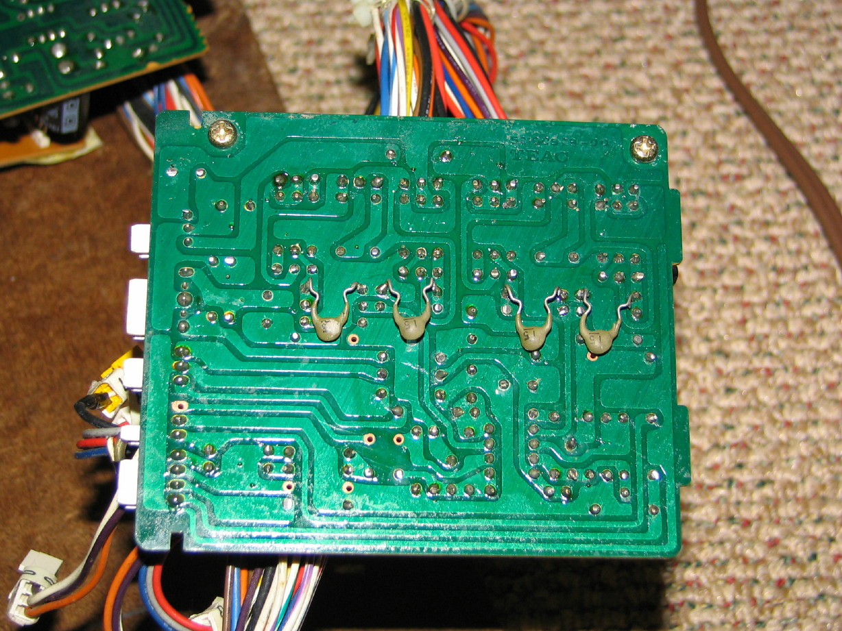

Okay...Second question: here is a picture of the trace-side of the Balance Amp PCB.
Are those tantalum caps I see there, and if so is there any advantage to replacing/upgrading those? It was recommended to me to replace tantalums with a poly or metalized film cap in a recent thread I started on possible mods for a Studio Projects mic...

Ceramic disc caps.
Sheesh...how do you tell those things apart? Any benefit to swapping them out? I know ceramics last a long time, longer than electrolytics for sure...

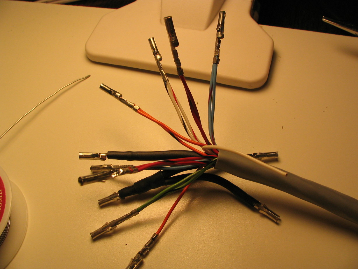

Got the mixer end of the power umbilical put together. It was not easy...had to redo some stuff. It would have been a cinch but there are two wires from the PSU that carry one of the three 0V rails to three different wires from the power connector on the mixer. Not sure why it was done that way as the three wires all go to the same spot on the motherboard, but... :rolleyes:
So trying to get those two little wires split to three different places in a way that would fit, and not splay everywhere and be durable was a chore. It didn't help that I was putting adhesive-lined 3:1 heat-shrink on everything. I suppose I didn't have to do that, but I wanted the job to be durable...at the PSU end the Hirose connector hood of course has a cable clamp and all that...not so for the Molex connector at the mixer end...as usual I think I may have gone overboard.
Anyway, after having to dicker a bit I came up with a solution that worked...
Than I had some trouble because I didn't understand all the lumps and bumps on the Molex pins...some keep it from backing out (they are obvious), and others keep it from going too far, and those were covered up with heat-shrink...dummy... :mad: So I had to dicker with that too.

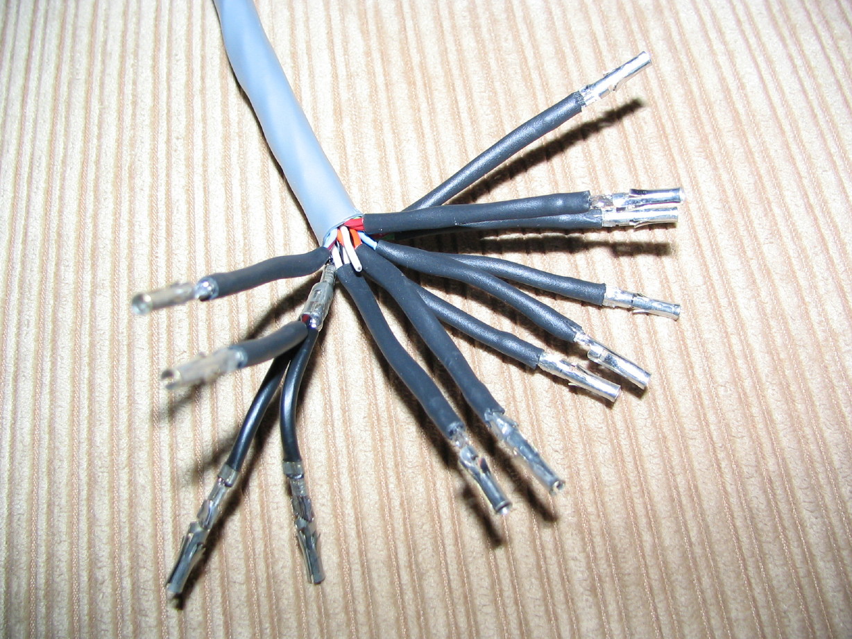

Here is a closeup shot of a couple of the Molex pins...I got pretty handy using the crimping tool to get things good and secure...I also soldered the wire in. Again, probably overkill:
Here is a shot of all 12 pins installed:

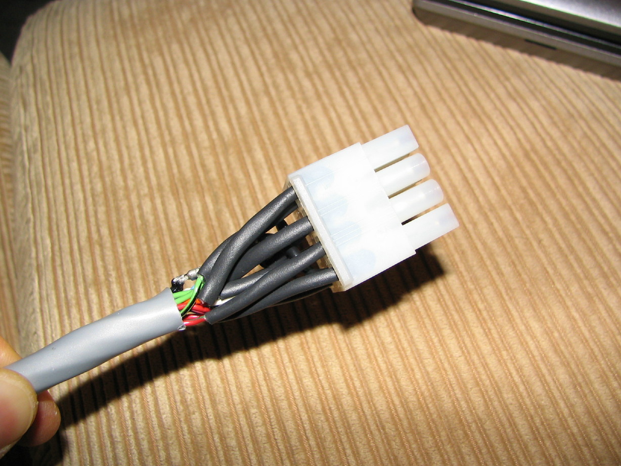

And here is a shot of the cable prior to stuffing the pins into the connector shell:
Here they are all stuffed in there:

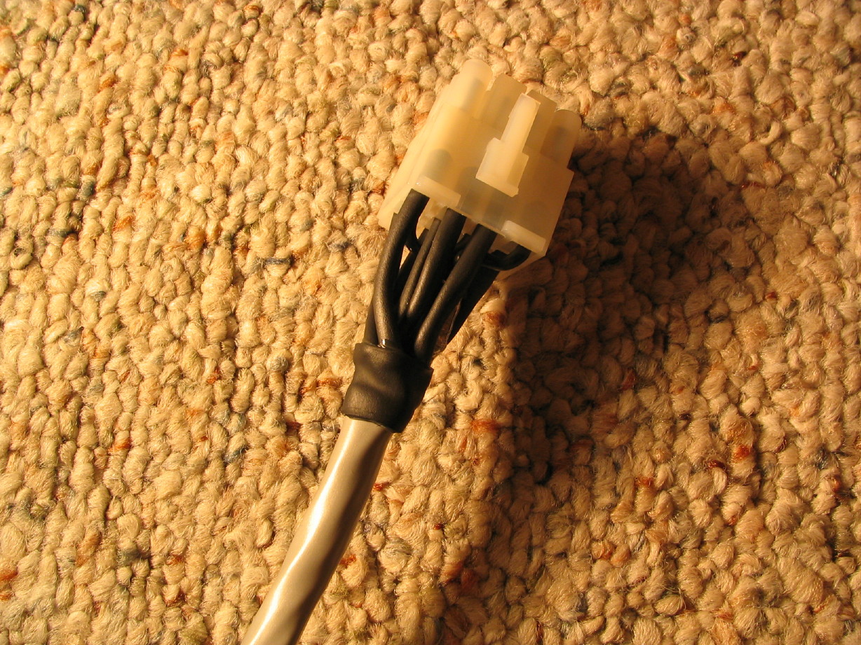

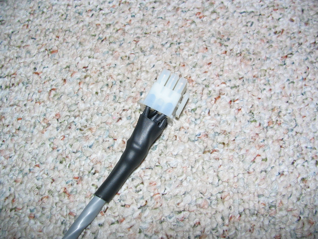

I put one band of heat-shrink around end of the factory sheathing on the multi-core cable, and then...:
I put a big piece around the whole mess:

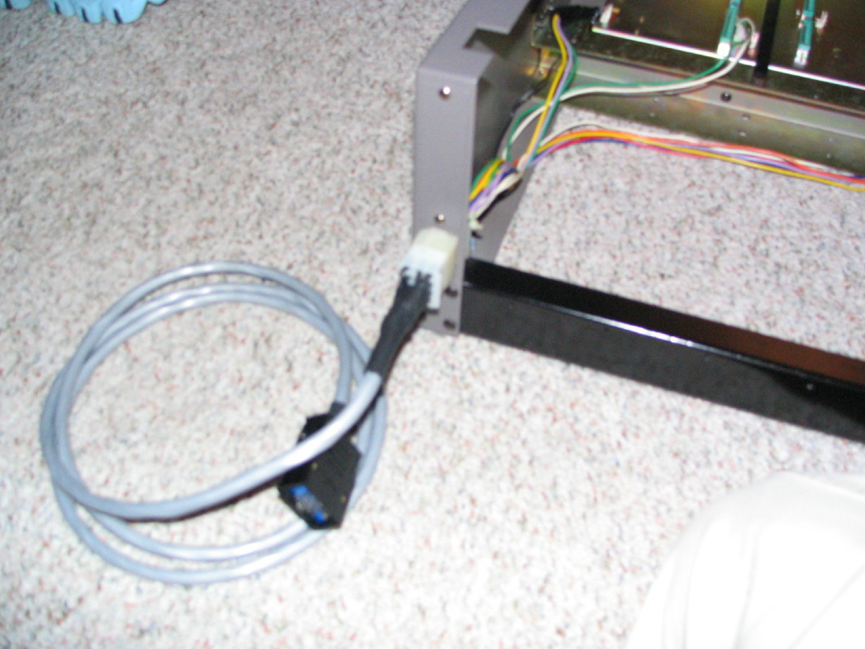

Here is a (blurry) shot of the cable connected up to the mixer:
Not exactly pretty, but I think it'll work and stand the test of time. It is appropriate for a prototype mixer, yes? :D

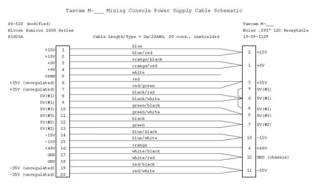

Here is the power umbilical pinout:
