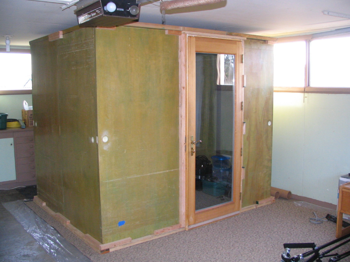

Anyway, the "immensely more important" thing: my eldest of 4 children turns 11 today...he's the one that made the journey to Cali and back to get the mixer. Family get together tonight and then he has a bunch of friends coming over Saturday to celebrate. My wife came up with the party theme...garage band party...I've been working nights out in the garage this week constructing a 6' x 8' iso booth out of solid core doors that I salvaged a few years ago. It will be used for the drums and bass (direct) and then we layed a patch of carpet outside the booth for the keys, vox and 6-string guitars. We'll have fun letting them play and swap instruments and I'll man the recording station. I'm keeping it relatively simple recording-wise so we can focus on fun, and I'll have a couple effects engines going, plus my LP knockoff electric guitar is going through a Digitech GNX2 so there will be all sorts of fun guitar effects, and I'll have fun making the vocalists sound like girls or robots or Jabba The Hut or whatever...so that's what I've been up to this week.
I'm probably going to post up something over on the studio construction forum abaout this; about the iso booth. I have no acoustic damping in there right now, so it is all hard-surface, but the doors are heavy so I've got mass, and I tried to get the room dimensions as close as I could so a desirable ratio, but the low register reverberation and low-mid flutter echo is shockingly present...I can stand in a corner and hum a tone around 100Hz and it gets boosted in the room by at least 6dB...I was hoping to use it after the party as a better micro-mixing room as the space I use now has an even smaller footprint and only 5' ceilings. :D:D Sounds ridiculous I know, but you gotta use what ya got. Anyway, I think it'll be cool for drums for a certain sound because of the low-end boost and the echo is so dense that it actually sounds like a very big room in there...kind of small cave-like. The drums are gonna wash big-time. Planning on just putting a kick mic up and a single LDC set to omni.

To update you on the "half-time show", here's the iso booth I was talking about...I got all the materials free through salvage efforts except for about $20 of lumber:

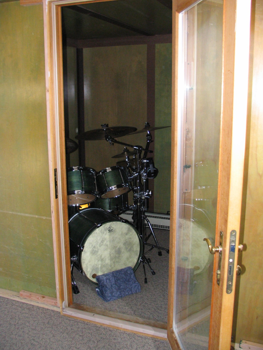

Here's a shot through the door to the interior:
I was pleasantly surprised when I tried the drums out this morning for the first time...they sound incredible. Plus the garage has a great medium room reverb in it...wondering what it might sound like to mic the kit inside the booth with a minimalist approach (one overhead and one kick) and then mic the garage with, like, an M+S mic array...could be cool...but anyway, the drums sound rich and smooth in the room and the voices are much more distinct than I thought they'd be with how the room was behaving prior to bringing the kit in...and the noise attenuation? I'm also pleased. Subjectively the attenuation outside the booth when the booth door is closed is similar to putting foam earplugs in when inside the booth. When I play, the sound pressure level at the kit is about 100 ~ 110dB. Its a ranch-style home with the bedrooms all at the opposite end of the house from the garage and you can't even hear the drums at that end of the house. :)
Our house is small...Its sad but my drums only come out maybe 1 ~ 2 times per year and its been that way for 20 years (since I was last in a place where I had drums that could be setup and left setup in a climate controlled environment and played at a regular volume level)...I'm excited...can you tell?
Kudos to my lovely wife who spent hours getting this thing setup with me and getting it positioned. :)
