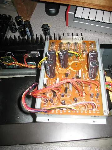

PS-520 to PS-__ conversion
Found a little time and want to get the PS-__ off my bench so I installed the new electrolytics that I had. Still missing the back ordered 10,000 uF @25 V and a 10 uF @ 35v. I'll sub a 10uF @ 50v for it most likely.
A few of the old caps showed some signs of internal pressure....
One step closer to powering up. (the PS-__ and the M-__)
-ethan

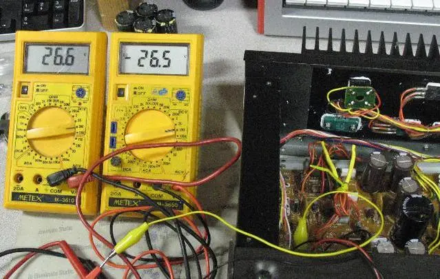

Well now, The ps520 is no more, long live the ps-__
Installed the right cap and put the old 10,000 uF back in pending getting a new one. Pulled the +-18 volt regulators out of circuit (Easy to put back in) and jumpered their connection.
Then I remembered that the +-18 volt lines have 47uF at 25 volt caps down stream of the regulators. Pulled them out and put in some 22uF 50 volts that I had lying around. Not that they are actually needed.
Fired it up and nothing smoked!
No load gives +-26.5 volts as you can see from the photo. Loaded it up to 400 mA and the voltage dropped to 24.5 volts. Which gives lots of input vs output voltage (24 in, 18 out) for good regulation.
Just need that 10,000 (on the way) and I can put it back together.
--Ethan

So the 22uF 50V caps are just filter caps and not really necessary because the rails get filtered at all the downstream regulators in the M-___?
Wow...only about an 8% drop in supply on 400mA...that's healthy. Those rails supply, I think, like 14 opamps...2041's IIRC, and not a lot of passives.
This is really cool...thanks Ethan!! :D
Yup, the downstream regulators take care of it. I put the 22uF in so that should this ever be converted back you wold have a fighting chance. Plus the datasheet says that they are for transient response and not strictly required. The value is not very important.
What is good is that you have at least 21 volts at load. That is 3 volts over the regulators output voltage which gives the regulator room to work. They can work with less delta but then you can get into not so good regulation.
