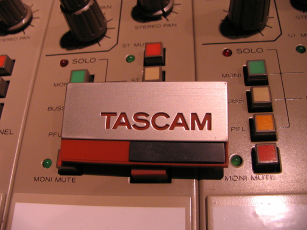

The badge on a 244 Portastudio is also the same layout, only it says 244 in the black space.
Something to consider, there are engravers still around these days, so it might be possible to make you own badge by getting a hunk of orange plastic and laminating a thin piece of brushed aluminum to the top of it and then find a local engraver who can cut in the TASCAM letters, which is just a simple Microsoft Sans sheriff bold font with tight letter spacing. The black section in indented down into the orange layer and if you really want to get authentic, there's also some diagonal ribbing in the orange plastic to the left of the black part.
Here's a pic of that from my old 244, which I no longer have...
If you right click and save the image to your computer, it will be in full resolution.
Cheers! :)
That's an idea alright...are they the same size though (244 vs M30 for instance), and do ALL the badges of that style have the ribbing in the orange section?

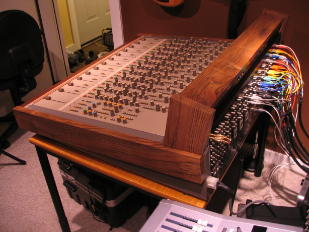

Got things hooked up.
I tell ya, the DOWNSIDE to having a relatively feature-laden mixer that you haven't used much, is that your eyes get muddled in all the controls...with the double rows of controls on each strip it is actually difficult to discern between channels when I am focusing in the middle of the control panel. I know time will sort this out, but for a 12 x 8 console this thing is a sea of beige colored knob caps.
My first assignment is to simply get some wet headphone mixes setup for my girls so they can practice their singing. I'm using my Tascam RS-20B for reverb and a Behringer HA4700 for headphone amplification. I've got their mics coming into channels 7 and 8, sending those to the stereo buss and using aux 1/2 (which is configured as a stereo aux buss) to feed the RS-20B. Then the reverb is coming back via channels 9 and 10. Couldn't get anything back. No activity showing on the RS-20B...i figured I didn't have something set right on the mixer...i used the switcheable metering to confirm that there was indeed audio getting to the aux out jacks, and double confirmed using the solo function on those outputs. So I moved on to cabling. Turns out that I had one channel bad on the snake TO the patchbay, and one channel bad on the snake coming back FROM the patchbay which ultimately killed both channels. I couldn't see any activity on the RS-20B on the one channel getting TO it just because the level was really low. I realized I was feeding -10dBv signal to a 0dBu input on the RS-20B. Switched the aux outs from -10dBv to +4dBu, rolled back the trims, re-patched the cabling and all is good.
The mixes through the girl's headphones sound kind of harsh and thin. I never expect much from the Behringer headphone amp. It gets the job done and was cheap. It'll work and the girls likely won't notice, but I was pleasantly surprised when I switched to monitoring off the console. Now, mind you, I've never been impressed with the headphone amps on any of the Tascam gear I've owned. Not bad, but not great and typically noisy. It sounds like a different mix...the reverb us lush, the soundstage is relatively huge compared to the mix off the Behringer box...quiet...it made me say "wow!". Enjoyable to listen to.

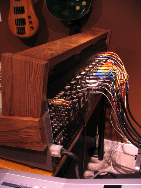

So i'm really disappointed in those HOSA snakes with the bad channels. Its not the brand per se because I got these used years ago and am just getting around to needing them now. I know I tested them when I got them and all channels were good, but there must have been impending failure lurking under the insulation. Not looking forward to it, but i'm going to build up some snakes. This mixer needs something more than the prefab stuff. I have all the 1/4" connectors for the patchbay/outboard gear, and i'm pretty sure I have all the Gepco snake cable I'll need...just need a bunch of good RCA connectors...i don't like soldering up RCA's. Unless you spend a mint the strain relief is always lacking, and they're more cramped come soldering time. Well I found some great connectors at Parts Express that'll cost under $1.50 each, have chuck-type strain relief and are all metal and have gold-plated contacts. Perfect.
I've looked at several pictures of the M-30 and the 244 and both seem to have the same size ratio compared to the VU meters they are placed beside. So, I'd give that a 99% probability that they are the same size.
About the the lower left corner ribbing; that's a tougher call as there's no acceptably clear and detailed images on the web of the M-30 badge. But on the clearest one I could find, there is visual indications that it is ribbed too. Plus, it would make sense from a production point of view that both badges came from the same mold with just the model number insert being the variance.

Just a couple pics I snapped while starting the hookup:
OMG, seriously?...
No MH-40?
Then,... why couldn't you scavenge a 388 or something else for some colored knob caps? BTW, I think Tascam still sells colored caps, TBD.
Awesome job and great pictures!

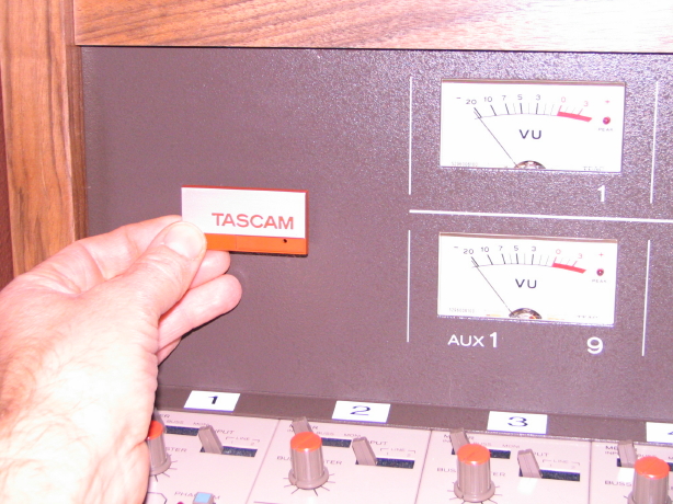

Got the emblems from Teac today.

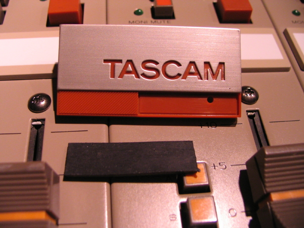

When I pulled one out of the box I knew right away that I was going to have to fabricate some sort of blank for the black section that normally displays the model number as there is a recess for it...found some material to trim. Here's the emblem with my rough piece of black vinyl material:
This is about where I'll mount it I think:
Here it is after trimming the material and gluing it in...not totally sure I'm happy with it, but it'll do for now.
Glad to see the name plates arrived safe and sound! :)
What is the mounting regime on the back of it to affix it to the mixer?

Your black insert material looks OK but perhaps a bit less glossy then the original material, or perhaps that was just a photographic artifact?

The emblem has two plastic posts on it for push-nuts. I'm pretty sure my local hardware store has what I need for that.
Yeah the insert is less glossy. I think I could improve on that but honestly I kind of like the look of the matte finish. In the meantime i'm likely to keep my eyes open for something else material-wise laying around here.
