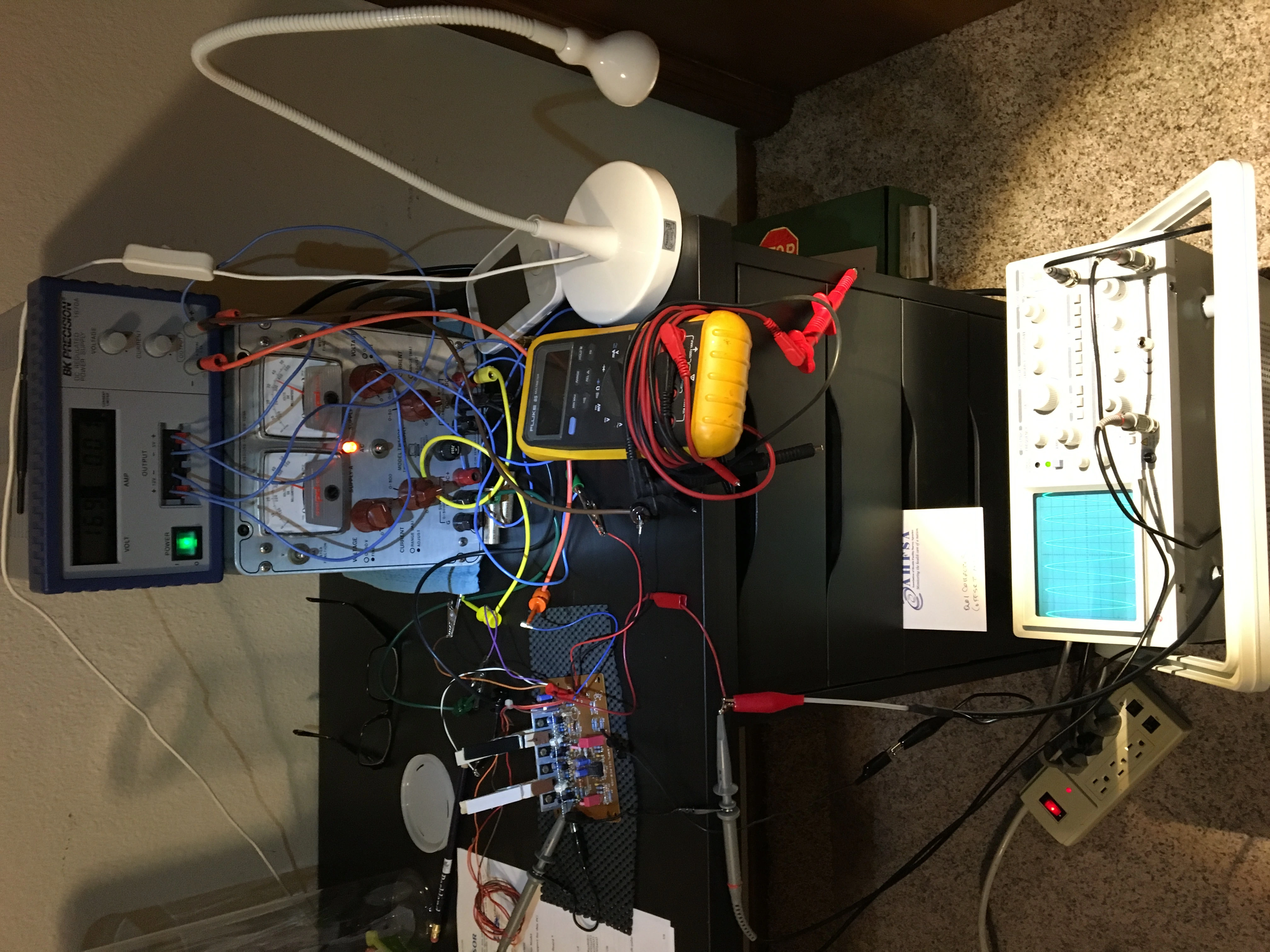

So I feel good having accomplished *something* on the M-__ project...the console in its entirety remains in a closet sitting on the wrist rest after it was stored away in preparation for our baby last Spring. Things have been busy since then. What I did finally do was completed the next step of testing on the modified line amplifier project, the line amplifiers that drive the PGM, AUX and STEREO output busses. A quick refresher: I accepted some expert help in taking Teac’s high headroom discrete output stage amp design that was designed for the M-__ (and is found on the M-50 BALANCE AMP output, and a simplified lower headroom variation is found on the LA-40mkI) and significantly modifying it to, primarily, maintain good stable specs down to very low inpedances in order to be better suited to drive the relatively low impedance inputs on my Ampex MM-1000 and 3M M-64 tape machines. Where we left off was verifying the test amp is producing the proper gain. I’ve already verified the thing doesn’t self-destruct when powered, runs cool at idle, and takes clean tone at the input and produces clean tone at the outputs with some gain. So I did all the tests regarding the gain at different stages in the circuit and sent off for feedback...waiting for a reply. But I think it’s doing what it’s supposed to do. IIRC the next step is to load test it with a dummy load, and if it survives that then the next step is to conduct distortion analysis. Along the way there may be tweaking of some component values, but in the end the hope is to have a circuit I can replicate across all I/O modules and the master module that will kick sonic ass. Here is the crazy setup...it’s a bit of a mess since I have to temporarily setup wherever I can find some space:

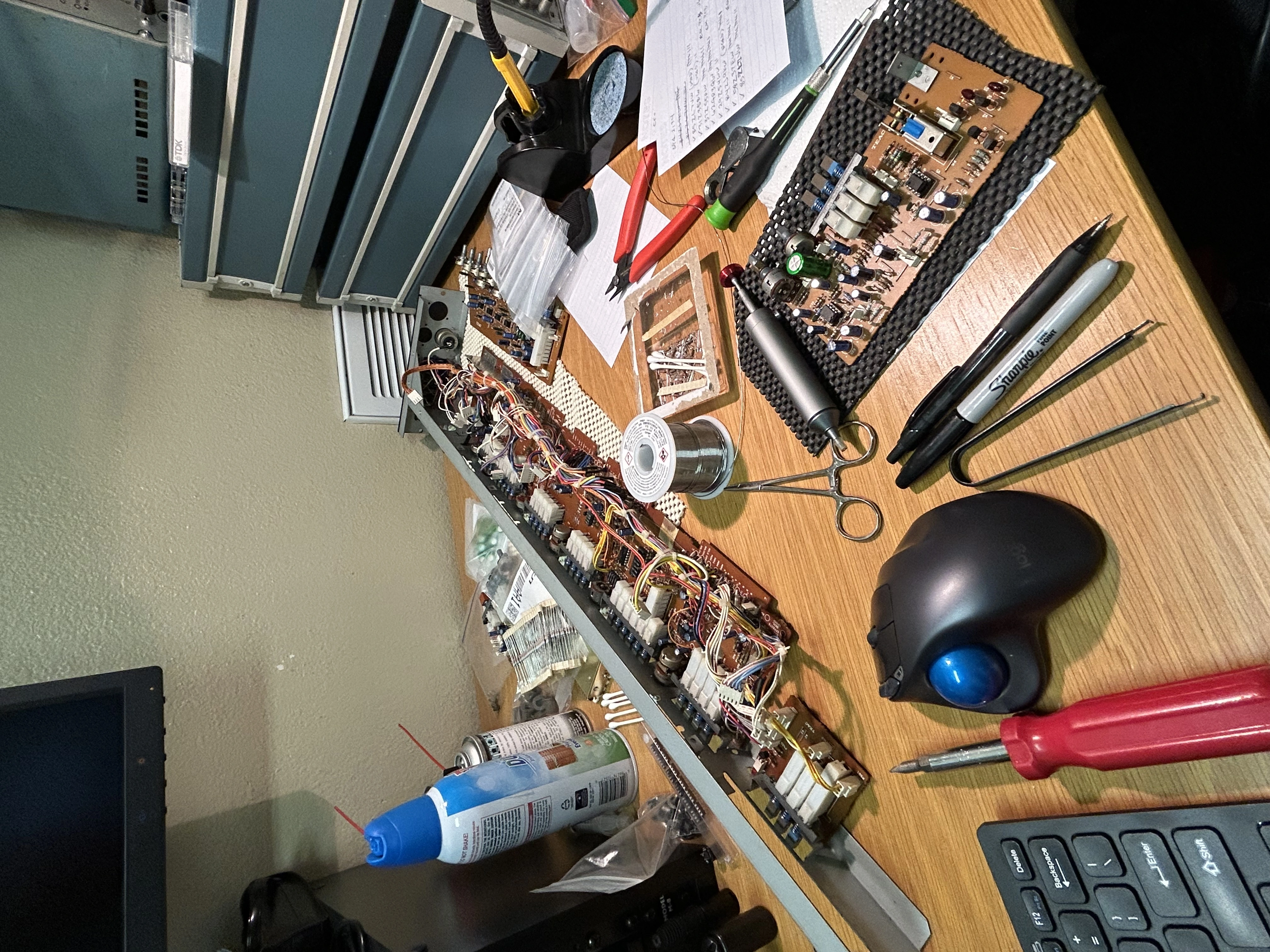

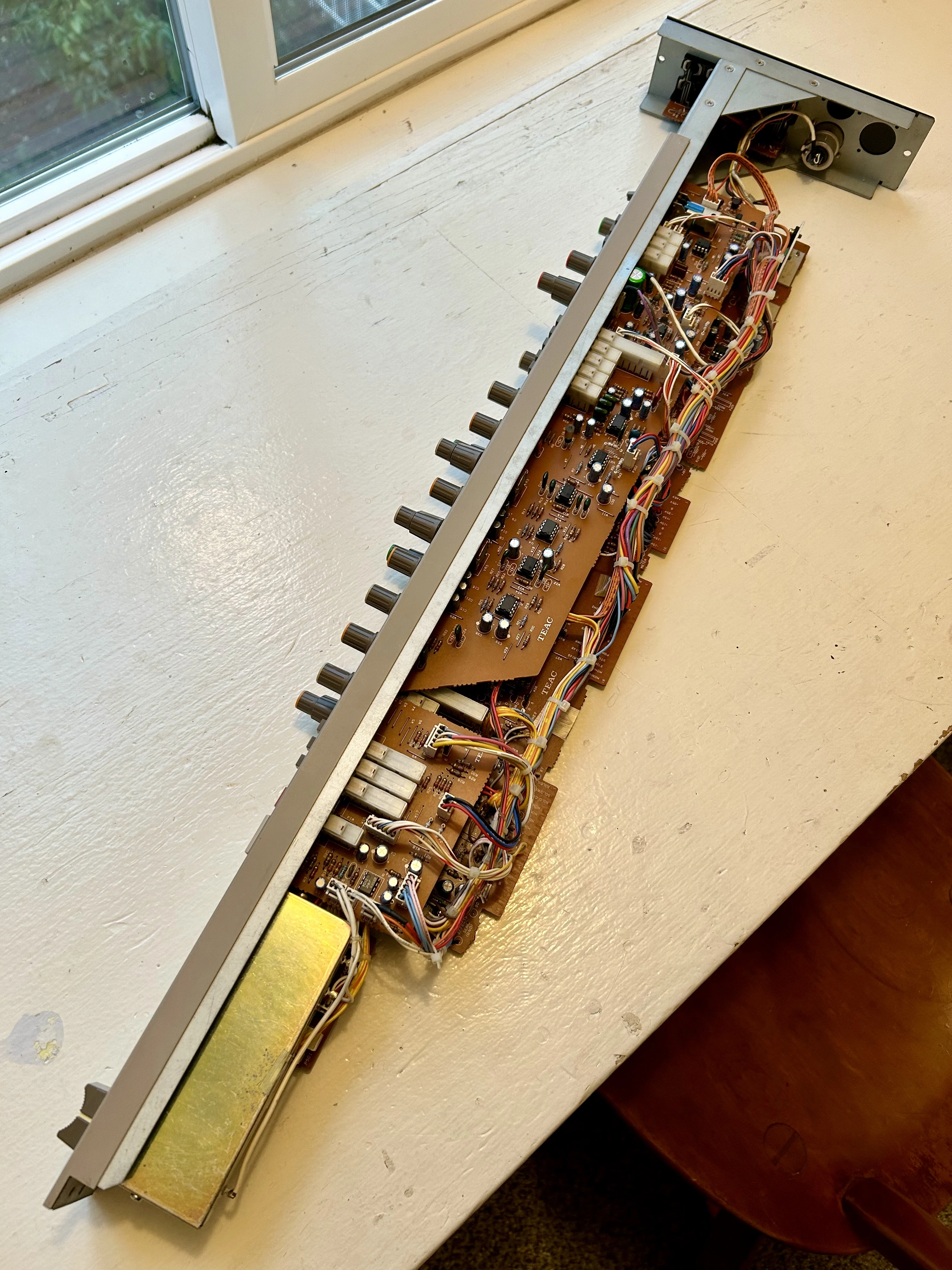

To all those who may wonder from time to time if the Tascam M-_ project is dead or gone, the answer is no…still have it, no intention of letting it go…am currently working on setting it up as something of a “Studio B” console…one of the input/output modules has been apart for some years because of research and reverse-engineering that was done in that time, but now that I have some space and more of a purpose for it, I’m getting that module put back together, and in the process implementing a punch-list of modifications and tweaks gathered over the past…well bunch by this time…of years.
I bring you, M-_ carnage:
And a short video:
https://youtu.be/HB3aBoUtYKM?si=leockVA-b-llJ0g3

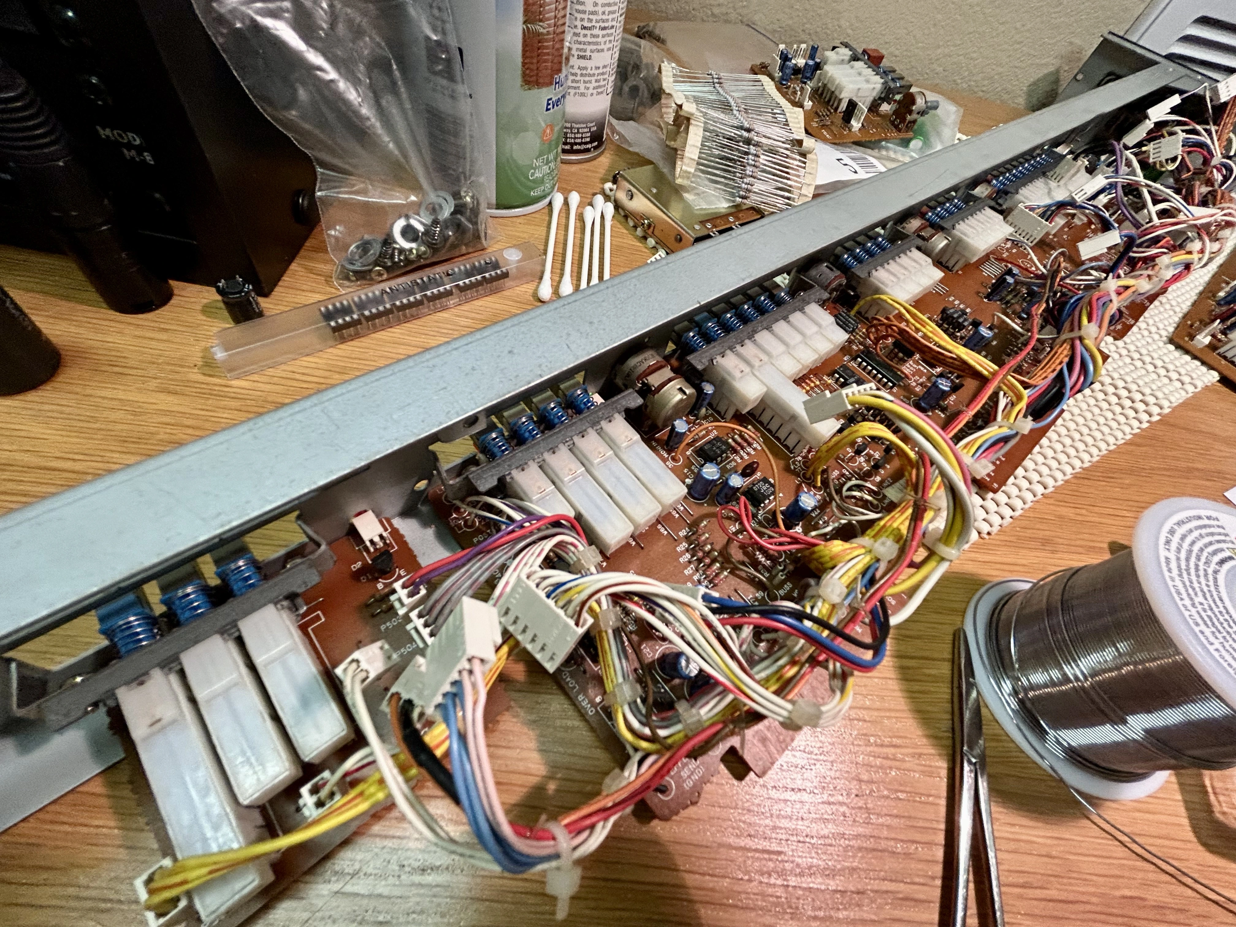

Can we all just appreciate for a moment the number of push switches on each input/output module? There are two rows of them…here is the row with 30 switches:
The other row, removed in the picture above, has 12…42 push switches in total on each module…two 3-position toggle switches…and including stacked pots and the slide potentiometer of the channel fader, there are 23 potentiometers on each module…67 controls total on each module.
FYI, for anybody that’s interested, some of the tweaks/mods I’m doing include replacing all the power rail decoupling resistors with new parts, replacing select 5% carbon film opamp feedback loop resistors with 1% metal film parts, adding just a couple HF bypass caps in the signal path on the EQ board, and replacing and socketing some of the opamps, and in those instances adding a small value cap across the power rails at each opamp as insurance against oscillation, though likely nothing I’m putting in would be unstable enough to oscillate. What I want to underscore here is, lest anybody go thinking they should just start replacing all 5% carbon film resistors with 1% metal film parts, or that changing opamps is “better”, everything I’m doing is supported by extensive analysis and testing, and with intended purpose…none of it is carte blanche. And none of it is wild stuff. The opamps I’m putting in are considered vintage at this point…I simply believe, after a lot of years of doing this sort of thing and listening and testing, they sound better, but without trying to turn the console into something it’s not. I don’t want to sterilize it, I just want it to sound more like itself if that makes sense. And all the resistor stuff is to 1. hopefully achieve an incremental improvement in the noise floor, even though the console is pretty quiet already…but there are a lot of amp stages…! And 2. maybe achieve some incremental improvement in channel-to-channel tracking, and stereo tracking when using a single input/output module as a stereo input module. Again, the opamps being used are not latest/greatest parts…just TI-branded 5532 and OPA2134 parts, in place of NJM2041 and TL072 parts. And there’s nothing wrong with a 2041 or a TL072…they are everywhere in lots of your favorite gear and even in some coveted gear. I just happen to be able to test and make sure different opamps are actually happy in a given circuit electronically, and then listen to identify if I can even hear a difference, and if I do, decide whether or not it’s a good difference or a bad difference. I generally like the sound of circuits that use the 5532, and where that doesn’t work as an upgrade I find the OPA2134 to be a very stable and good performing alternative to the 072 or the 2041. I’m sure plenty of people would call me a fool to go to the trouble of testing, disoldering, installing just to put in what many consider to be obsolete parts rather than the latest and greatest fastest chip. But often times those folks are going for input=output neutrality, and anything toward that goal is good, and anything otherwise is not good. Again, my goal is to just help the console sound more like itself. Changing opamps is no silver bullet, and there are lots of caveats. So I proceed conservatively and with an objective in mind, a pre-conceived answer to the questions “why am I doing the change, what’s the purpose, the desired outcome, and is it worth it?” Sometimes it’s just curiosity. Anyway, that’s what I’m working on, but just here and there, because the console is now almost back together and fully functional and I want to put it to some use and, while I’m at it produce some new videos that go into better detail as to the functions and operations of the console…something of a video manual in case it’s of interest to others, and, just as importantly, to help me when I forget some needed detail about a particular function. Like all the SOLO functions…there are 5 on each input/output module…where does each one tap the signal path? And which ones are in-place and which ones are not? I can’t remember. This will all become better as I use it more, but it would be nice to document a baseline for reference. Anyway, modules 1 & 2 are partially modified, module 9 will soon be fully modified. Then I can just use it for awhile and get used to it, and be able to identify if even the partial treatment is worth it, and if the full treatment brings any worthwhile benefit. I’m reasonably certain the partial treatment is worthwhile…we’ll see about the full treatment. But it will be nice to be able to just play with it and A/B the different versions.

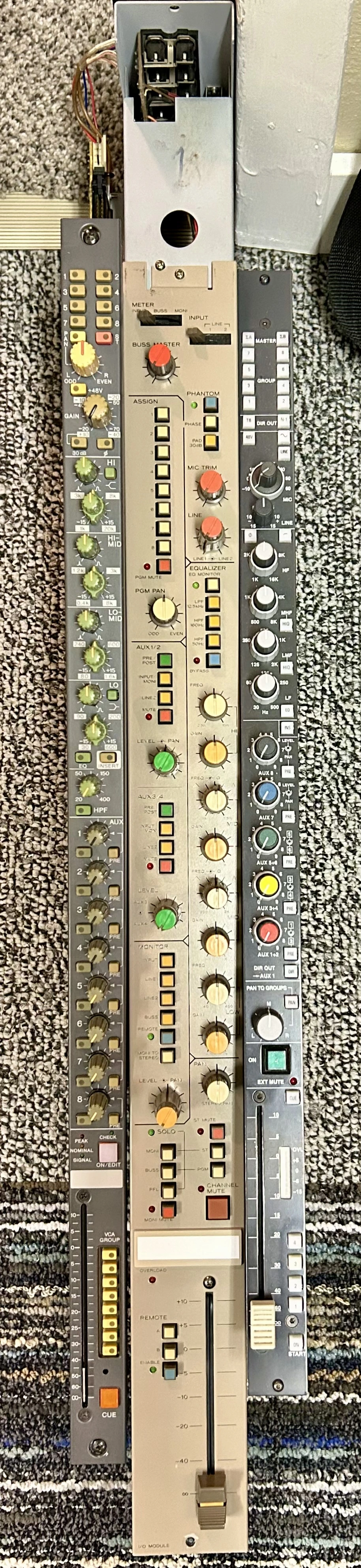

I mean, it doesn’t look puny, but I think this next pic will surprise you…here is, in order from left to right, a Yamaha PM3500 mono input module, a Tascam M-_ input/output module, and a Studer 928 mono input module all right next to each other:

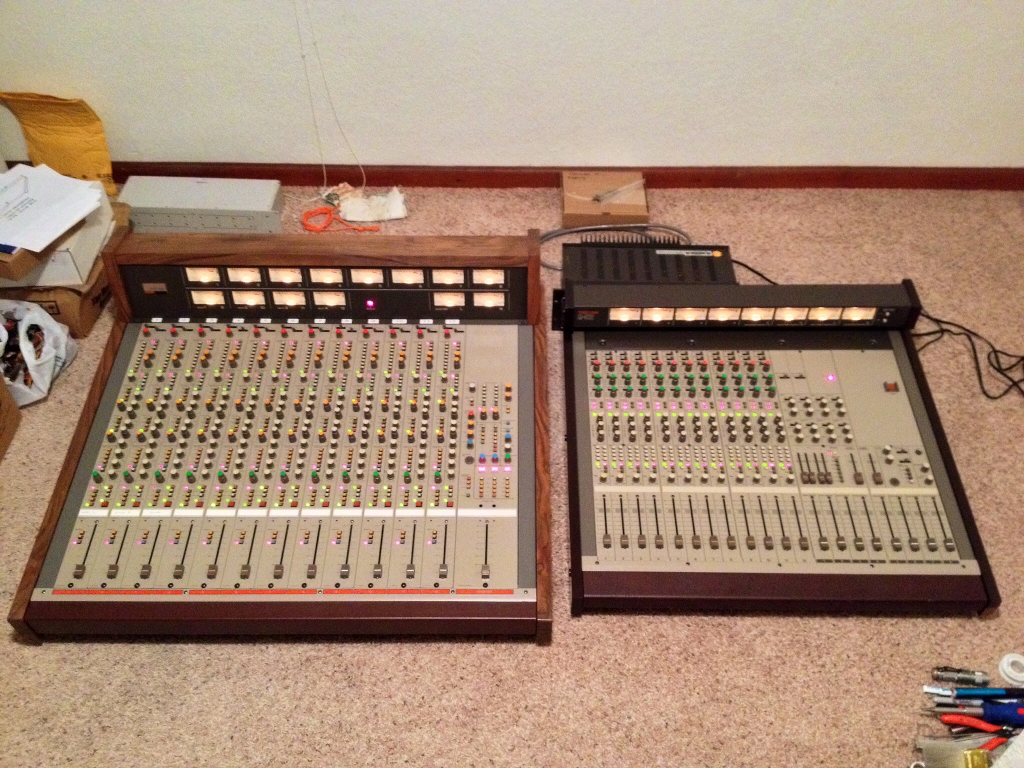

Yes, that’s right…overall the Tascam module is the longest, and it is about as wide as the Yamaha and Studer combined. I think I posted a pic in this thread years ago of the M-_ next to an M-512…if I can find it I’ll add it to this post.
Okay here’s the pic:

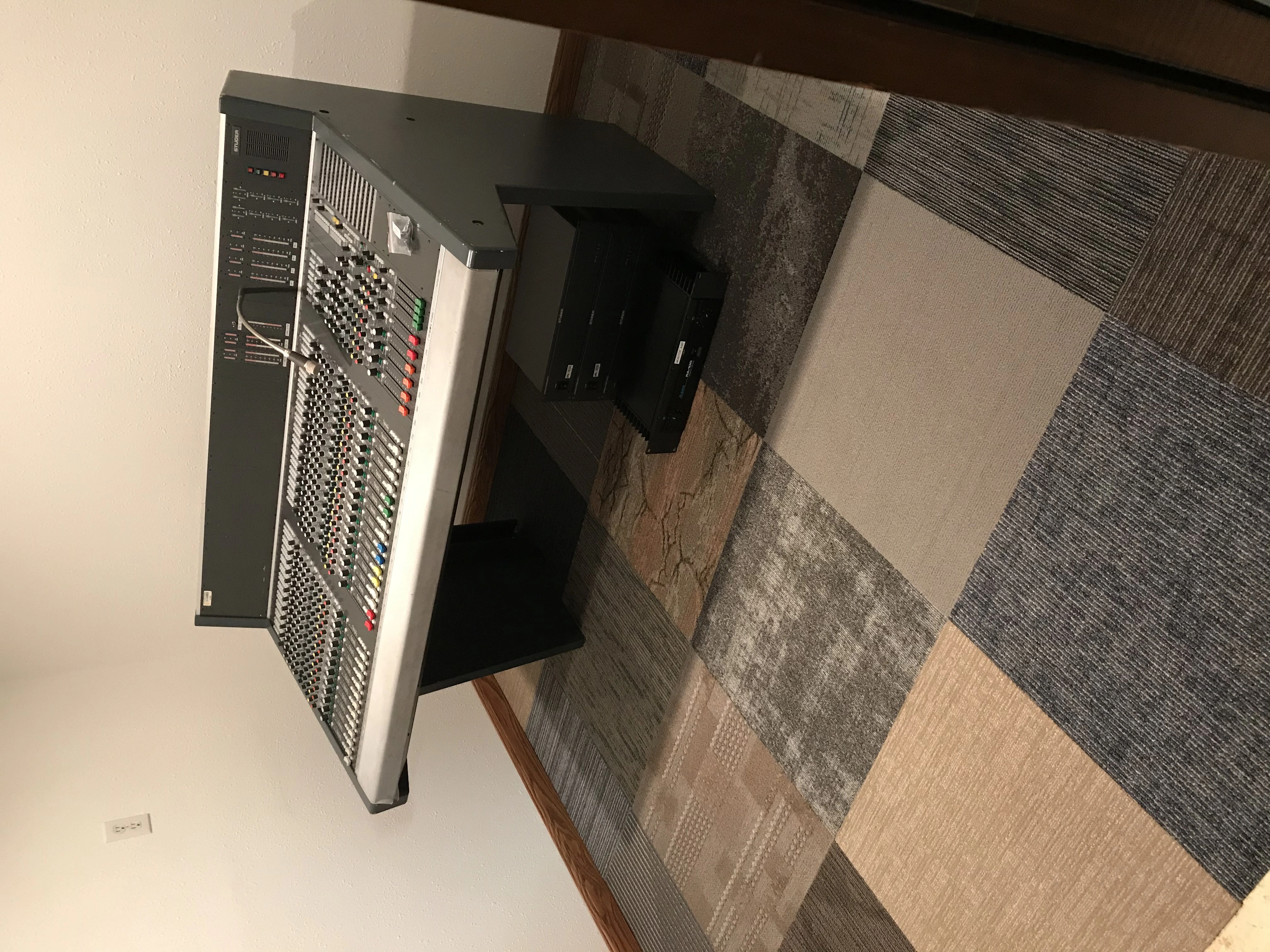

Module #9 is back together…

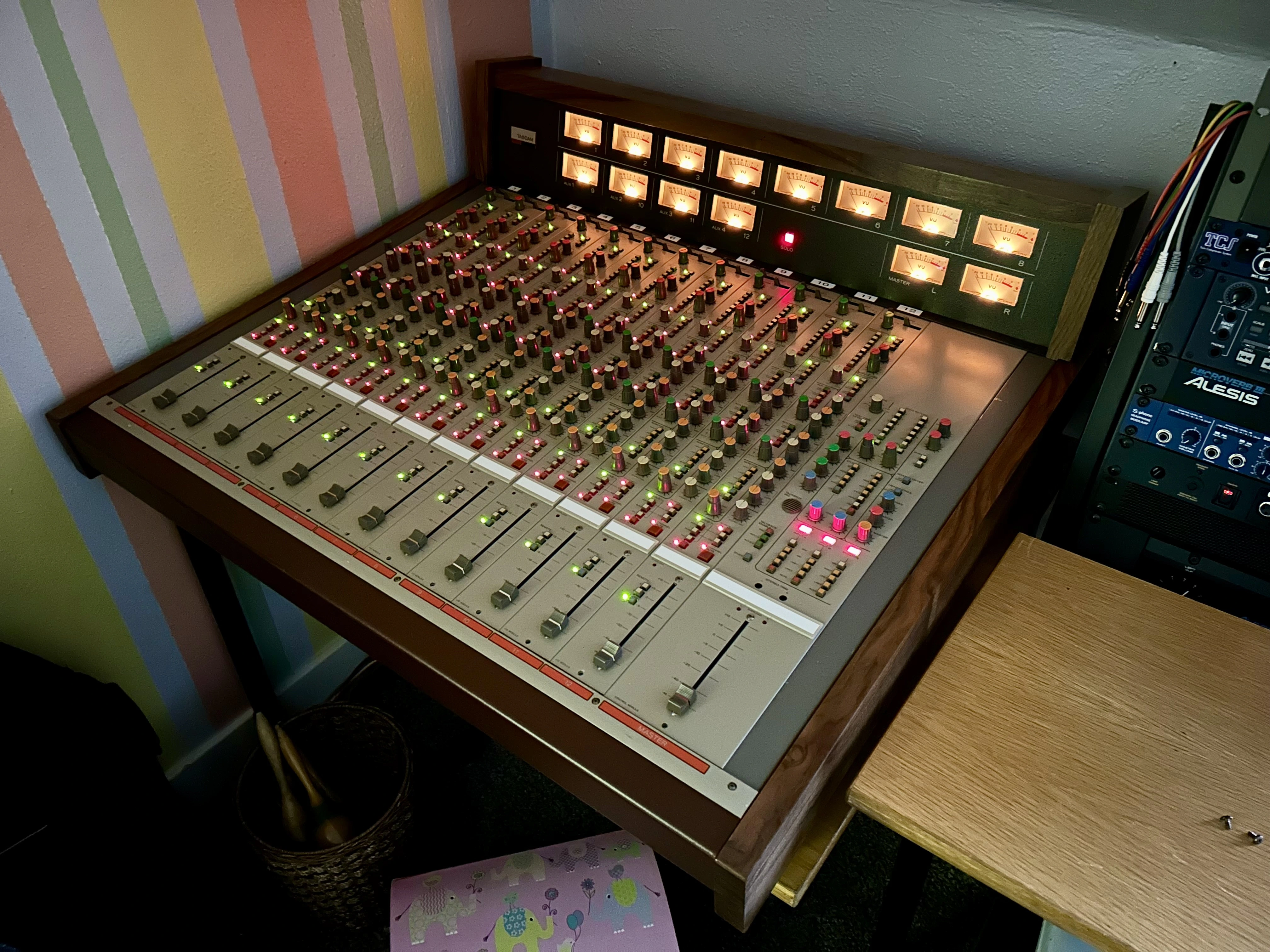

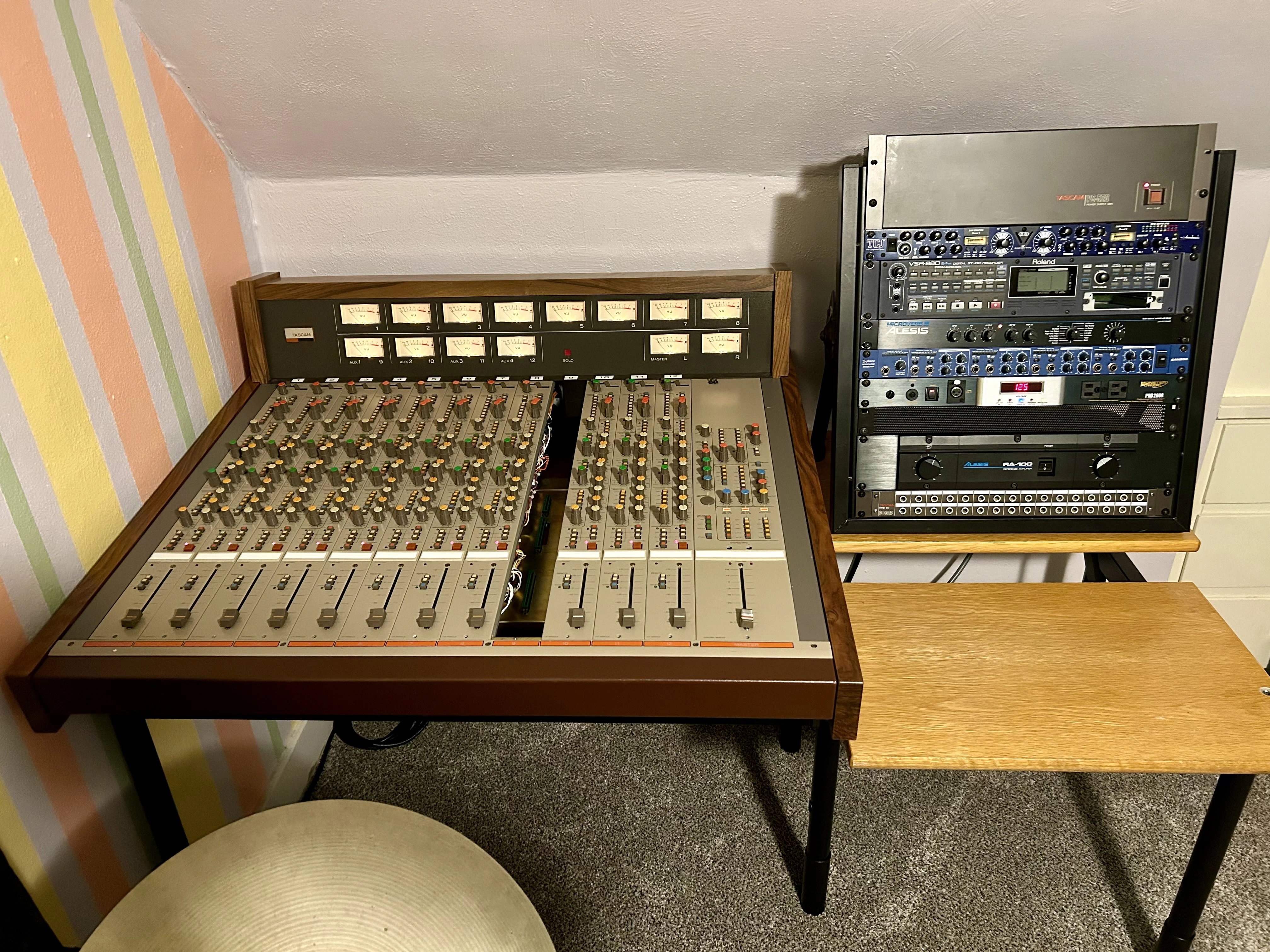

I had a little trouble locating all the hardware for it to mount everything back together. That led me to the question how long was the module in pieces. I recollected I originally took it apart in order to do some collaborative reverse-engineering of the EQ module. And then I was, like, sheesh…when was *that*…I looked back in emails…over 6 years ago. The console hasn’t been all together in over 6 years. So, for the first time in over 6 years, here’s a pic of the whole thing together:

Thanks! I think so too. IMO, in general, the M-50/M-500 series consoles are some of the best looking “budget” consoles from that era…the lines and the color scheme…and the “M-__” prototype console was the advent of that aesthetic and the most impressive visually of the bunch. I’ve commented on this sometime earlier in the thread, but it is an interesting hybrid design-wise having the new aesthetic, and new circuitry, but under the skin the chassis and module structure as well as the motherboard and module-to-motherboard interfacing is straight from the Teac Model 15 and Tascam M-16 consoles.
