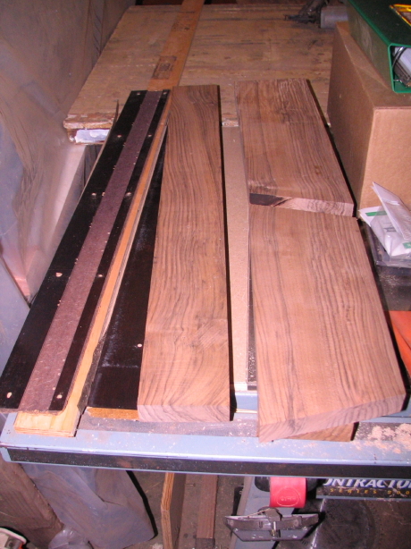

Waiting for the contact cement to cure on the re-upholstered wrist-rest, and I have actually begun fabbing the wood trim panels.

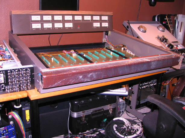

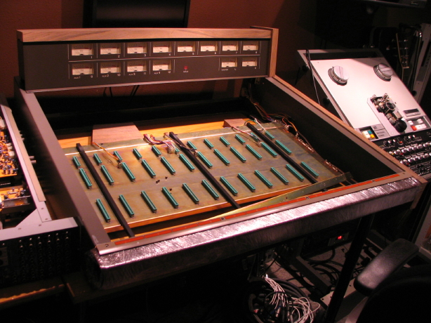

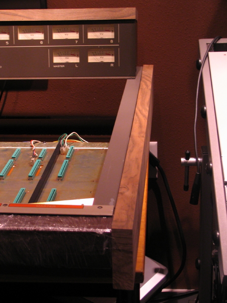

I have been tempted many times to get rid of the panels that came with the mixer...ratty-nasty beat-up panels. I'm glad I held on to them as they have been very useful as hole locator templates. Here are some of the rough trim pieces and a couple of the old panels:
I'm REALLY struggling with how to apply detail, if any, to the pieces...I'm trying to decide if I should chamfer any edges or just leave the squared-off. I was originally going to chamfer select edges to tie in with a 45-degree detail that you see repeated on the screening of the M-500 mixers and many of the rack components from the same era...and present on the M-__ control surfaces as well. But the M-__ has such a chunky square look to it as well...not sure. Looking for opinions. what would you do?

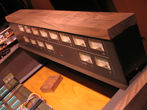

Have a look...here it is with the meter bridge top panel and one of the side panels:

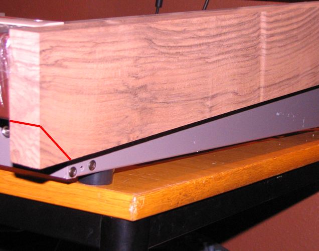

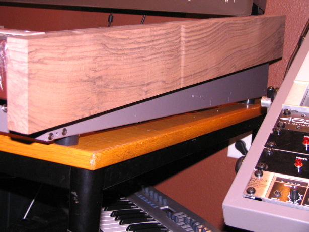

Like that last one, the one showing the side panel, I'm trying to decide do I just leave it a rectangle, or do I cut a 45-degree section out right there just below the wrist rest?
And should I leave all the edges square, or chamfer (bevel) some of them with a 45-degree cut to match the screening detail on the control surface?

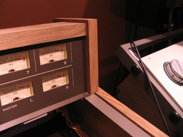

Here are a couple shots with the roughed meter bridge end panel...trying to decide what to do there too. The way it works out I think it'll stick out further than the face of the top panel, so I'm wondering then if the tops of the meter bridge end panels stick up above the top of the top panel the same amount that they protrude out from the front...
Sorry...I realize that my questions juxtaposed with the pictures may not make a lot of sense...hard to describe without being in person...maybe I should shoot a video...

Yeah, the more I look at it the more I'm thinking the same thing...no beveling. BUT...what about at the bottom front of the side panels? Below the wrist rest?
Speaking as a woodworker...maybe a small radius like an 1 1/2" at the bottom front of the side panels would look better and also serve to eliminate the sharp edge that might catch someones head that was working on rack gear below it.
Thanks, Jeff!
In the mock-up renderings I did a few months back, I included a cut where you indicated with the red line but it was on a full side panel dressing, not the semi coverage straight board. So, I'm not sure about that one.
The safety advice offered by tape4reel is valid but I'd probably want to do another mock-up first of that to have a better idea on how it affects the overall look. Give me a bit of time to do a quick mock up of that and then we'll see.

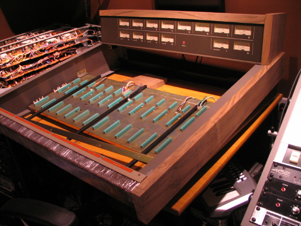

Here's the mock-up cut...
Doesn't seem to do anything negative to the look, so I'd probably green light that.
Cheers! :)
to tape4reel's comment, yeah I will likely crank my head on that corner at some point if I leave it as-is, but I can't see doing a radius...there is simply nothing rounded about this mixer.
Jeff, thanks for doing the mock-up. I was secretly hoping you'd do that...heheh. :D
that being said, I actually don't like the look, safety concerns aside. I'd have loved to fab full-coverage side panels but I just don't have the material wide enough to do it. So what i'm putting on is a compromise between the "factory" panels and a full-coverage panel, as the walnut is significantly thicker and a little taller than the stock panels...at least they have a bit more "chunk" to them. But with the rake of the panel (in matching the control surface), and the top and bottom edges being parallel, the side panel screams "i'm angled like this, so deal with it.". Then with the 45 cut I think it confuses the blatant position of the panel. It just looks confusing to my eye...takes away from the statement the panel makes without the cut. I guess i'm just thinking the uncut rectangle-shaped panel justifies itself, abating the argument or question in my mind "why didn't you go with a full-coverage panel?". Because the rectangular panel provides more visual tension since the lower line follows the rake of the control surface...and i didn't have wide enough material...heheh. The OTHER point is that the M-500 mixers have a plain rectangular panel...clearly the fact that the M-__ was made with a similar panel reinforces its connection to the M-500 mixers and i want to maintain that element. I WILL be every so slightly putting a radius to the edges both for operator safety but also to feign damage to the panels since those sharp corners are easily dented...though this wood is HARD. Just a slight radius.
Given the wood pieces you have to work with, that all sounds reasonable. Though I might suggest shortening up the side panel height to more closely match up to the M500 series side panels and that way, the lack of the corner cut will be less of reminder of its possible need.
Cheers! :)
If I shortened them up that much the side panels would be shorter than the "stock" panels though...the "stock" panels are about 3.5" wide, the walnut panels are about 3.75" wide. In order to negate the need for the angle "safety" cut at the leading edge of the side panels (below the wrist-rest), the panels would have to be about 2.5" wide, which is how tall the wrist-rest is (2.5" square steel tubing). So even the original side panels hang down below the wrist-rest which I think you can see if you go back to the pics in the first couple pages of this thread, IIRC. I really don't want to make the side panels more narrow because any reduction of any dimension will reduce the "chunk" factor...and there is a link from the side panels to the meter-bridge top as that is made from the same dimensional material and the meter-bridge top HAS to be that deep or it doesn't cover the chassis.

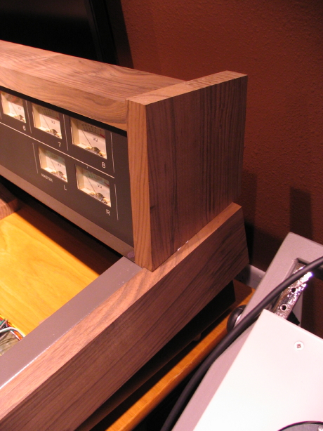

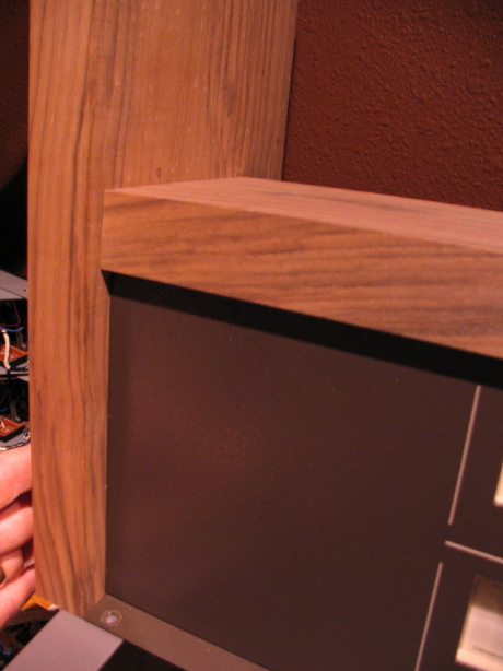

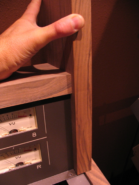

Made some advances on the meter bridge end panels...need to make a final cut as far as the depth of the panels, but I'm pretty sure I just want to flush them up with the back edge of the side panels on the frame, like here:
But I'm not sure.
Here are some other shots of the mock-up at this point:
