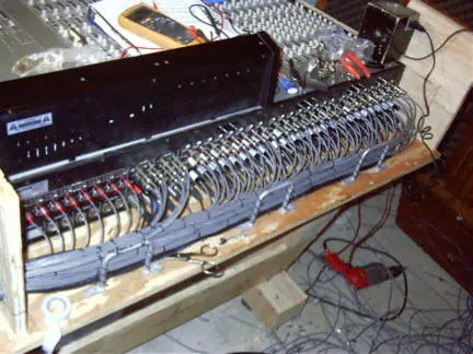

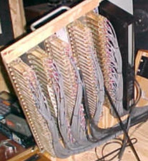

You mean like this?:D
For those of you contemplating this task, look at this cable..
PP3746 - PRO POWER - CABLE MICROPHONE 3MM BLACK 100M | CPC
It is very easy to terminate having a foil shield (better RF proofing than braid) and drain wire, being just 3mm diameter, bundles of it are not so hard to manage. Cheap too!
You can also save money on jack plugs. Get the plastic cased variety for line conns and use heatshrink sleeving to beef up the cable retainer.
Naturally I do not suggest such economies for "free" mic leads or stage work but for behind the rack statics? Fine and electronically just as good.

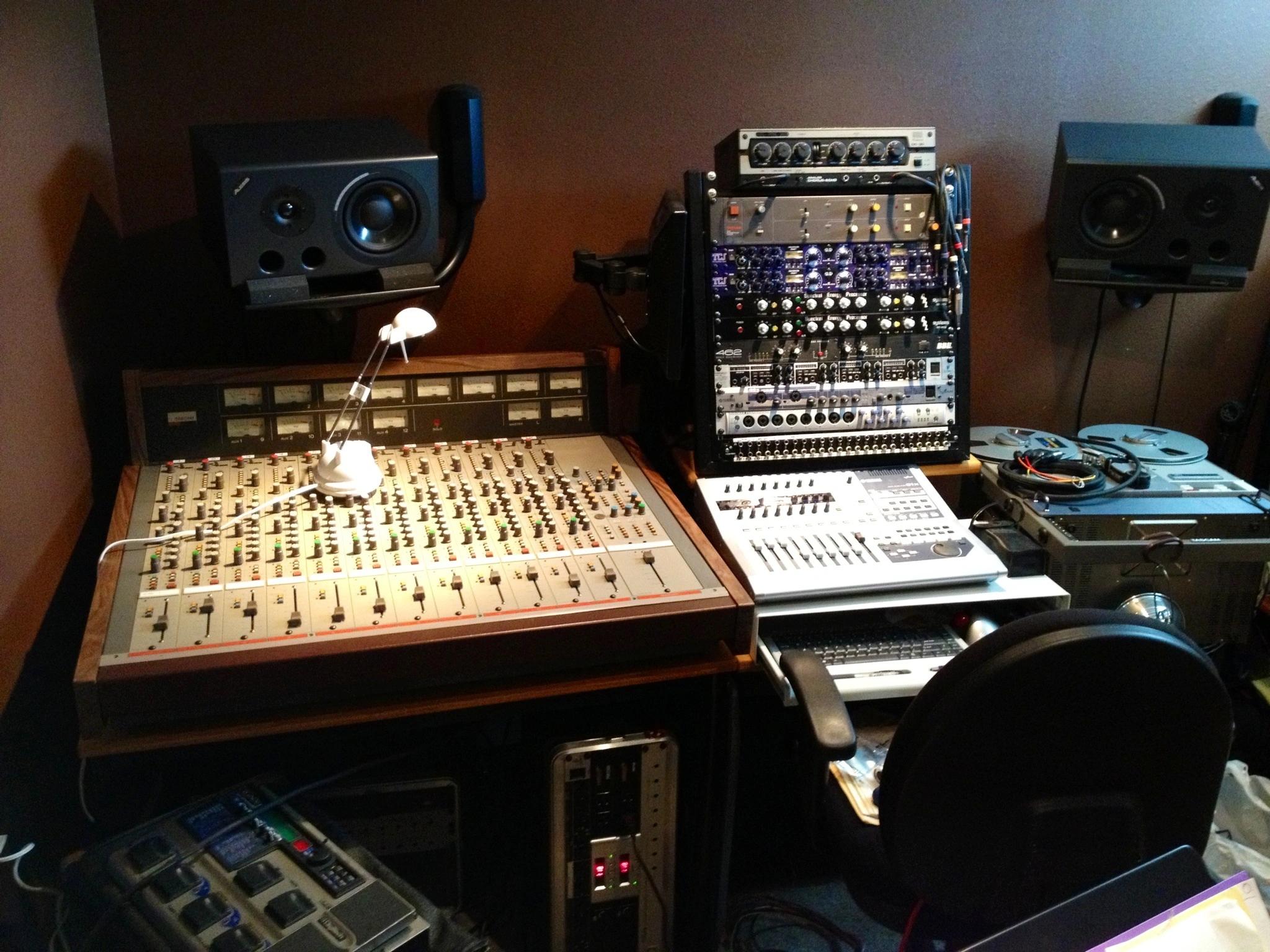

Finished converting 8 channels of one end of a 16 channel snake from TRS to XLR-F and plugging it up. The Ampex MM-1000 is officially hooked up to the Tascam M-__.
Just have a 12-channel TRS to RCA snake to plug up between the mixer master module and the patchbay.
