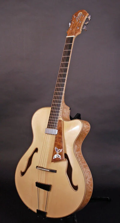

Have you ever played an original D'Angelico? I used to have a 1941 Gibson L-5 Premier. There was a guy that wanted to compare his New Yorker to my guitar just to see the difference. Because the D'angelico was a deliberate copy of the L-5, the guitars were very similar in appearance other than finish and decoration. The L-5 was the better guitar for single string work having a better upper mid-range, but that D'Angelico was like heaven for comping jazz chords. It was incredibly warm and still had amazing note definition. I still prefer the D'Angelico style A and Style B to the New Yorker. Those older models had more character. I only posted this because I don't get to talk about those guitars often. I don't want to sidetrack the thread.

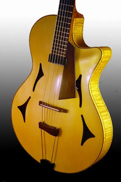

I'm throwing one more drawing up before we start to narrow the field. This one is very much the direction I'd like to go. Still not happy with the bolts, but I'll keep trying. I've upsized the body to 16" for the lower bout. This guitar is the same size as a 335.
................................ Seriously though I would've taken a different path altogether. The guitar I'd like to see multi build would resemble a D'Angelico New Yorker, but the size and scale of a thick bodied ES-125. With a rhythm chief at the neck, and a P-90 at the bridge.
Trouble is those are the sorts of guitar that I build for a living. I don't want to go that route... This is about building a guitar that is the combination of many thought processes and the inevitable compromise.
I can see you and I would get along just fine.
I'd have the D'Angelico for for swing gigs and the Gibson for Jump Jive. If I had to choose just one D'Angelico every time...
The sort of thing I build and play myself tries to bridge that gap... Both inspired by but nothing like D'Angelico or Gibson. Thats what we need to do here. Take inspiration and move in our own direction.
