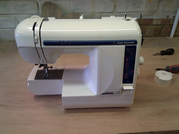

Start with a sewing machine. This one is beyond economic repair and has lived under our stairs awaiting this day.

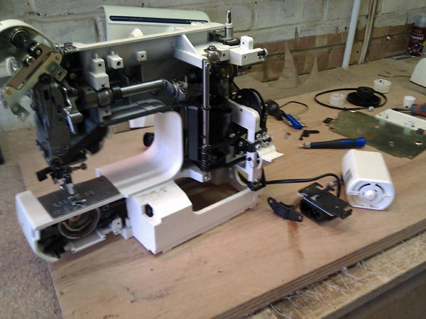

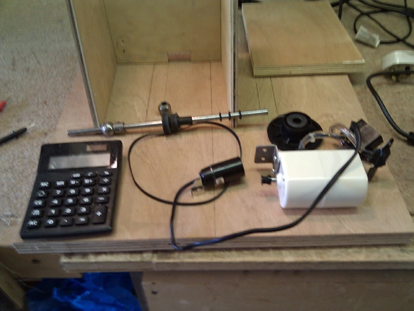

Rob out all the parts you need and put the rest in the "save for later" bin..

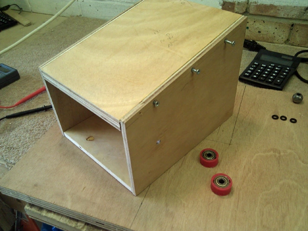

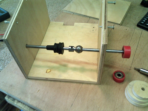

Make a box that will house the motor, spindle and bearings as well as the counter and leave enough space for later additions.

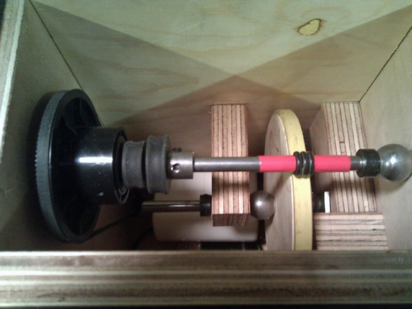

Start assembling the main drive spindle which will hold all that we need inside and out.

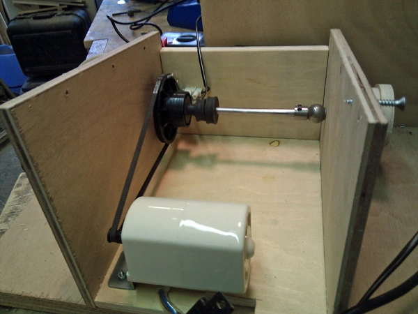

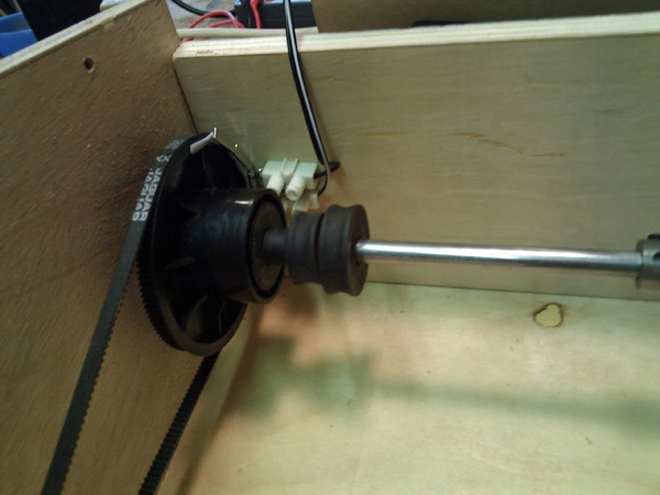

Once all the components are on the drive bolt in the motor and put the belt on..

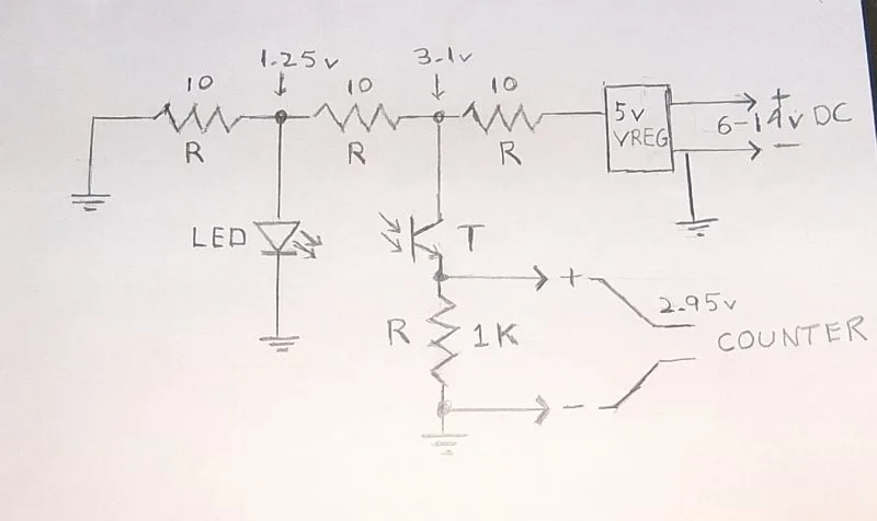

A reed switch and magnet are fixed to the drive wheel to do the wind counting. I've hacked an old calculator fro now but this system is only good to about 350rpm. I need to go faster so will be looking a photinterrupters as an option next.

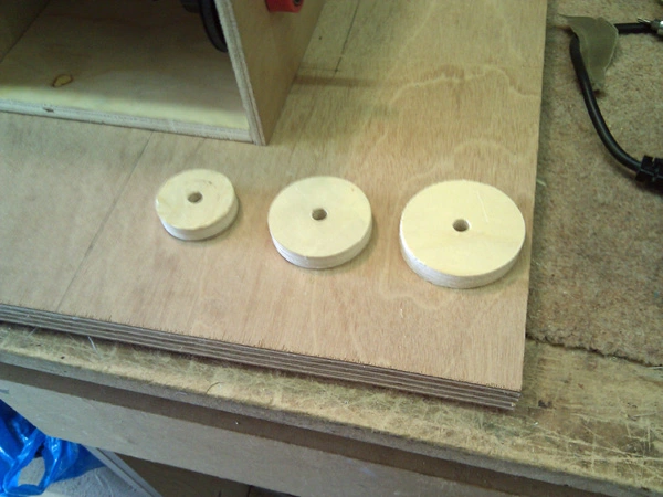

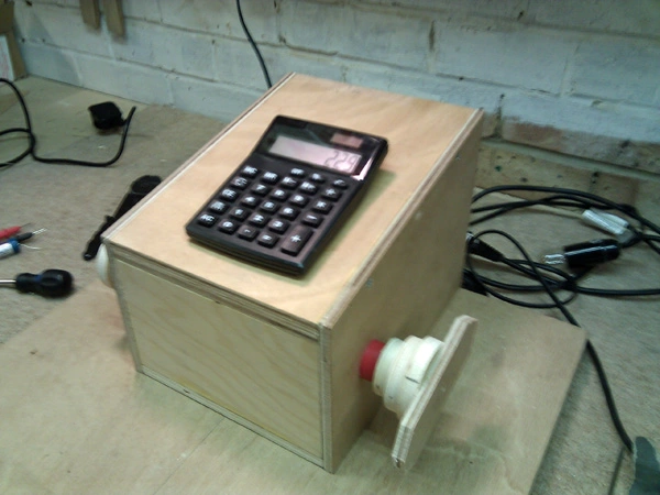

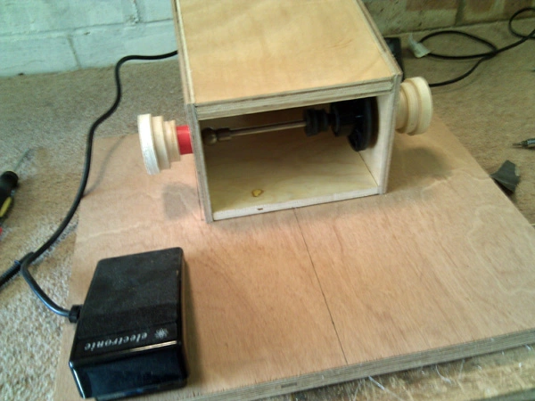

The finished box with the plates mounted. I just used a three ply circular discs cut with a hole saw and glued them. This give a very stable and true face plate which is important when running at speed.

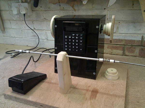

The thing so far. Hopefully I'll be able to run up a video of it in action. I'm off to watch the footie with my boy tonight so nothing more til tomorrow.
The red bearings are some old flange bearings that I robbed from one of the kids scooters... I knew they'd come in handy.
