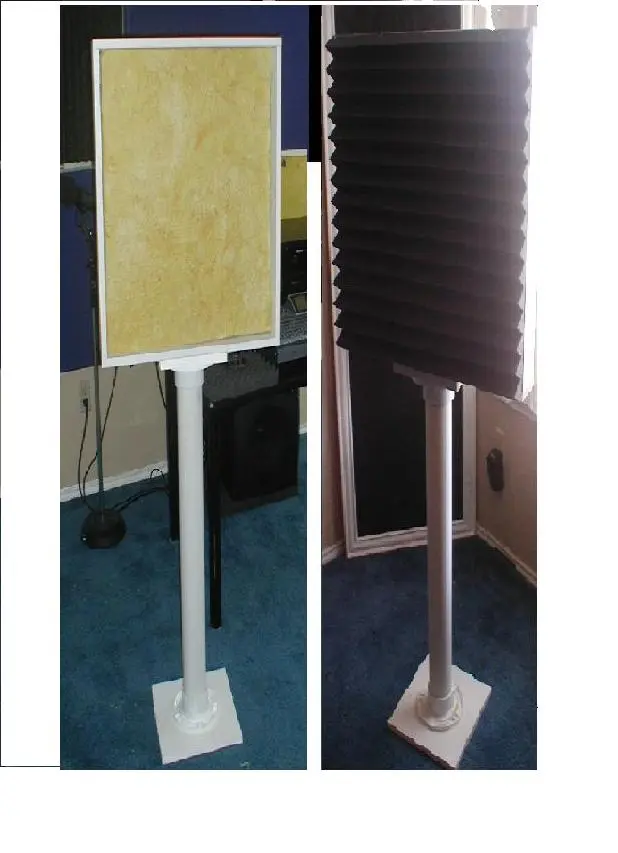

Here's a new DIY..based off the famous PVC speaker stand.
"Mini E" traps named after Ethan. :)
Recipe Each:
1/2 703 $
1/2 Auralex foam front piece $10 (optional)
1qty 8ft 1x3 $3.50
1qty 2x2 1/4 plywood $2.36
plus screws and nails.
Basically a 2x2 box with a solid 1/4" plywood back and Auralex foam on the front...altho you could just use cloth and save $10.

Thats a cool idea man...making them portible and all. I saw some company that had these round ones....they were on stands but huge cylinders... I just re-formatted my pc...and didnt save a copy of my favorites...so i dont have the link. :D O well... I'll have to try that. Are they effective? This would please my parents alot more than putting things IN the walls!! LOL :D
thanks, it was a bit of un-planned fun while i was "optimizing" my monitor placement. i had a window and a wall (1st side reflections...see realtraps)
and stands..hmm? :rolleyes:
yes its good stuff...the 703 is well "approved"...the auralex is too..i had it laying around. better than nothing...is my understanding.
you could make one different for your application, thats the DIY way! :)
as far as do they work? i've never gotten a clear signal on any of this SPL stuff. nothing is technically perfect...but its something...it offers reference values. but there's so many variables, someone can legititimetly question everything. :confused:
in the end, your left with your ears and what you hear it to be.
the nice thing about portable of course is you can move it around.

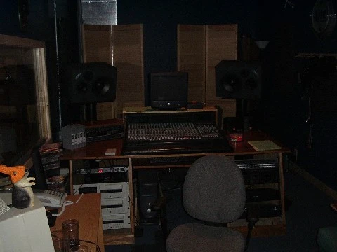

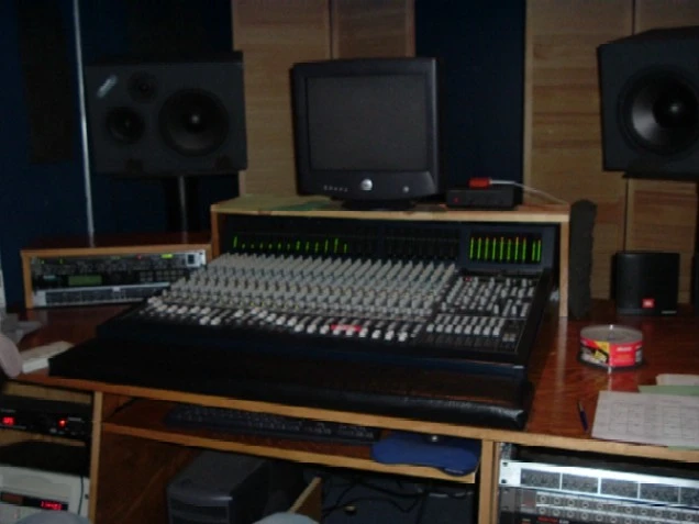

I DIY'd this desk and the monitor stands
Here is a few DIY things that I have done. Desk and monitor stands.

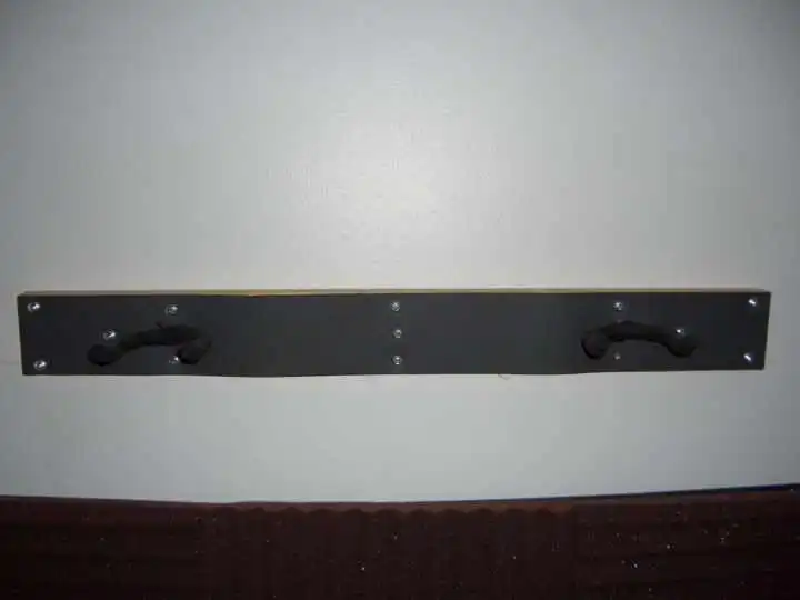

Guitar Rack
This is my first attempt at the DIY thing.
It's not so pretty, but its functional...... :)
