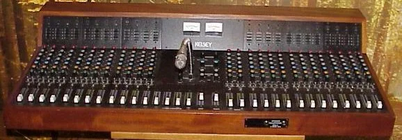

I've got a question for some of you guys who are more knowledgable about electronics. I'm just a tinkerer, myself. :D
How feasable would it be, to use some of those little amplifiers to power headphones? I mean - for $15 to $20 per channel to power Headphones - that's not bad (essentally build one little amplifier kit for each pair of headphones.
One of my questions is - if you were to do this - how would you figure out what size power supply you'd need to drive them all?
I've done things like - I have some old Omnicraft noise gates (GT44 I think is the model - they are orange and black) and I installed 1/4" TRS jacks in them, with the send and receive on the same jack - that allowed me to only have to drill 4 holes in the back of the case, and could plug them directly into my TRS inserts on the mixer for live use.
And I have rebuilt 2 mixing boards - but any monkey could do that if trained right. LOL I just repalced parts with the same kind of parts - I didn't really learn anything other than 6 months of soldering on a 24x4 channel board kind of sucks. (It was an Old Kelsey that I totally rebuilt, a friend helped me electronically split the board into a pair of 12x4 boards - so that we could use it for 8 track. We just cut the busses in the middle, and he made a little gain stage panel with knobs on it to control the volumes of the busses.)
Actually, even though it was an old cheap mixer -I kindof liked the sound of it, although I would have liked to have lowered the Q of the Lows on the EQ section.... but I don't know enough about that.
This isn't my mixer, but it's the exact same model.
Thanks,
Tim
