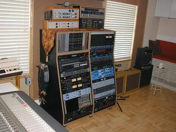

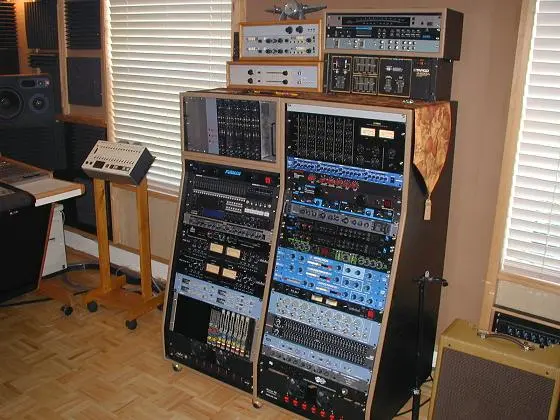

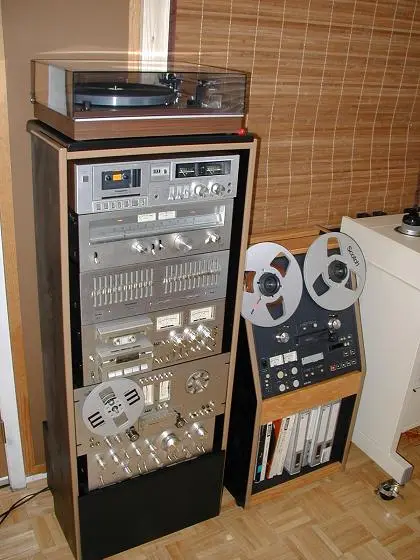

You guys ROCK! Thanks! Im no expert but i like to share what little i do know! Frederic, I'll contact you soon. ( like your work space!) I built my own 2 bay racks, 2 track and stereo equipment racks out of wood. If anybody wants plans, let me know and I'll draw some up and shoot them to Fredric. You can make the 2 bay a 1 bay EZ! See pics.

All Rise!
You are currently in the presence of greatness. Mucho nifty! :D
Damn... Wow, that's all I can say... Other than the fact that my rack has corner trim peices lieing next to it, I think you've got met beat.... by a long shot -- equipmentwise and constructionwise.
Looks like good work man!
Jason
That would be grat Jeray.... BTW, nice racks. Totally professional looking.

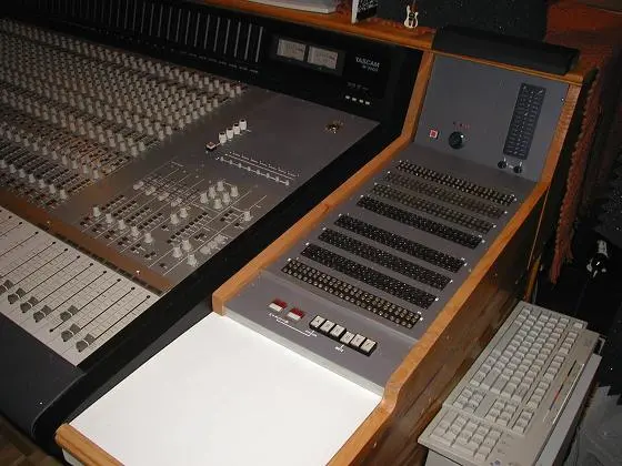

Well, time to bump this thread :D Hello everyone. Well, its been a little over 2 years since I moved, the studio being the last on the priority list of shit to do. First was the shop..of course. Can't build anything without the shop. Then Winter stuff. Then honey do's :D and finally, the studio. Actually, I've had my console in the room for the whole time, but its been a total disaster, and still is.
But I finally got a few projects on the way to being finished, so then I can go on to the actual room. First was finishing up the console, which is what this post is about. Since I've became a member here, a lot of shit has happened, and priorities have changed, drasticly. Age, jobs, health, money, time and family have all taken their toll on my dream. I started this dream in the 80's, and have had at least 10 incarnations of my dream. Folks, this is the LAST one. :rolleyes: I can't put another dime or too much more time into this. What it is now, is a place to enjoy listening to music, doing a little recording, some CAD work, and its my office too. I came to the conclusion this is solely for my own enjoyment, so I don't have to please anyone but myself. No isolation, just some treatment, and the room the way I want it.
Which is why there are elements that only "I" will like. Well, on with the show.
Here is the plan, the console as it is now, and the point of the post. Some pics of the console belly cabinet, which houses two computers, the patch bays, an amp, various cable chases and the digital audio/midi interfaces to the computers. Actually, my studio is a hybrid of analog and digital, having two synched Tascam MSR-16's and a Tascam 42b mastering machine, with a Studiomaster 20/8/2 mixer, as the core of the Analog side, and a couple of Tascam TDM-1000 digital mixers and a Lexicon Core 32 digital interface with a
PM-90 daughtercard with is a Lexicon computer card for reverb/fx. I have a bunch of other stuff, but thats not what this is about.
folks, I'm a DIY type guy. I love to build stuff, and I've been tinkering and modifying this console for over 10 years. There are lots of things to still do to it before finishing. But I've got most of them in various stages of being done. The hardest, was the ISOLATION boxes for the computers. Thats what this post is about.
I actually built the main box about 6 years ago. At the time, I didn't have time to completely finish it, so it sat under the console with NO iso for the computers. Then one day last week, I listened in the quiet dark to how loud these stinking computers really are. DAMN! That was it, I tore the cabinet out and hauled it down to the shop. There, I took an old piece of black melamine, and added an extention box on the back to completely enclose the computers. I've ordered 6 12v fans, three for intake, three for exhaust. For now, I've just finished lineing the two cases with 1/2" 703, and cutting in 4 isolation/vibration dampener pads for each computer, through the 703. I tested the weight last night and they work great. NO vibration to the exterior case. The case has two intake fans with (2) 180 degree air plenums, that will push air into the cavities, and a seperate exhaust fan plenum that will bleed off the exhaust from both power supply fans. The entry and exhaust ports to the plenums are through holes drilled through the bottom of the case under the plenums. Anyway, here are some pics showing what I'm doing.
In the next few weeks, I'll show all the other little and big DIY projects for my studio that are built, but not installed yet. Like the tape machine fixtures, speaker soffet frames, and various other things. Damn this stuff takes time, which I have so little of. No wonder it has taken so long to do this. Well, here goes...This will take 2 or three posts to show whats already built, and then the belly iso box. Bear with me. Afterall, this is the DIY thread......right? :D
