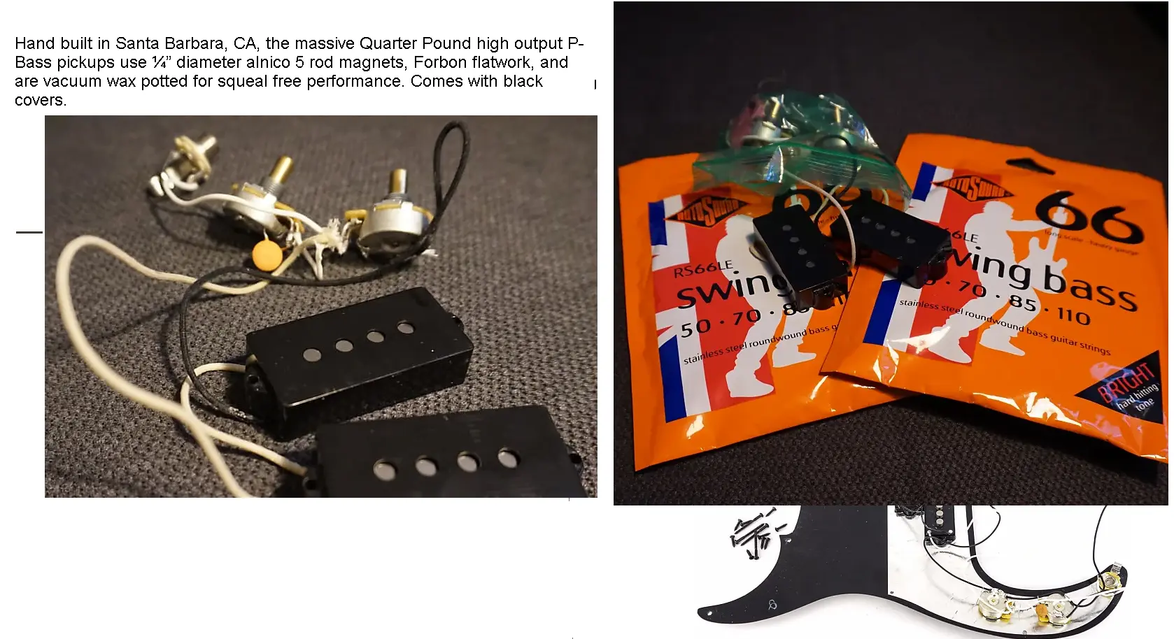

I went to swap pickups on the Squier Affinity.
Some dude sold two packs of bass strings and tossed in the SD Quater Pounders and had the full control wired in....for $40.
So in my accounting mind, the two sets of strings were worth the $40. So the pups were about nothing and the control-set, I looked up pictures and appear to be the All Parts kit, which is $17 new, and includes Switchcraft jack and both pots and the cap and cloth thick wires.
Negative point for the Squier is the pickguard is very odd and forums post about nothing fits the Indo Affinity, so if the screw holes dont line up neither does the pickup holes etc...so you have to grind and cut....something to think about if doing DIY.
Negative mentioned upthread is also this Squier Aff INdo has the "mini pots" so again large normal sized pots wont fit without drilling the pickguard and possibly tight fit in the body routing.
Positive- most companys like Bourn pots have "minis" available too.
Recorded a jam with the old stock pups and then with the new SeymourDuncan Quarter Pounders SP3 ....
Ok the Quarterlbs were louder about 6db for my setup, height. But sliding the Reaper gain added the volume to the stock-pups.
Then tone....the stock pups are smoother, mellow less clarity but sound fine, many would choose that probably. Cort supposedly copied the vintage Fender pups in some ways. The Duncans 1/4lbs...were clear and thick and speak for themselves, they dont need my inputs, a US Made Top Seller for SDuncan and etc..etc..
Now my 2cents I dont think for a Squier PBass the pup upgrade does much, if I had paid $100 for the Pups. The volume and tone can be touched in the Reaper so volume and some treble could closely match that "sound". However if you wanted the 1/4lb sound without tweaks its built in.
Again I got these used 1/4lbrs free basically, so there was no cost added to the Squier $150 PBass. Spending $100! on this guitar seems kind of odd because then its at $250? and a brand new Squier is $299.
Unfortunately Im not drilling and routing anything to try the difference of the AllParts control kit, due to the Squier pickguard having mini holes. (and Im lazy today)
If someone wanted a smoother vintage tone, seems a set of strings like the HalfWounds or Flats could do the same as a pup change. imo...ymmv
Those are some heavy strings @ .110 - they may not fully seat into the nut, so keep an eye on that when you start winding them up.
