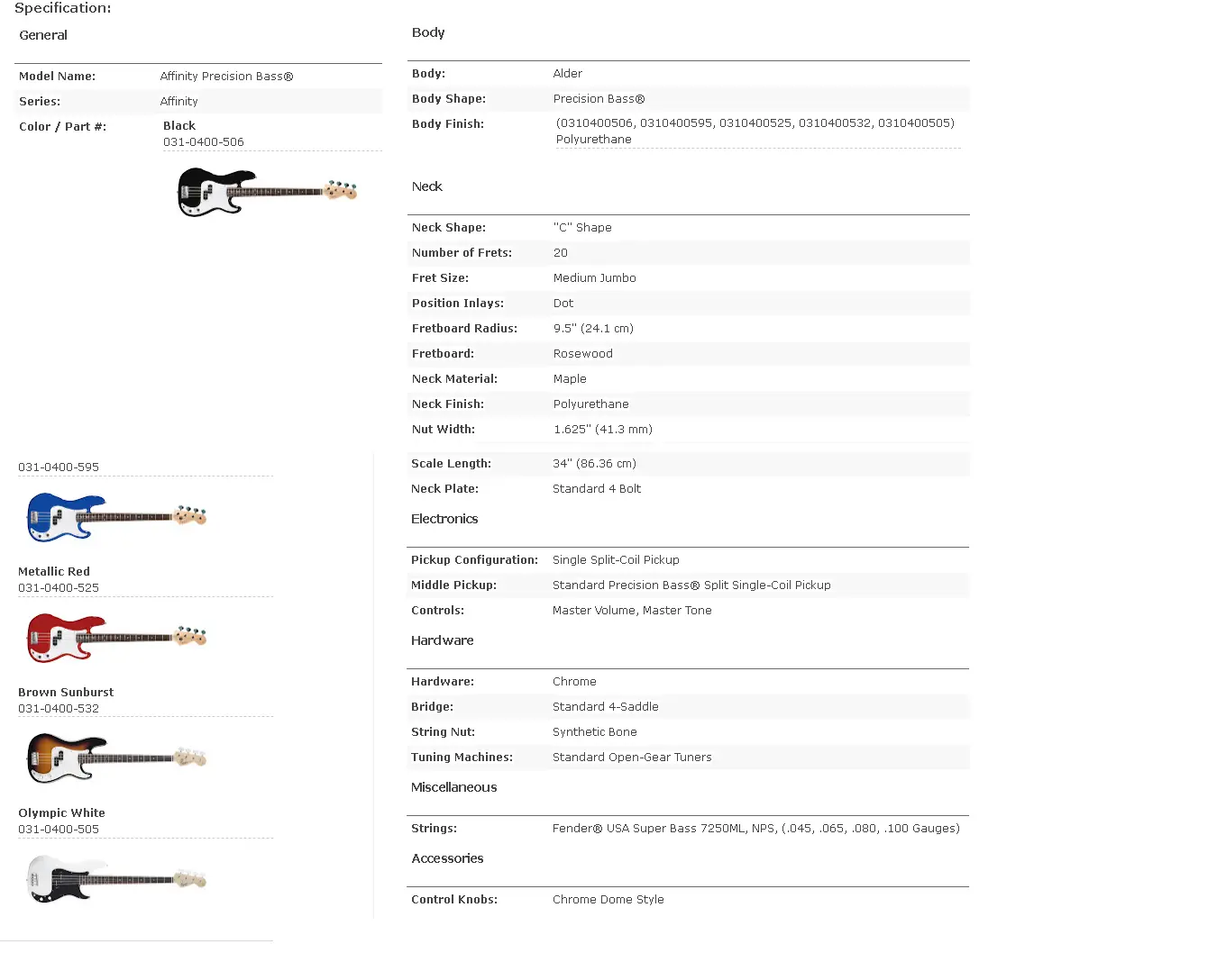

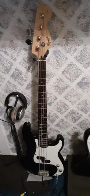

I grabbed a Precision Bass, Squier. 2002, Rosewood neck, plays really nice.
The Squier S/N shows IC02 xxxxxx....Indonesia CORT factory w/ CNC, woods builder for many many companys etc.
02 for 2002, and a 20th Anniversary plate to show Squier is 20yrs old, for Fender.
paid $150 for this thing

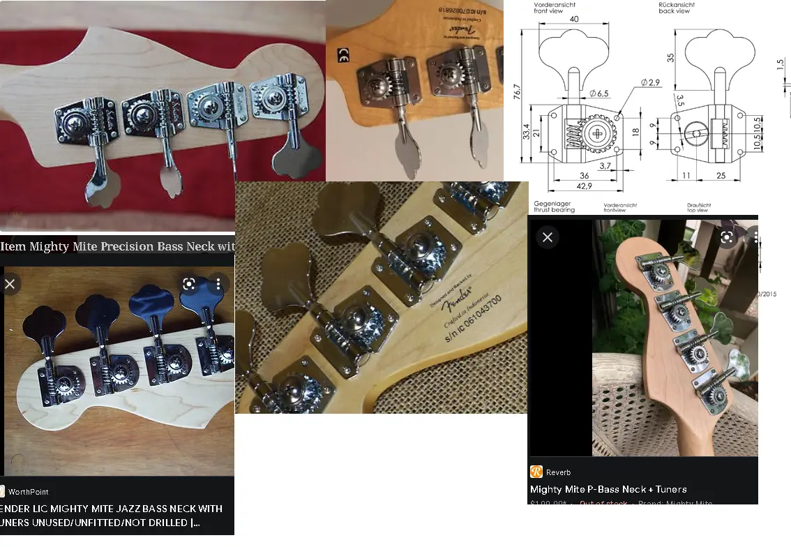

*The Tuners and hardware suspect to be secret (mighty mite) and looking at pictures, some Shcector mighty mites look exact and with the same quantity of teeth and forensic viewing showed same (but without any stamps= generic) ssshh. No one can convince me they arent at this point after I counted all the teeth on the gear and measured the tuner and holes, exact copy, twins?

Through rabbit hole reading details and todays setup ....other than the sticker on the headstock, theres nothing really "cheap/bad" about this thing.
I am fine with the lighter body and kind of like the slightly smaller neck/nut
US Jazz 38mm
US P Bass 43mm
Squier Affinity P Bass 41.3mm
