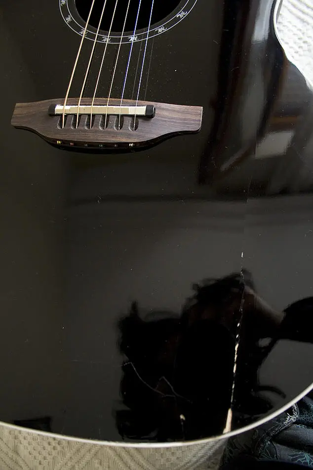

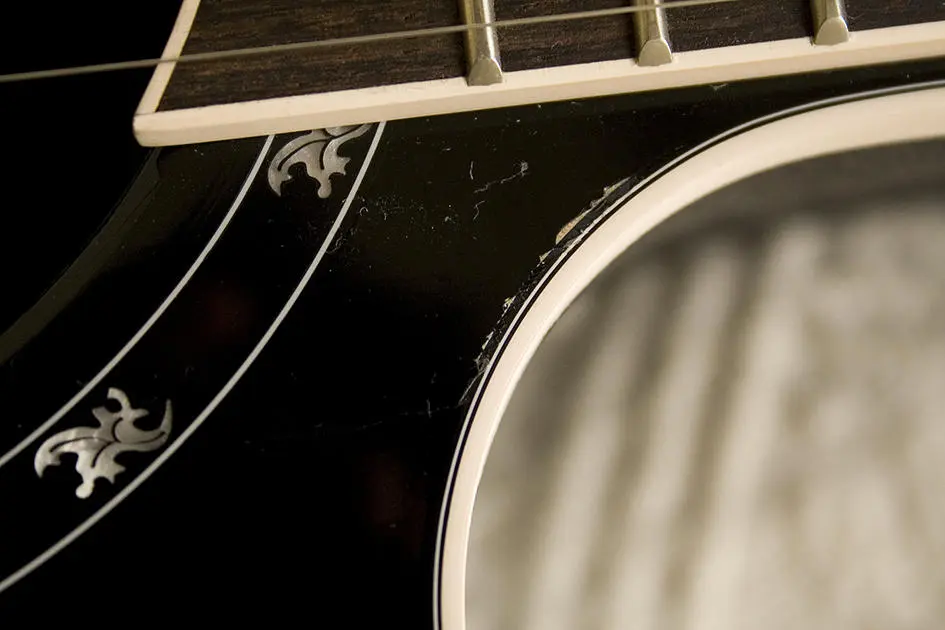

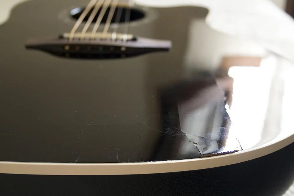

The top wood is cracked, and is not connected to the bowl at two points. One at the bottom (point of hit) and one at the cutaway (opposite of point of hit). The vertical crack goes as far as the bridge and the opening at the cutaway is very small (~3 cm) while the opening at the bottom is quite large (~25 cm). And here are couple of pictures..

That should be fixable, can't tell you much more than that because I've never done that repair on an Ovation. On a normal acoustic, I'd pull the binding on that side, clean the old glue from the seam, glue and reinforce the top cracks then glue it back to the body.
The main problem would be if the glue Ovation uses is not water soluble.
Hopefully someone with more Ovation experience will check in.

Bummer about your guitar but the good news is it should still be playable until and if you get it repaired. I have seen Ovations in far worse shape still in active duty for years and years.

Ouch,
That really is one for a good luthier and preferably an Ovation guy.:o
I have little experience of working on them so my advice here is based solely on what I have gleaned from half a dozen instruments over many years. Sorry but I have to put my hands up when I'm not certain and I really don't like working on them.
From what I remember they have a several different bracing patterns and it looks as if that has not only split the top but it may well have popped of the braces as well. The top block crack I wouldn't be too worried about that will go back OK but the lower bout one really needs to be looked at by someone and dealt with accordingly.
Be prepared for a costly fix and accept the resulting cosmetic feature.
Sorry I couldn't be of more help but if you brought that in to me I would ask how much you were prepared to spend on it.
I wish I could be the bringer of better news and I really hope it isn't as bad as it looks..:o

The popped braces are what I am afraid of as according to my limited understanding they are kind of the skeleton... What I wish from the repaired version is cosmetic flaws (at this point I do not care about that), change in unplugged sound and minor change in plugged sound (the pickups can not pick up all the sounds, right?)

I took some more pictures with a smaller camera. The inside bracing looks OK to my untrained eye.
It may be okay to play but better to be safe and get it checked out. I have a lot of experience with Ovations and that can certainly stand up to abuse and damage, I know several players that regularly use instruments with similar or worse damage that still sound and play fine for many years, despite the looks.
