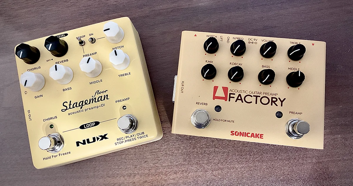

I use a NU-X Stageman floor preamp (left) for my acoustic > SSL12/Pro Tools DAW if I want/need tone control. Otherwise a straight connection to the SSL12 is all it takes.
The Andrew Schopes Omni channel strip plugin is an easy way to craft some tone/correction tweaks on the way in - pretty easy all around.
