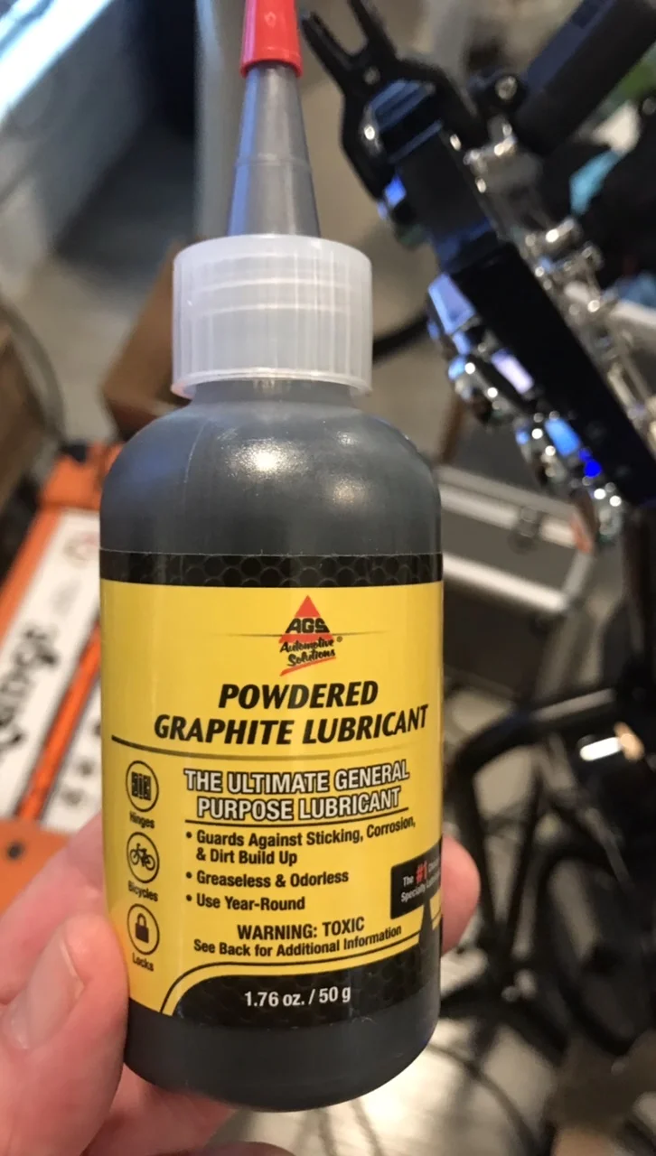

I use this on my nuts.
May not help your issue but it’s cheap and good practice.
