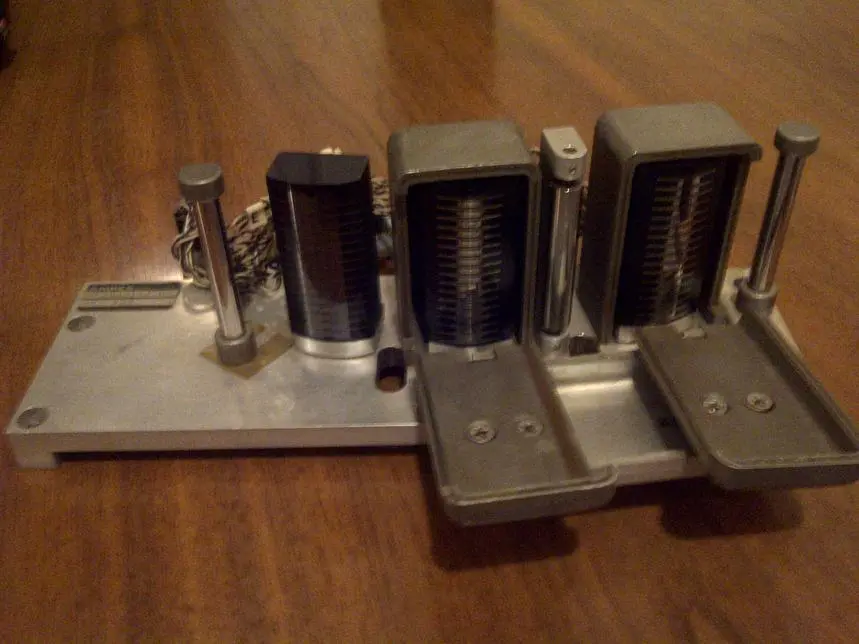

Some bad pics of it...

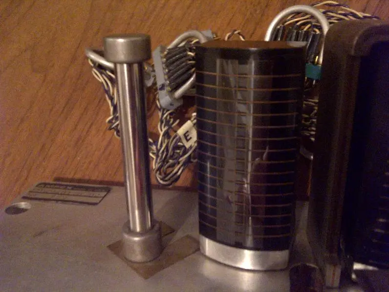

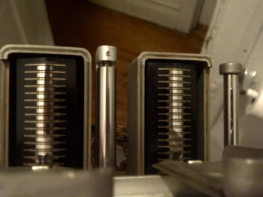

I got the headblock late last week and it wasn't what I hoped it would be. The original supposition from the seller was that they were NOS...that's what they were billed as when he bought them but he had never opened them up. He trusted the source. So he opened them up and they didn't look new but looked good to him. We had a long conversation by phone and I asked him a whole bunch of questions to try and get an assessment of their condition as best I could. We decided to move forward with the transaction with an out if they turned out to be not good when they got here. When they got here it was obvious to me right away that they were definitely used, and maybe even WELL used. I wasn't sure if they'd been relapped or not, and it appeared that the record head had an uneven wear pattern due to an improperly set wrap angle.
Here are some pics of it:
Now, before you start lambasting the seller he has been very responsive since they arrived and is ready and willing to reverse the transaction. He just didn't know what to look for, and he is just waiting for my word. I'M having a time trying to make up MY mind. When I first got them out of the package and saw that the guides had been rotated twice (i.e. three wear patterns), and in need of cleaning, and the aforementioned off-center wear pattern on the record head...I was...disappointed...to say the least, but more upset with myself more than anything. I knew I was taking a risk and I am responsible for assuming that risk.
I checked the coils and there were no open coils (good), though I found one broken head connector wire on the erase head (not too surprising...easy to repair).

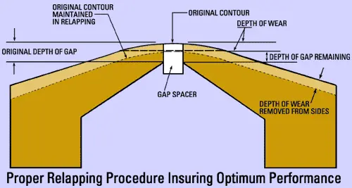

The picture is of a ferrite core head not metal like these Ampex heads but the picture does a good job of showing the gap tip and the tip depth.

So once I could see the gap tip on the 2" heads and could compare to the 1" heads, I came to the conclusion that the 2" heads had NOT been relapped, but definitely had more wear than the 90% rated 1" heads. The 2" heads appeared to still have a decent amount of "meat" in terms of the tip depth, but I wanted to get SOME sort of loose quantifiable determination. I don't have the same jigs, optics and measuring instruments as John French...nor the experience of course, and I have to say that this experience has given me a tremendous amount of inceased appreciation for what it is that John does and can gaurantee. There is a vast amount of particulars to know about each type and manufacture of head. I've got a rudimentary grip on ONE type and manufacture of head and it took me hours and in the end I only have a guesstimate.
All of this studying also gave me the opportunity to inspect the face of each core on both headstacks and they all look fine, and furthermore the tip depth on the reproduce stack looks essentially the same as the record head.
