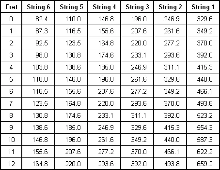

According to post #5 the frequency that is most troubling to the OP is 800hZ.
Before I go any further, let's take a look at 6 string guitar frequencies.
When the OP is playing an open Am chord using only strings 4, 3, and 2 the frequencies are 164.8, 220.0, 261.6 respectively.
I'll grant it that the above chart only shows frequencies up to the 12th fret. You have to go much higher up the fretboard to reach 800 hZ and hear those frequencies.
On the other hand, even though the OP is only playing those 3 strings it is possible that he's hearing the sympathetic, harmonic resonance of an awesome D28. That's the beauty of acoustic guitars! Sorry, but I fail to comprehend his continued dissatisfaction with a guitar he has owned for 16 years.
I know for myself that whenever I play an acoustic guitar for the first time, I fret the D and G strings on the 5th fret. I strum all 6 strings. I listened and hope that I do hear sympathetic harmonic resonances. If I hear that, it's a keeper guitar.
Again, that's the beauty of acoustic guitars. Regardless of brand name, they're all different, good or bad.
YMMV
