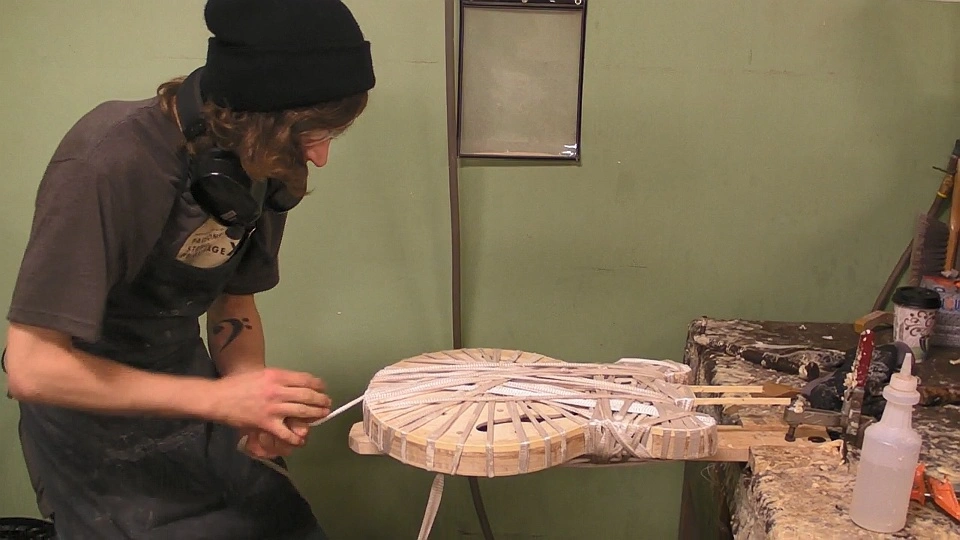

I never got with the rubber band method of gluing binding. We use binding tape. The best glue for bindings is actually superglue, which is what we have used since the 80’s for most bindings and inlays. I think Heritage is using the same type of PVC binding that Gibson uses.

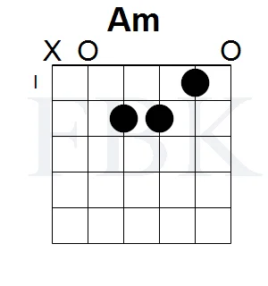

When you say "Open Am Chord" do you mean to say your fingering is
According to your 1st post you bought that D28 in 2009. Throughout this thread you have received a plethora of advice to get to the root cause of your dissatisfaction seemingly to no avail.
Yeah.
