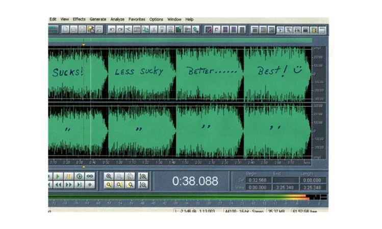

HAHAHAHAHAHahahaha...
You know I use the same software, right? I've got it on the same screen settings too, and I sat here for a second thinking, "How the FUCK did that guy get a screen shot of my session?"
:D :D
Louder is better, I agree...hehehee.
:D :D
Took me a whole fuckin hour to figure out how to do it.......but it was way worth it, considering your reaction..........LMAO:D :D :D :D :D
