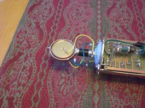

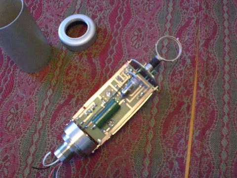

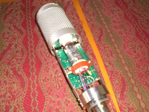

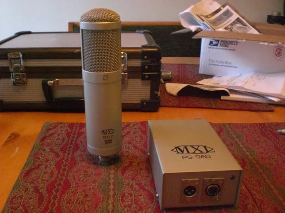

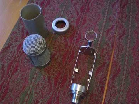

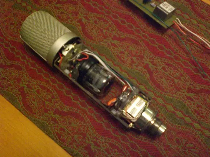

Before gutting. This is what comes in an MXL 960. A good mic in it's own right.

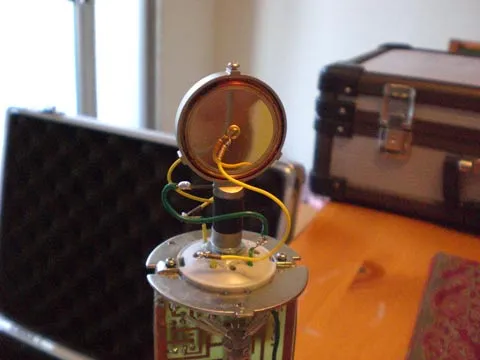

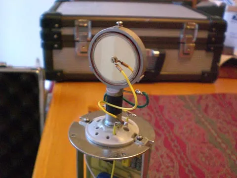

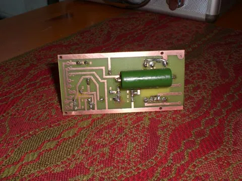

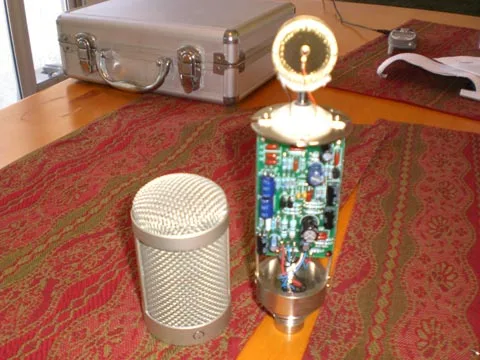

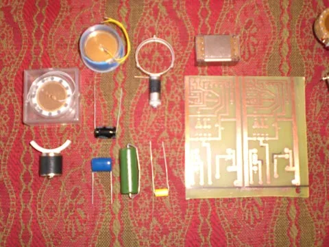

Some of (but not all) the parts.
The white ringed capsule is the Peluso that went in my TCM1050.

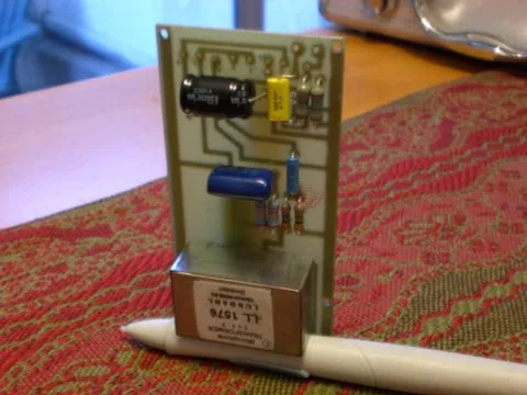

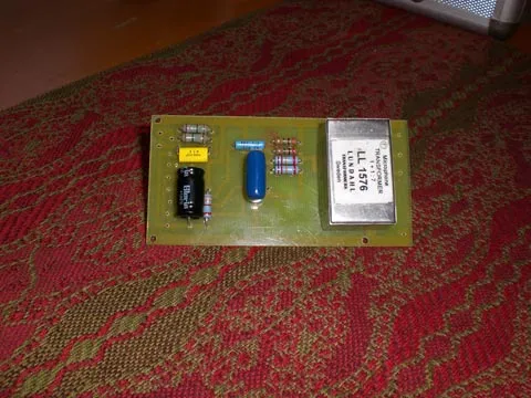

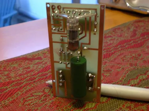

Stuffing the board. Love the massive paper-in-oil output cap.:)

Yes. I had to change the zener diodes to get the plate voltage down to 112-120v. I also had to add a resistor at the filament because it was almost up to 10v.
