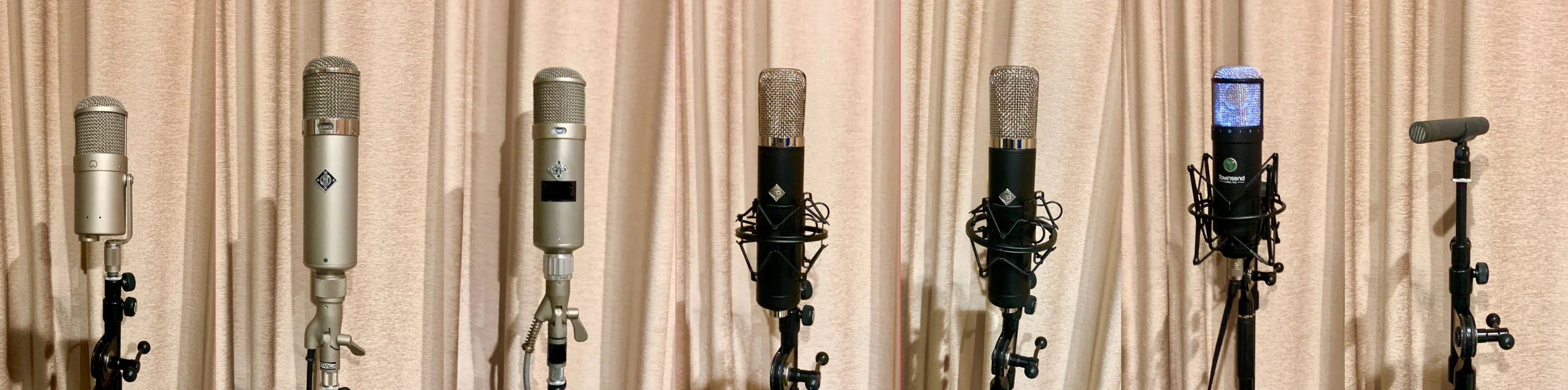

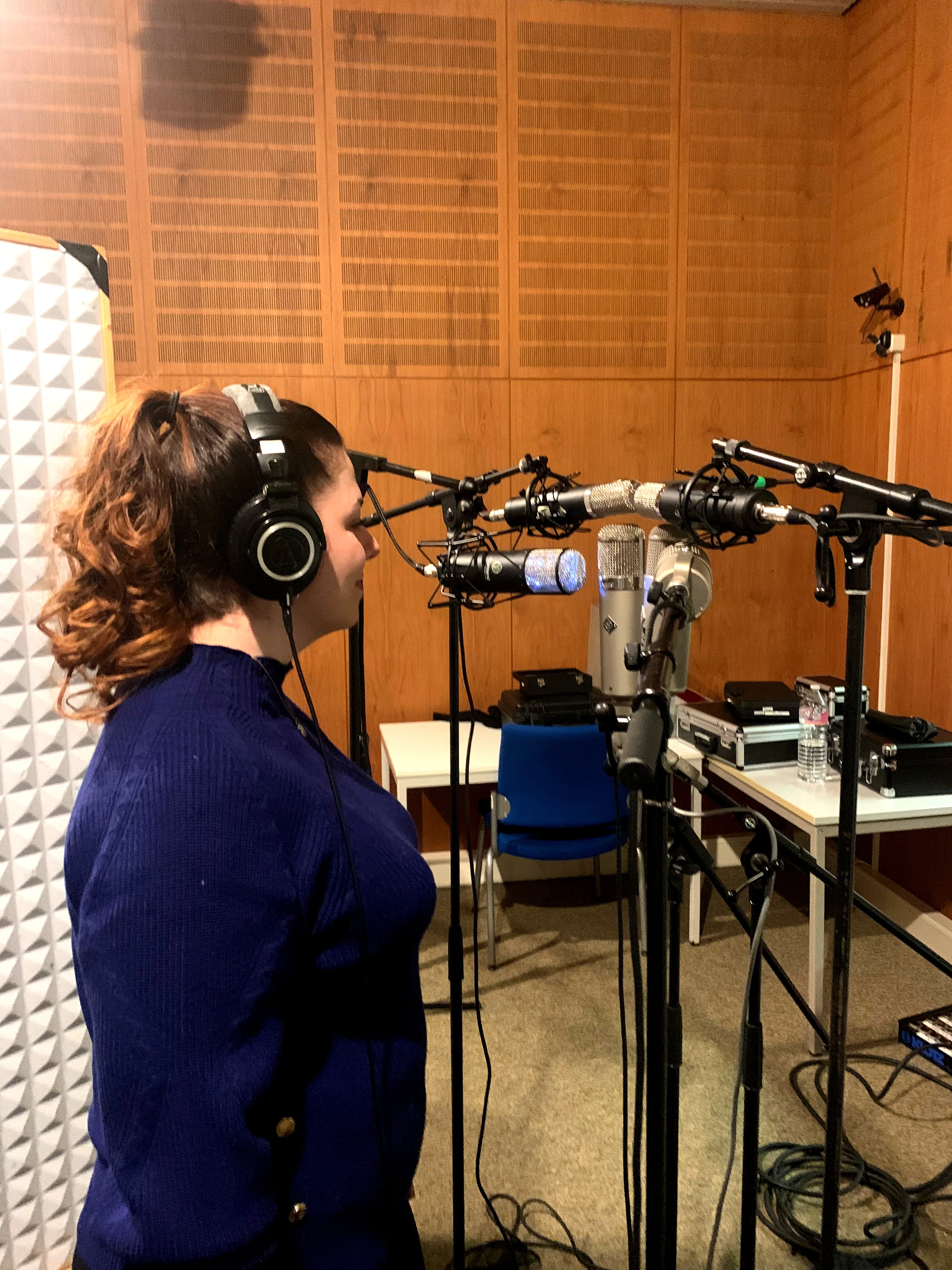

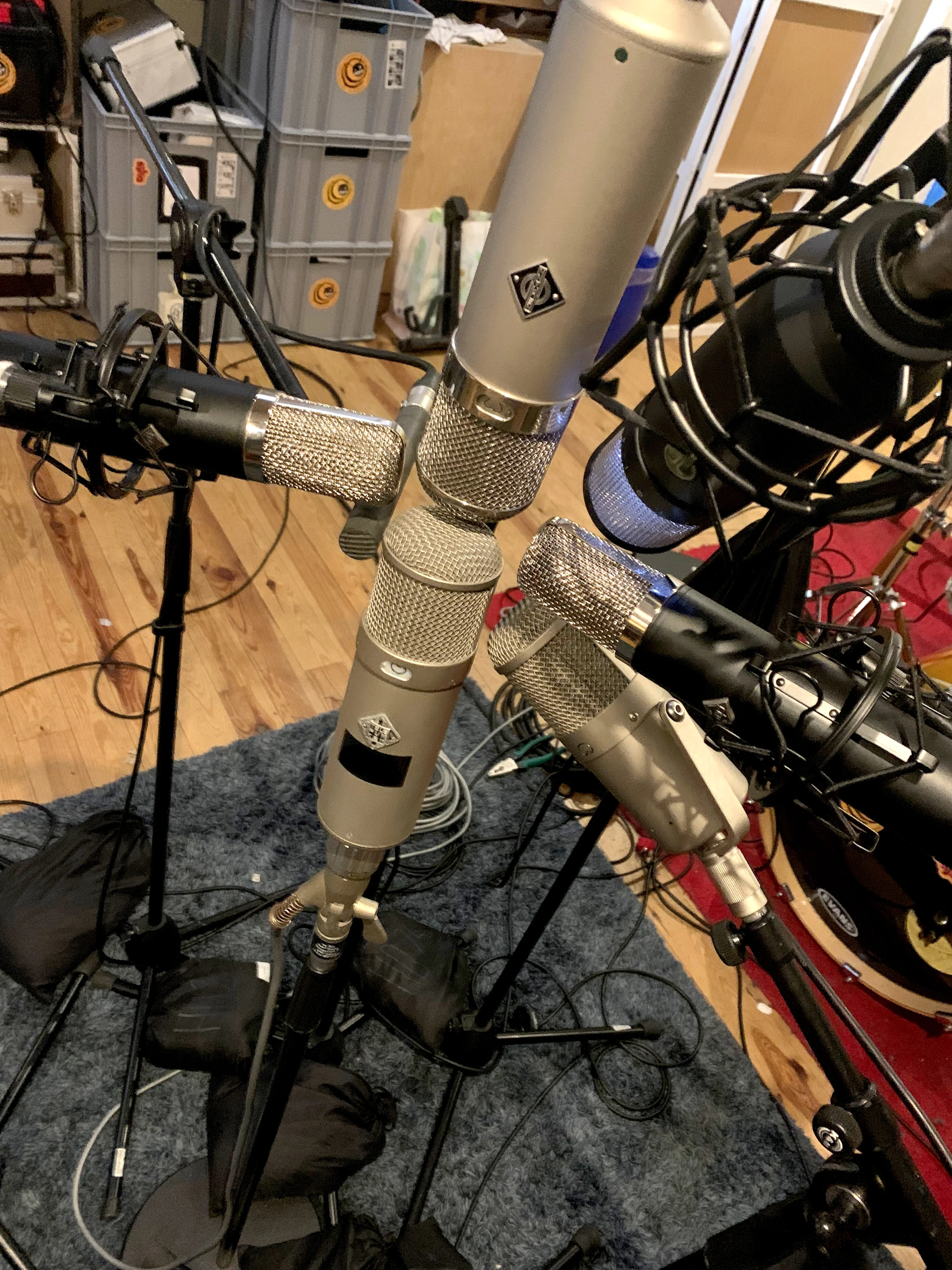

Hi all, quick update: I've done all recordings last week and am working on the processing of all data atm. Will message you soon when the blindtest is open, likely the day after christmas or so. Stay safe and have a good time!
PS: I call this new micing technique the "star of financial ruin"

Somebody is bound to say it, but you cannot put a great pile of mics together like this because you are distorting the integrity of each one, by them no longer being in 'free space'. Remember how some classic 'special' mics got that sound from a normal capsule suspended differently, so sound took different paths. Think of the Neumann M50, on paper, an omni. Inside the omni capsule was mounted on a sphere, this created a 'preference' for sounds arriving from different directions. Your cluster of mics has done the opposite. Some paths to the capsules are blocked by others, or perhaps even reflected. As to hearing this, I don't know? Putting them this close, in an attempt to get them into the same space might colour the sound? Probably will? If we decide we cannot hear this, then we must also conclude we cannot hear other differences. You've taken it from an objective test to a subjective test, because we don't have any way of telling what the obstacles are actually doing?
Its certainly a trade off and a tricky one at that. I chose relative position to sound source over colouration by the nearby chassis, as this gave me the closest result in the scenario I had. Ideally every microphone would have stood freely, and when I could because the relative position of the drums e.g. were further away (roughly 1,5m) so the few inches back and forth or left and right didn't matter as much as on a voice (40-50cm) for example, I did. In the other scenarios I tried to keep the "constraints" by the other mics as similar as possible, for example on having a responsive surface towars the top or side of the grille.
But as all recordings are essentially a bunch of compromises, so is this one. It's not ideal, but close enough for my purposes. I could have done a second take in the sessions with all mics but one removed, but then I'd have differente performances and slightly varying positions again, which makes comparisons tougher. So yeah, it's a trade off.
In hindsight, I propably should've got someone to knit tiny christmas sweaters for all of them to minimise reflection
I've seen comparisons where they had 4 mics in a star configuration from some of the bigger houses (Might have been Vintage King or Sweetwater). While it might have some effect on the sound due to interaction, I thought it was better than the alternative, which has usually been having someone sing or play the same thing with each mic. Unless you're Freddy Mercury or Karen Carpenter, that's a really tall task. There are ALWAYS subtle variations in the performance at best, sometime there are gross variations.
One of the best comparisons that I've seen involved a Yamaha Disklavier grand piano. That way the performance was as identical possible, so they could carefully place the microphones, leave the room and let the computer play the piano. It was probably very time consuming, but you did end up with recordings of real performances of a real instrument.
I think the big Sweetwater shootout was "free standing" mic on stand and the singer moved from one Mic to another doing many performances.
Neumann anechoic has a speaker and the mic faces the speaker allowing repeatability of the source and they can compare to specs for calibration work.
Watching a SHURE video with the anechoic chamber and also a sound source/ speaker with the mic on a motorized gear wheel that could spin the microphone showing the Pattern of the capsule sensitivity etc..
Many tests use the "cluster" 4 star" mic and one performance - in a room.
The U47 could be tested by having the 47 Free Standing vs 4 Star to see if there's a huge difference.
But for a test you go for it and compare and put the details of the room etc in the footnotes. right?
