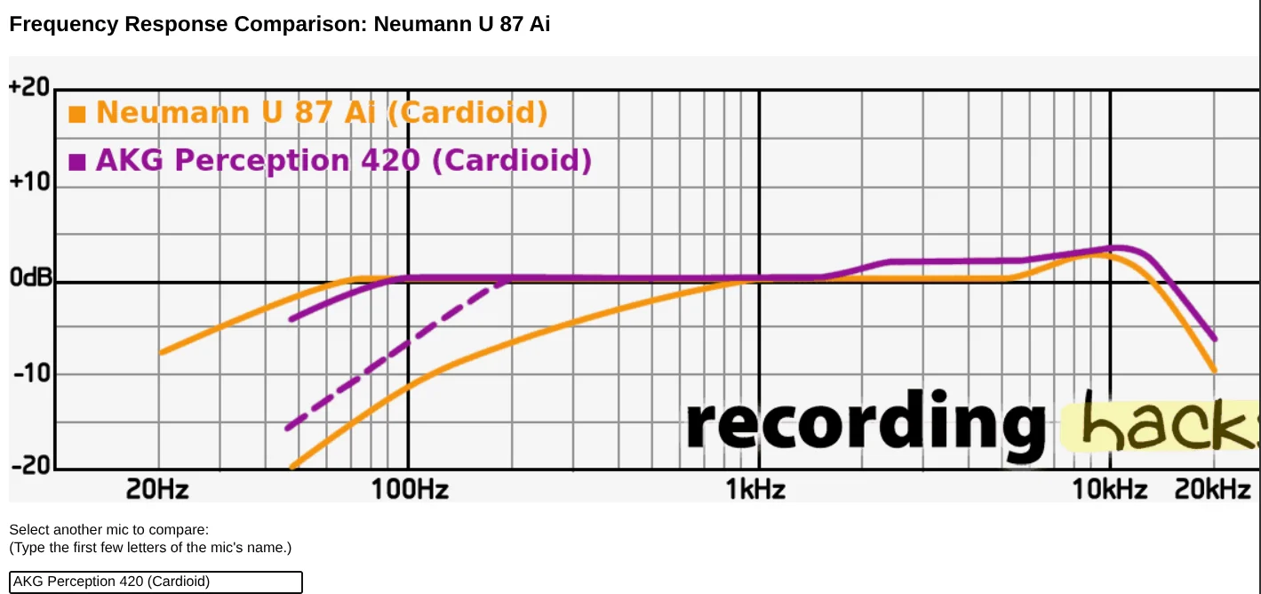

Checking Recording Hacks this P420 has the 87ai circuit copied. U87AI thru to U67 tube use NFB. Klaus explains NFB if ones interested to search it.
the P420 is based on the Neumann U87 Ai. The circuit is a single-stage JFET with negative feedback; the NFB provides corrective high-frequency rolloff for the capsule. The mic’s output is balanced by a small transformer.
This chart also shows why I don't like the U87AI HPF and use my ISA430-adjustable HPF, its a weird roll off.It starts off really high and makes the mic lose "body" or something.
