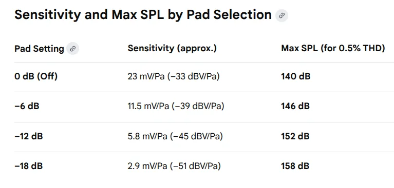

add another positive on the 414 list..
SOUND ON SOUND SOS
The AKG C414 XLS/XLII microphones feature a 4-position attenuation pad (0dB, -6dB, -12dB, -18dB) that changes the sensitivity of the microphone, allowing it to handle high sound pressure levels (SPL) without distorting the internal electronics.
Sound On Sound +1
  • Pad Settings: The C414 XLS/XLII models include options for 0, -6, -12, and -18 dB attenuation.
  • Method of Attenuation: The pad works by reducing the polarization voltage applied to the capsule, rather than using standard shunting capacitors, which ensures lower distortion when recording high-output sources.
  • SPL Handling: The max SPL without the pad is 140 dB. Engaging the pads increases this handling to:
    • 0dB Pad: 140 dB SPL.
    • -6dB Pad: 146 dB SPL.
    • -12dB Pad: 152 dB SPL.
    • -18dB Pad: 158 dB SPL.
  • Sensitivity Impact: The nominal sensitivity of the current C414 XLS is 23 mV/Pa (-33 dBV). Engaging the pads reduces this output sensitivity proportionally to the selected dB value (e.g., the -18dB pad reduces the output by 18dB)
The UT Twin87 achieves it's vintage/modern setting by changing the bias voltage on the capsule. I don't know if there are additional changes in things like the deemphasis circuit. I imagine it would be difficult to know if there's a difference in how the sensitivity is achieved, resistance in the signal path vs decreasing the bias voltage, unless you actually tested it within a single mic.
UT Twin 87 really did a good job in design offering modern and vintage and more.
Different designs to the same goal of "pad", Im not a level of gearhead to know what is really being done...but the Vbias seemed to be the "big thing" between the U87i and 87ai.
