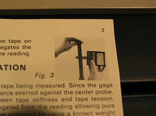

Okay...so I understand and trust Beck's advice regarding holding the Tentelometer in the right hand, but why then does the manual show this picture in the manual in the calibration section?
Is it possible that this is not critical and that the manual could have as easily shown the meter in the left or right hand?
That way is ok too as long as you're pulling rather than letting the weight fall. I described the other way because it helps to visualize the direction the tape is moving in PLAY mode.
If there is a variation in readings between holding in the left or holding it in the right, then calibrate with the tentelometer in the left hand for PLAY and FFWD, and then recalibrate as shown in the picture to measure REW.

I never even thought of that!
That makes sense to recalibrate for the different directions!
I'll try that...
