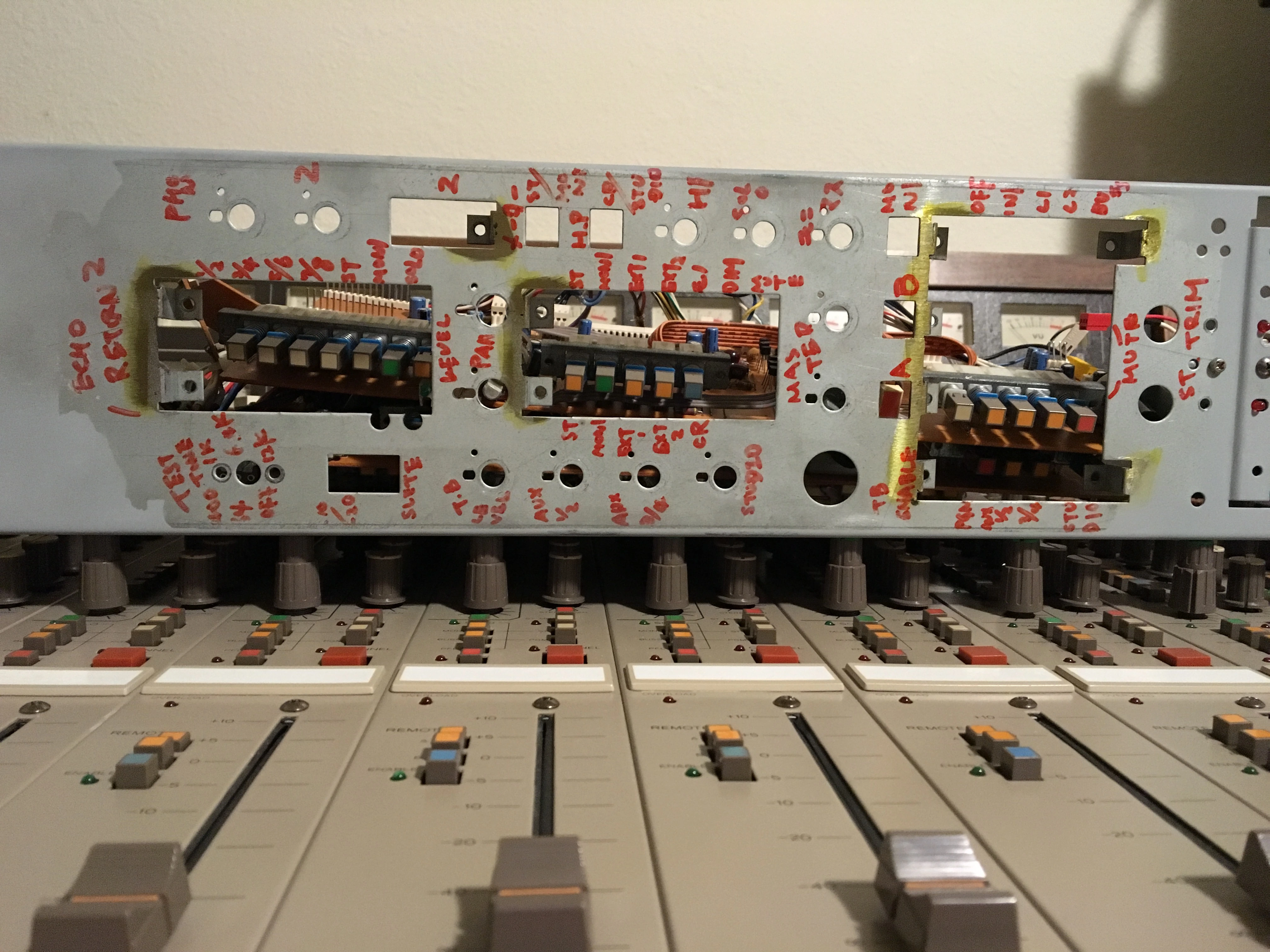

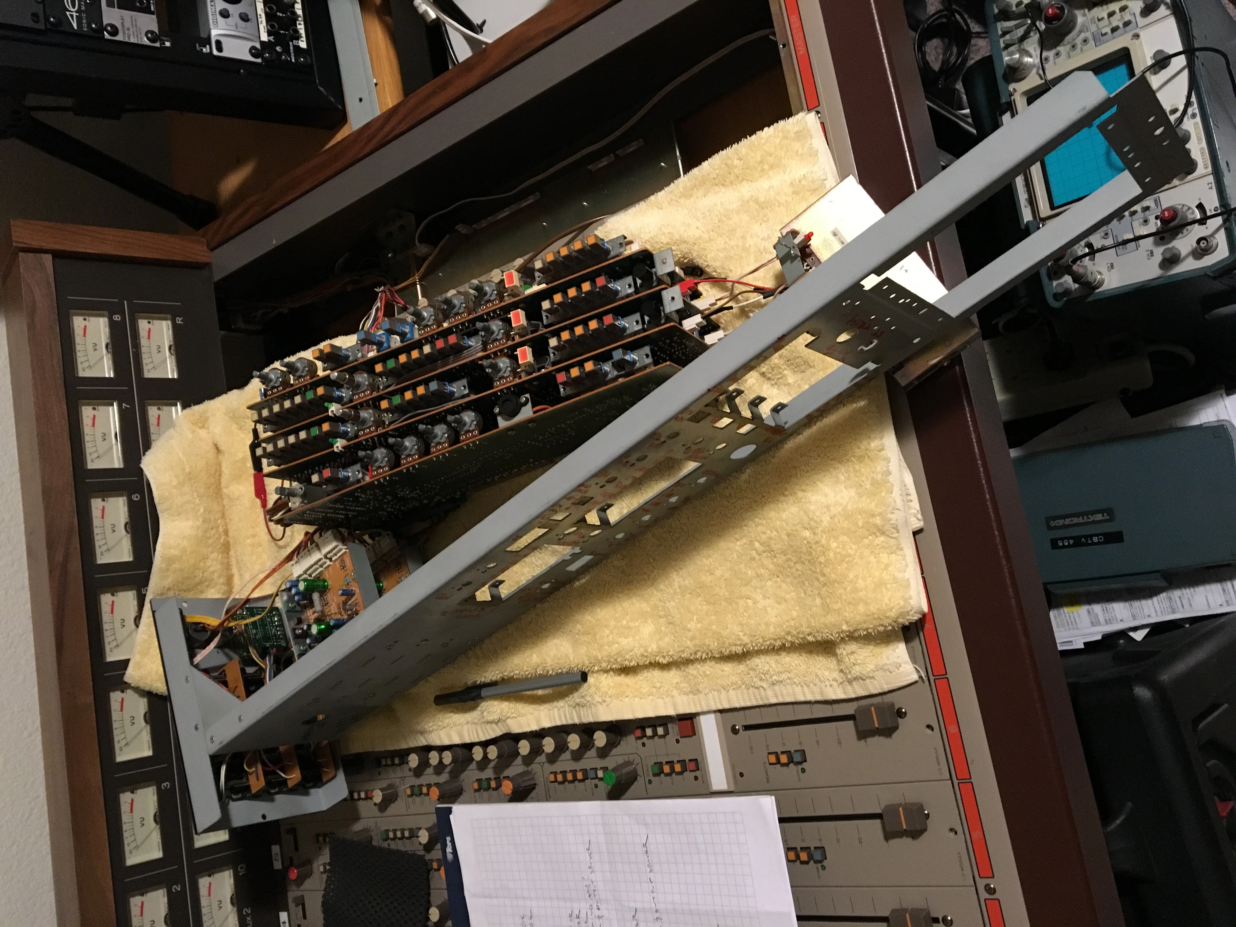

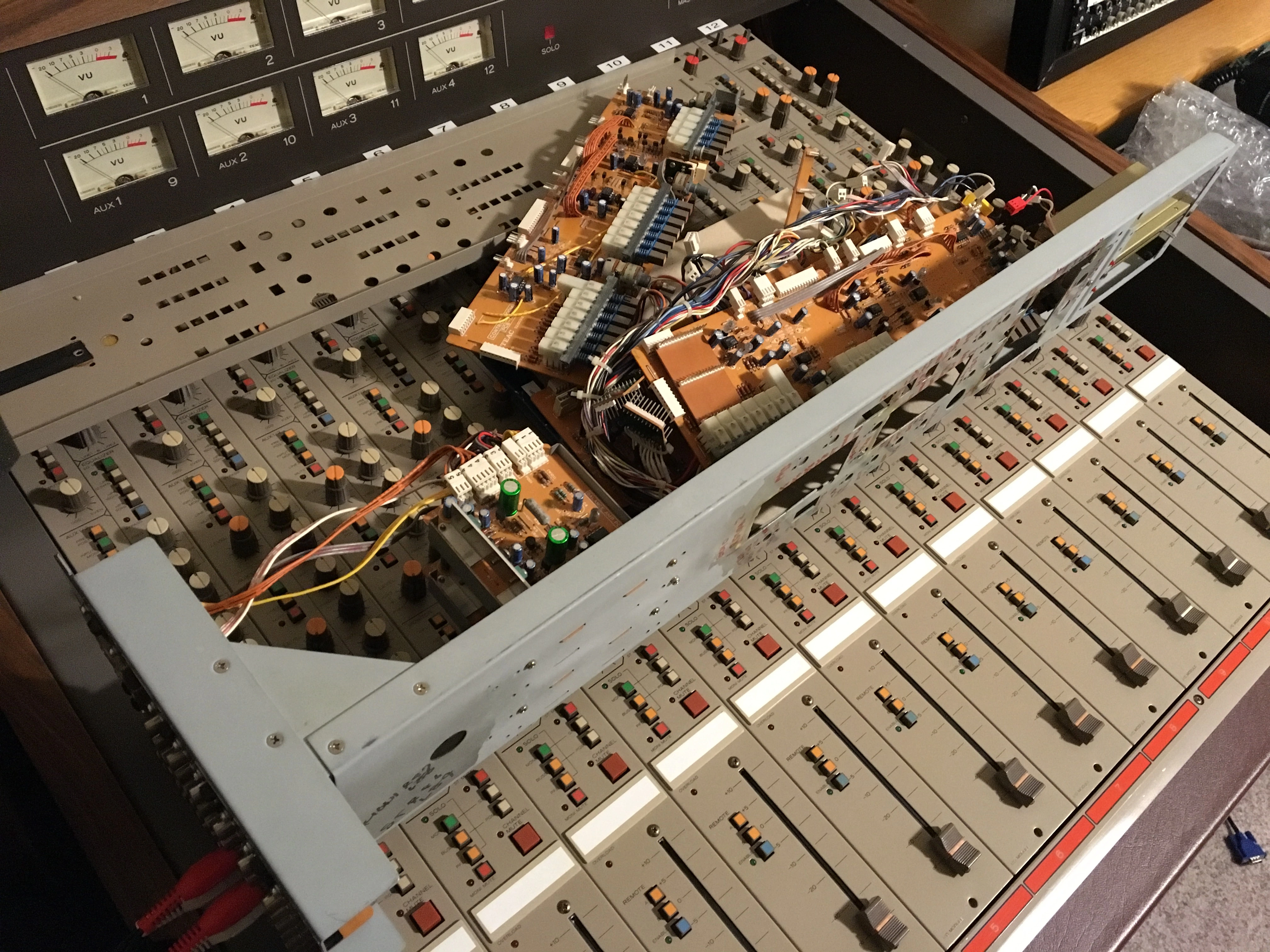

This is how the master section has looked since sometime in 2014:
No joke, just like that sitting right there on the control surface all basket case like. :(

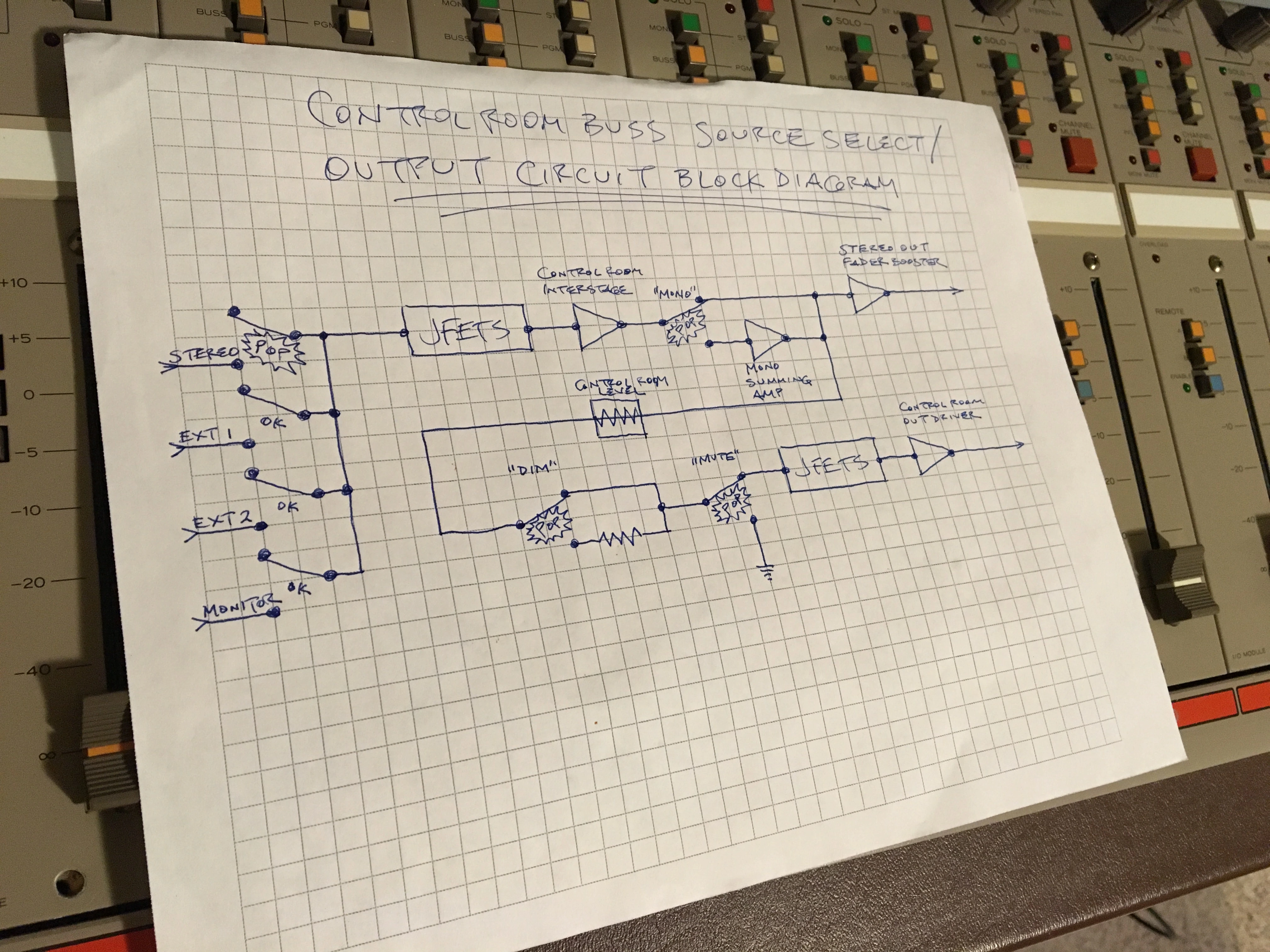

And here is the sketch to remind me where the source switching popping was happening in the master section:

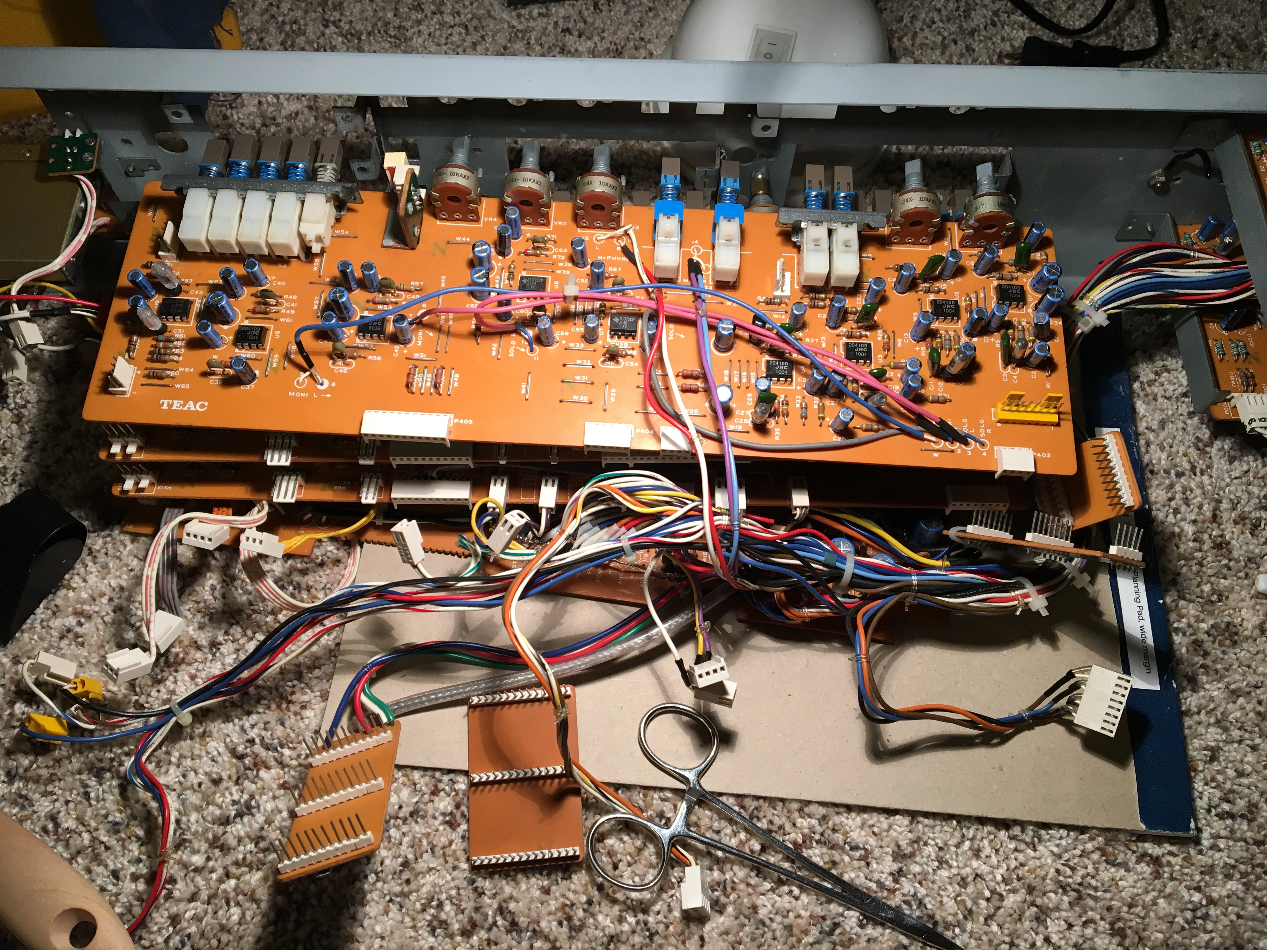

Trying to (gently) remember how it goes back together... I should know...I've had it apart enough times...
Think I've got it...I found some bad solder joints...gonna put it back together and run through a function test and see what does.

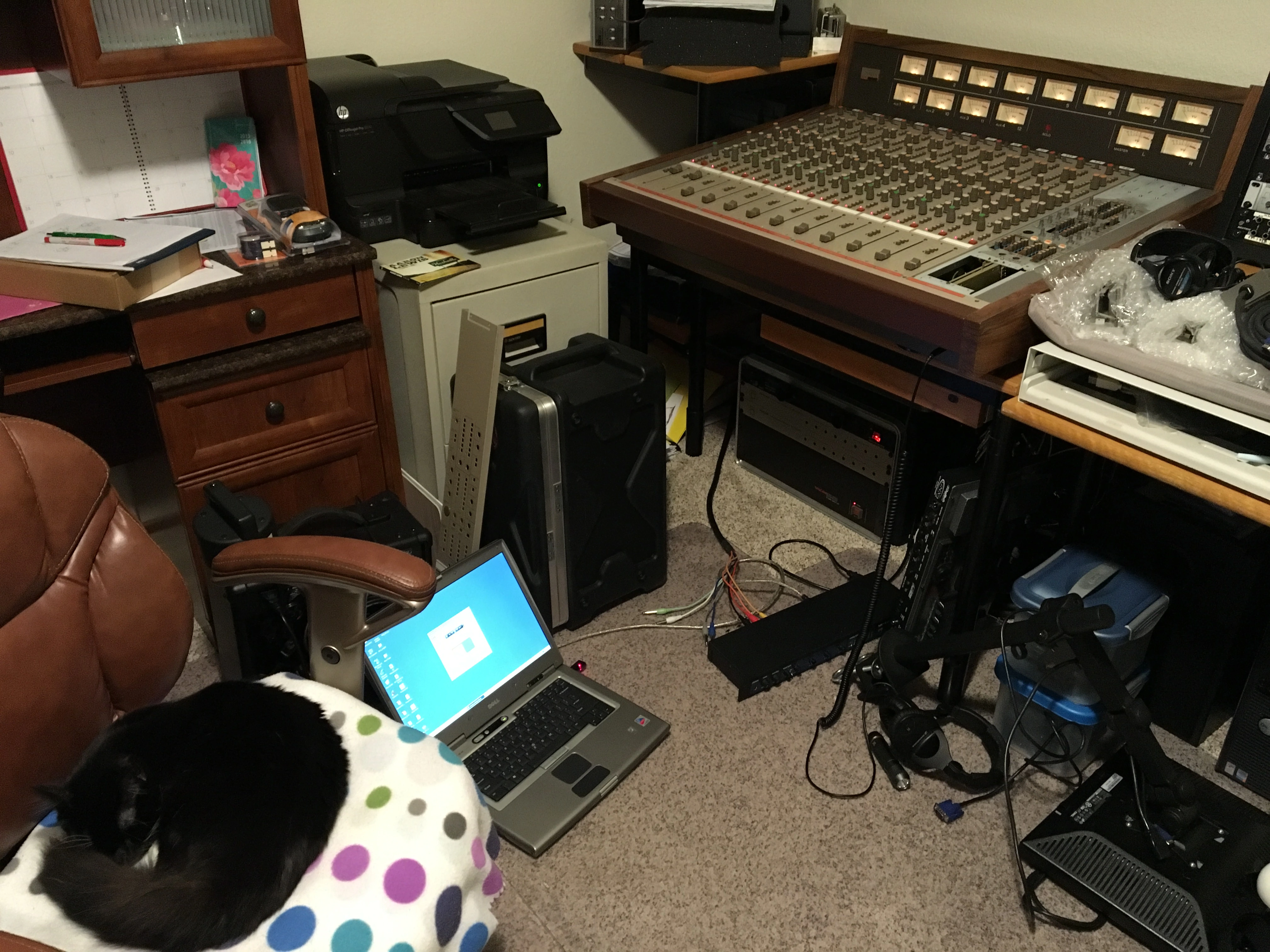

Well, I am working on some music for the wedding, and working on some vocal removal...the freeware VST plugs suck, so I decided to do it old school on an analog mixer. Great reason to finally reunite the M-__'s power supply, plug the master module back in and see if anything smokes, and to actually plug up some cables and see if it still works. This was refreshing. And good news the things wrong with the master section are still wrong (as opposed to new problems), and being exposed to the problems again is helping refresh my memory as to what I was going to do to resolve them.
But anyway, it was fun actually using it, and powering up my old DAW laptop I haven't used in years...I have to say every time I use the M-__ I am reminded how smooth and full the sound is. The low end has this nice effortless presence that is very musical across the low band. It's really a nice sounding mixer.

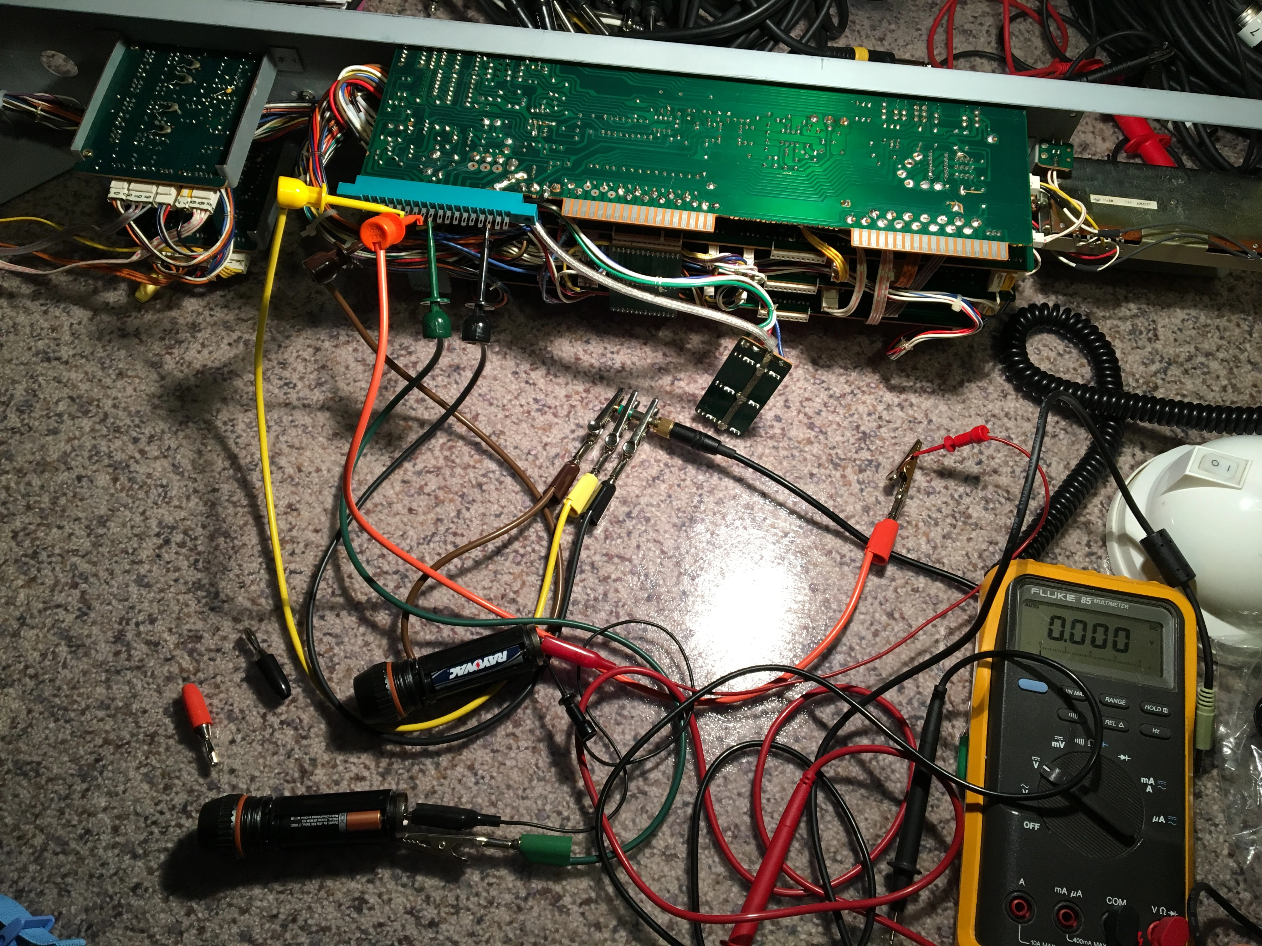

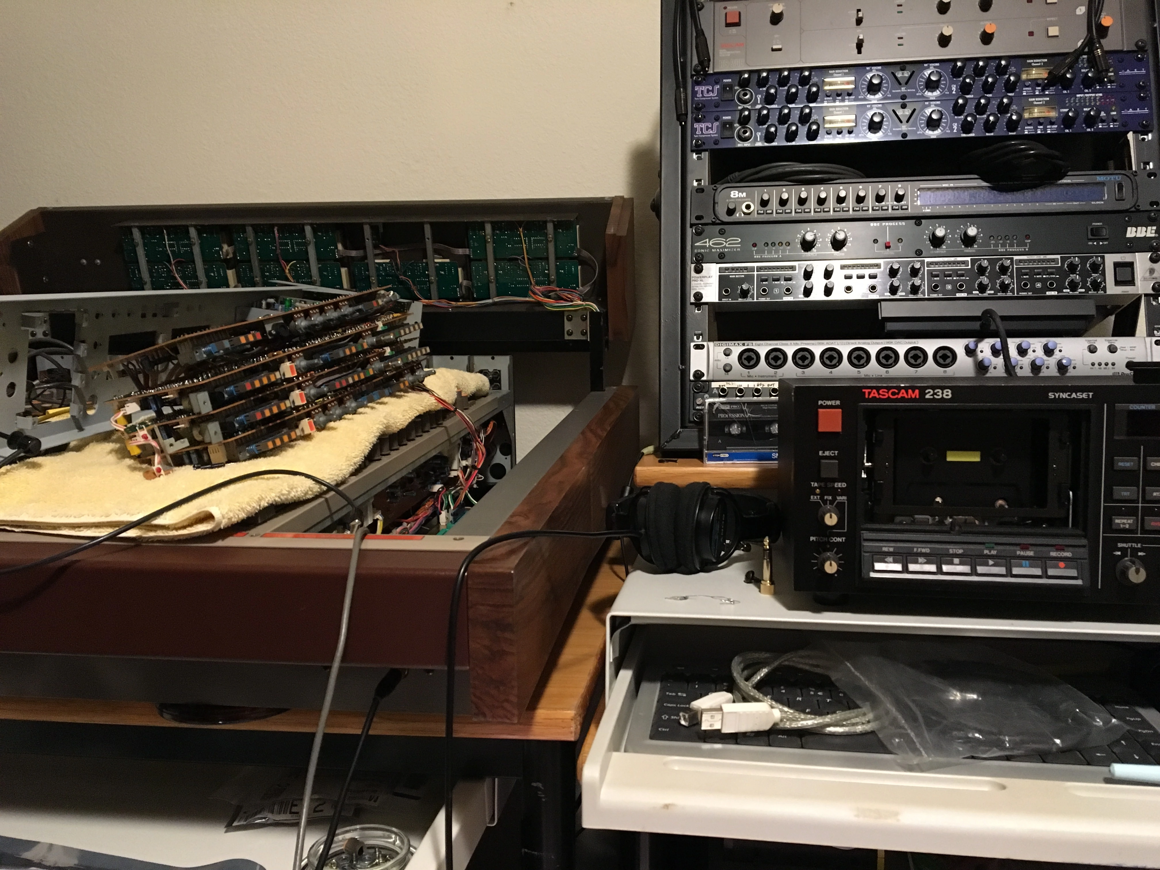

This is what it looks like when you cobble two flashlights together to make a 6V power supply so you can isolate and test your headphone amp...trying to resolve the noise issues with the headphone amp.
So I'm working at tackling the noise issue in the control module (master section)...there has always been some random sputtering fuzzy noise in the headphones...thought I had it fixed last night, but...nope...and to make matters worse it turns out it's in the STEREO and MONI busses too. I just never cranked things up enough to hear it. So it's time to build an extender cable in order to be able to power the control module while its out of the frame. I was going to do this a couple years ago and then life kept happening.

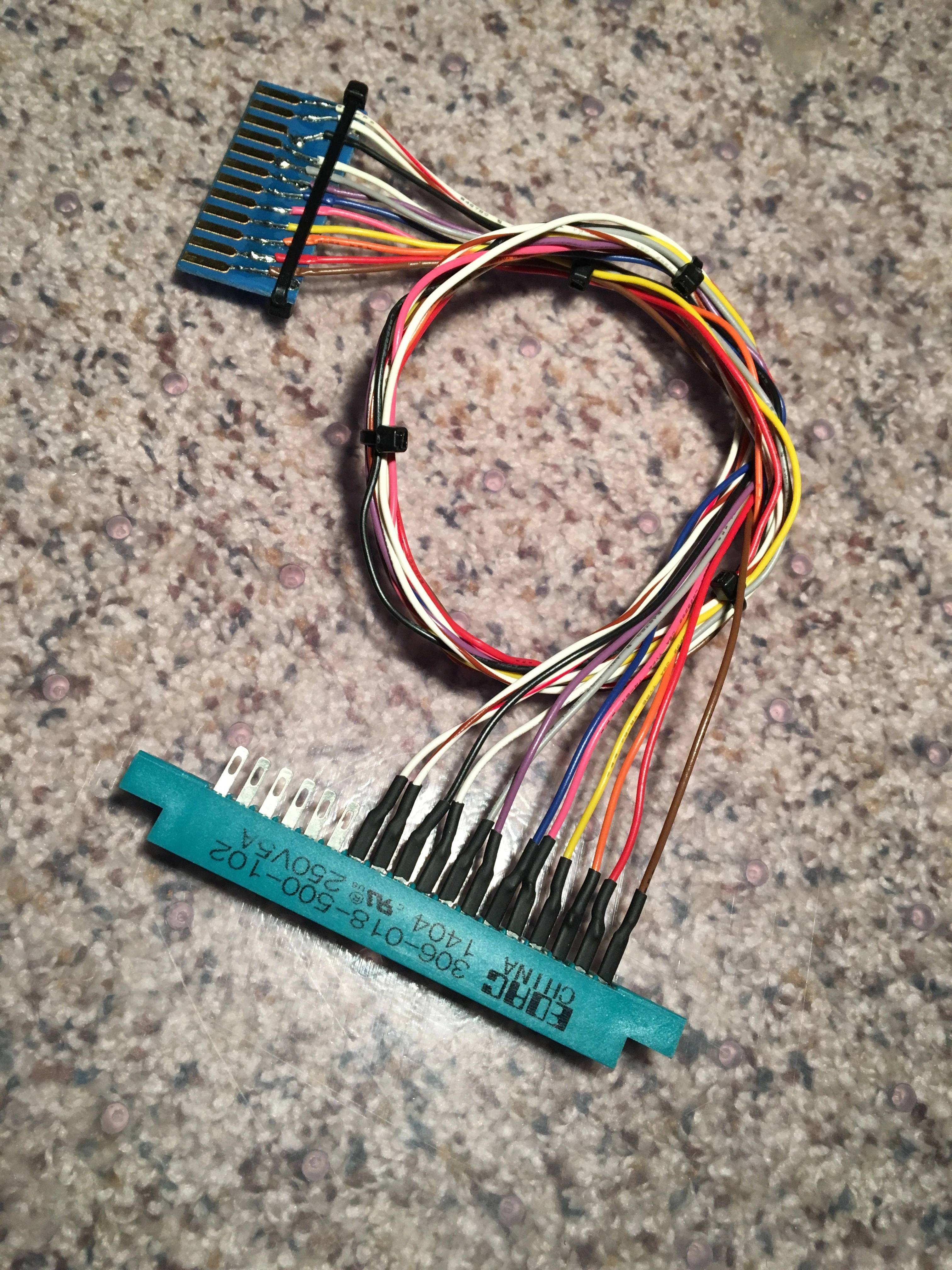

Not my prettiest work...a bit kludgey...but I can't find the EDAC connector in 14-pin, and had to use what I had on hand for the card-edge end...12 positions...cut out of an old Ampex card of some sort. It gets the job done.
So, 1kHz tone recorded on my Tascam 238 has an audible "warble" in it when reproduced. Like pretty bad.
My prime suspect is the pinch roller...I cleaned it and it looks and feels nice, but upon closer inspection it looks like there might be a slight wobble to it.
What does this have to do with the M-__? I was going to record some more tone while watching the pinch roller closely to see if the rhythm of the warble corresponds visually to the pinch roller wobble. My handiest oscillator is part of the M-__. Of course the master section is all pulled apart right now trying to chase down the sputtering and popping in the master section...waiting for a new set of probes for my oscilloscope to arrive because my old 10X probes aren't proving sensitive enough for the HF noise I'm trying to see on the scope, so I can start tracing and hunting down the source. Anyway, it looks like this right now:

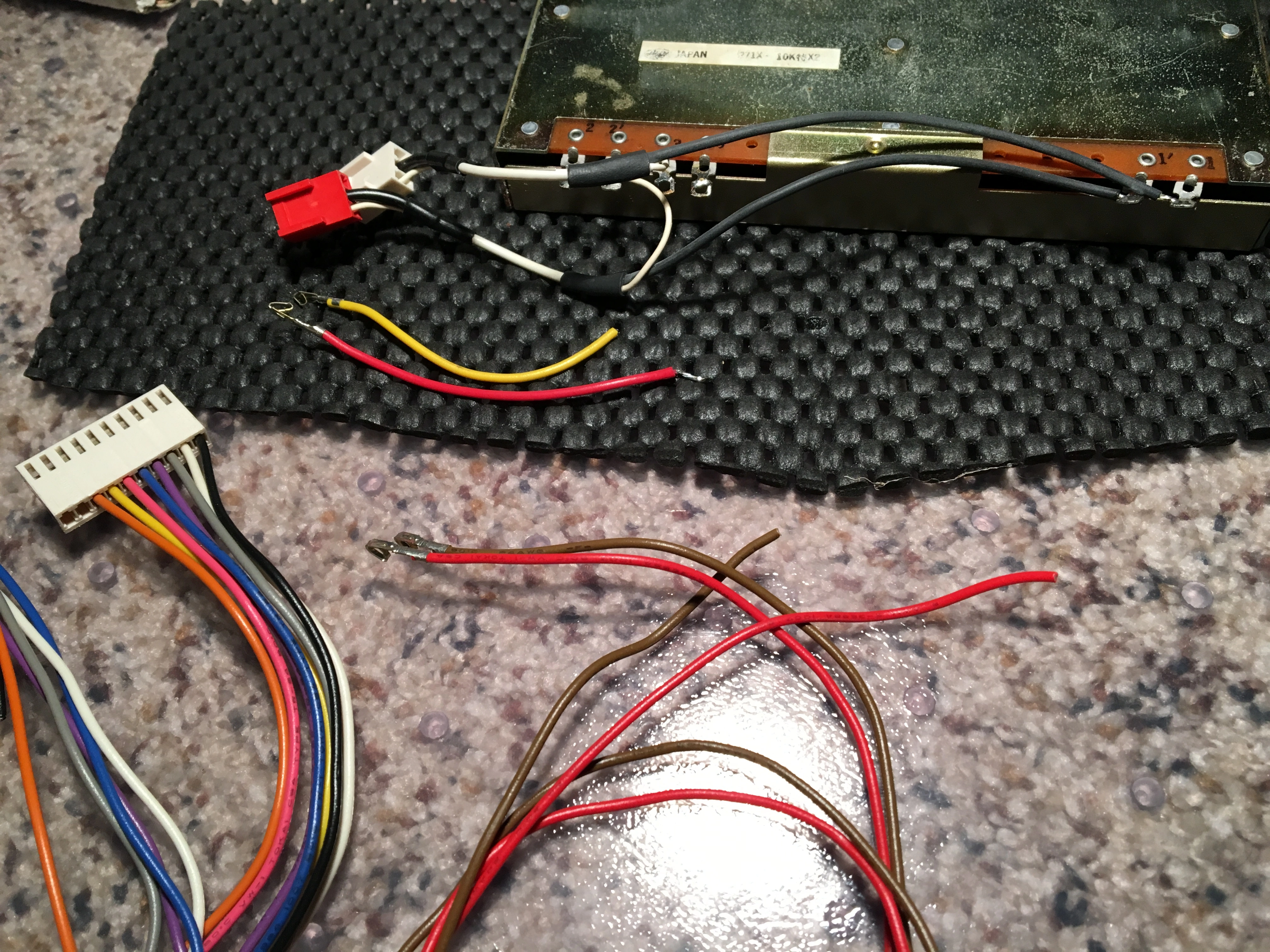

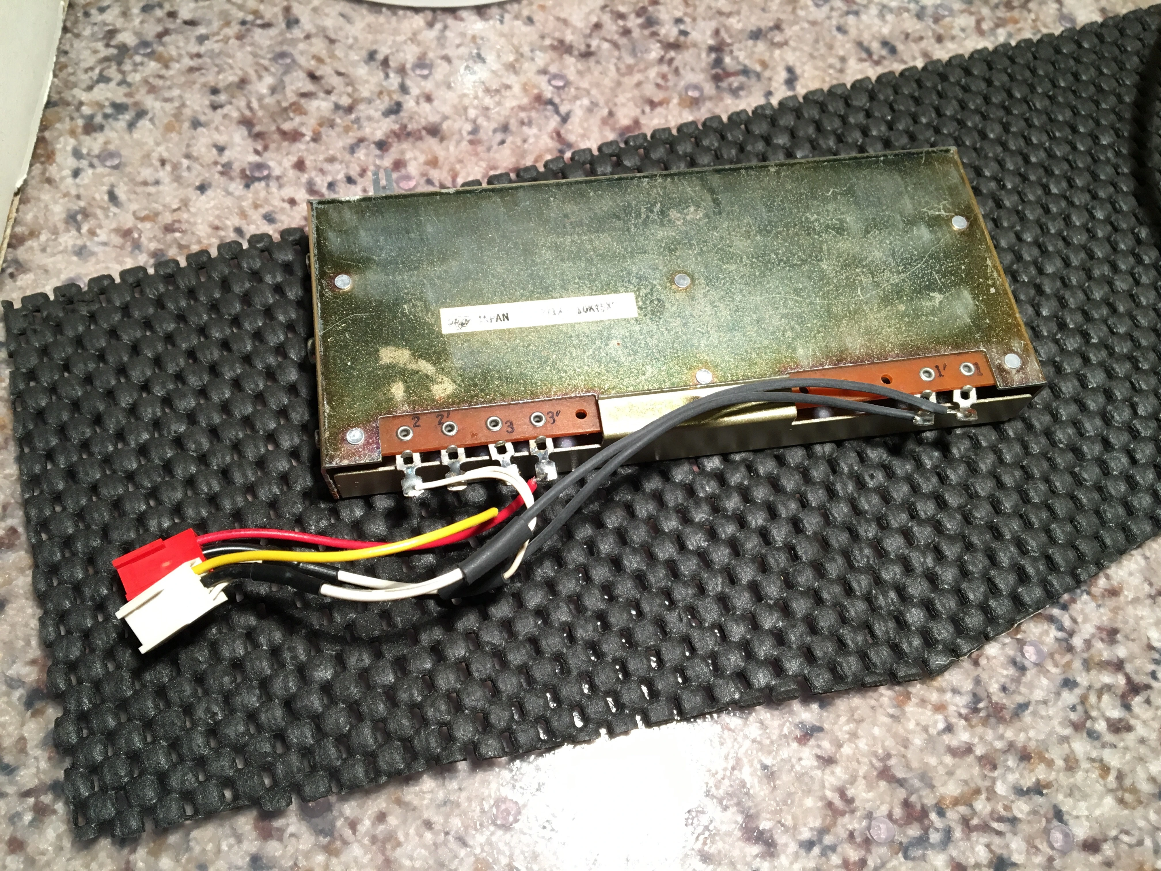

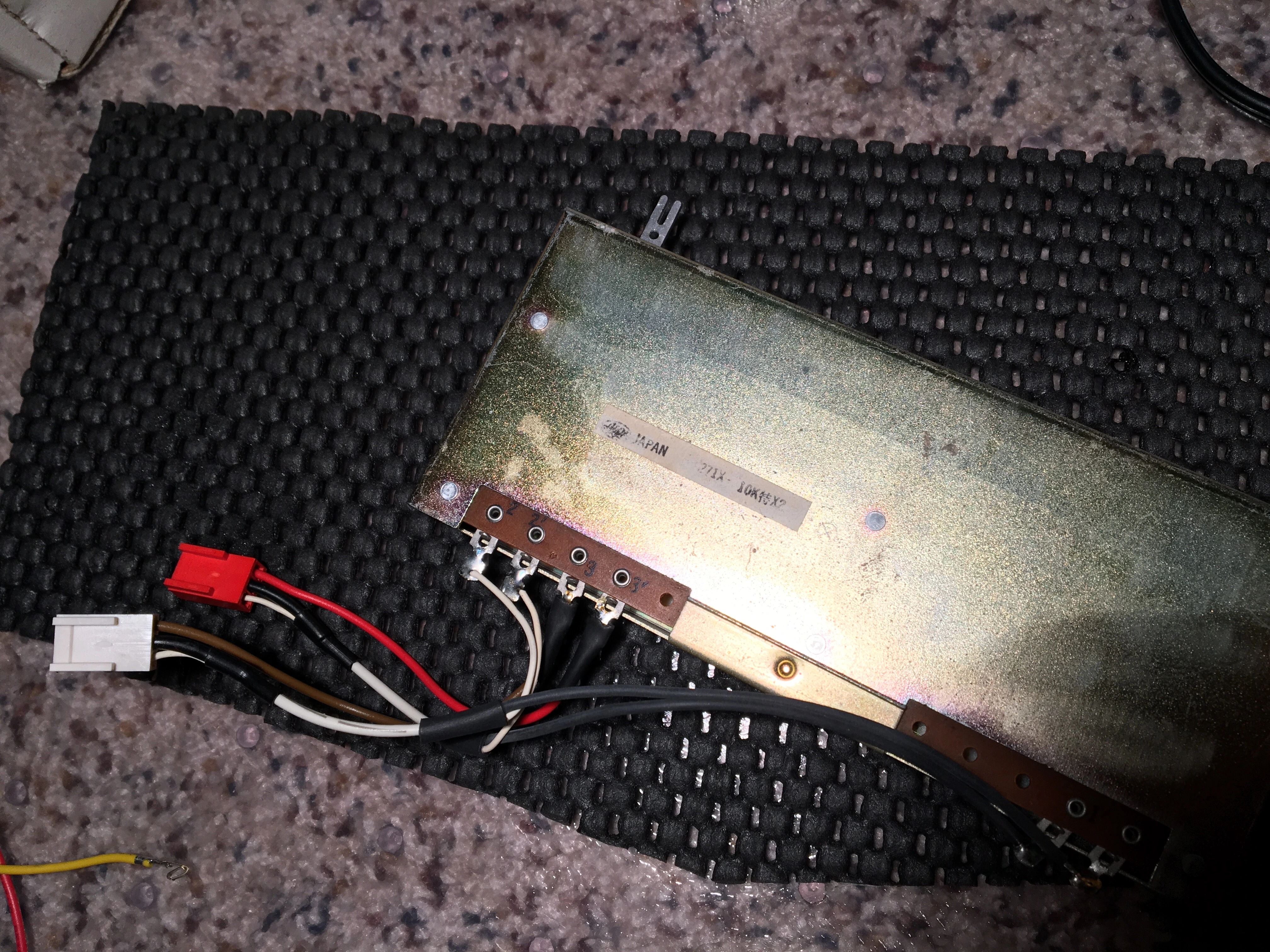

Anyway, as I'm carefully positioning the guts to make sure nothing is going to make fire when I power up the mixer to use the oscillator I notice a problem with my master fader...can you see it?
It appears the yellow wire has decided it doesn't like the fader anymore. I've had to deal with a healthy number of fragile wire joints on the M-__...didn't notice this one, until now of course.
So, okay, time to repair and improve. The joints should be reinforced by some heat shrink, and it's always bugged me one wire was yellow...it should be brown to go along with the standard color/number scheme; brown is 1, red is 2. Yellow is 4. Brown and red often represent left and right in audio gear guts too.
So I dig out spare connectors and wiring and find a good equivalent AWG donor set of wires of proper colors, desolder the old wires, remove the sockets from the plug housings, and prep for the replacements to be installed:
And...better.
And with that I believe the matter is repaired and improved, and I'm about 25 minutes closer to the afterlife.

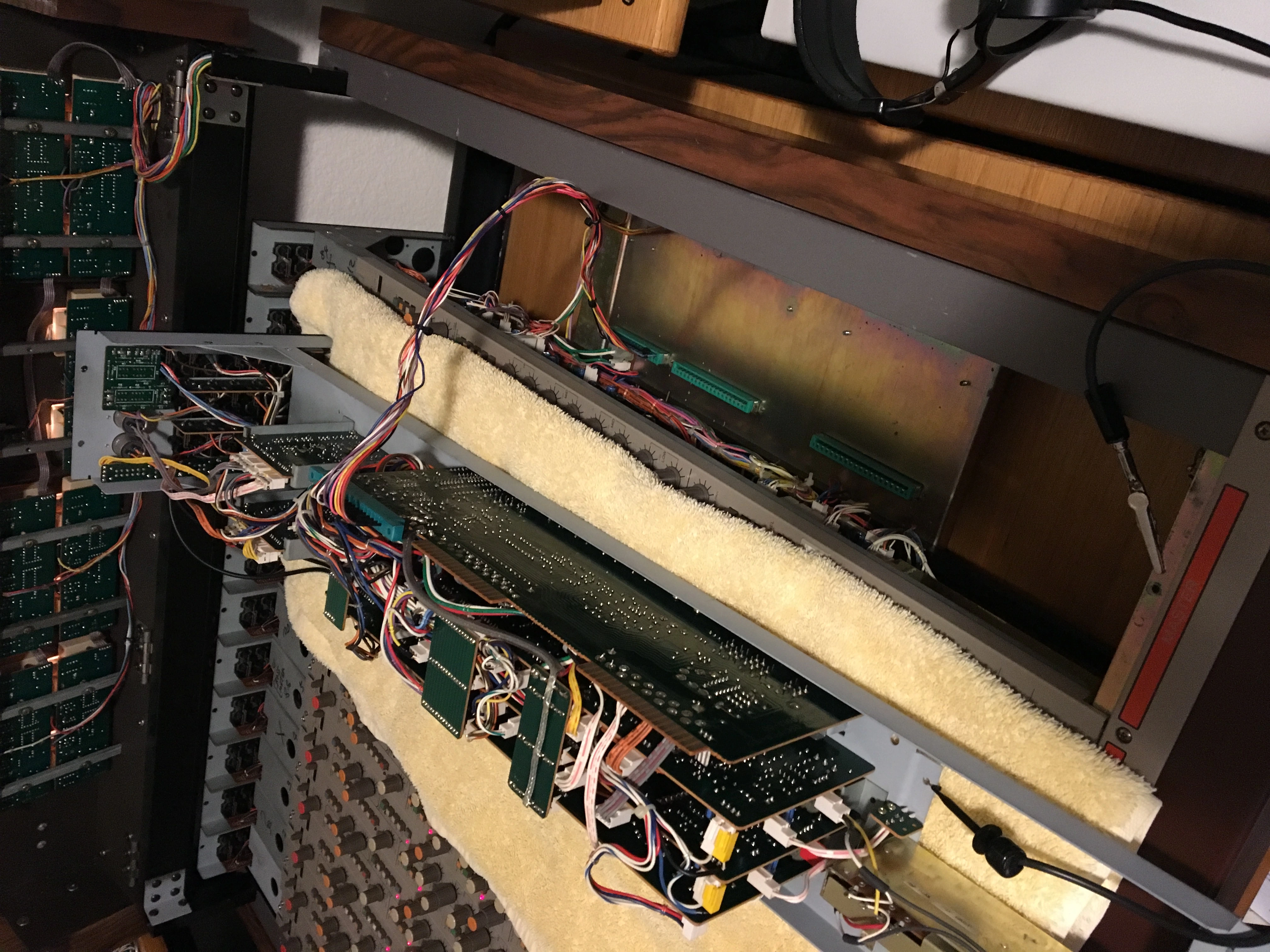

Packing this up to take to the doctor tomorrow eve...the "Control Module", aka the master module.
Been continuing to struggle trying to figure out the source of the sputtering/popping/fitzing in the headphone circuit...it's simply over my head. I've been able to determine, with reasonable assurance, it is upstream of the headphone level pot, but isolated to the PCB upon which the level control is mounted. That leaves very few possible suspects because the signal path upstream of the level control on that PCB includes only the headphone source select switch, and some direct traces to the connectors that interface with one of the buss PCBs that connect the two possible sources of the headphone circuit to the PCB with the level control...so what I'm saying is there are no components either active or passive on that PCB upstream of the level control...just the switch...and something is throwing noise.
Ideas: if you go back early in this story, you will find a vignette about a pile of mouse poo and pee...the mouse poo and pee was primarily on the PCB with the headphone level control. I fastidiously cleaned all the boards in the Control Module, and replaced any components that had any signs of corrosion on them...and I have also replaced all the opamps on that PCB as well as a number of the opamps on the other boards. BUT, these are phenolic resin boards as opposed to glass fiber. It is possible the base material of the PCB is contaminated due to the historical piss, and there is current leaking through the board itself and that is the cause of the noise...OR, maybe it is a problem with the power rail itself; the rail that powers the headphone amp also provides the signal ground, and ALSO powers the LED indicators on the module...it's a bit of a strange design in my limited experience, but there could be extended opportunities for weirdness there, though there are only 5 LED indicators on the module...but it's a possibility.
This issue is the last complicated and stubborn jank on this one-of-a-kind console, and I'm at the point of saying "uncle"...reached out to an old friend evm1024 and he's graciously willing to assist. Headed over to his place tomorrow eve to pick up a Tascam 58 parts machine and extender card that I sold to him many years ago, and bringing the M-__ Control Module and console power supply with to put on his bench and see if we can figure it out.
I'd love to traverse this hurdle and be that much closer to calling this project 100% done.
