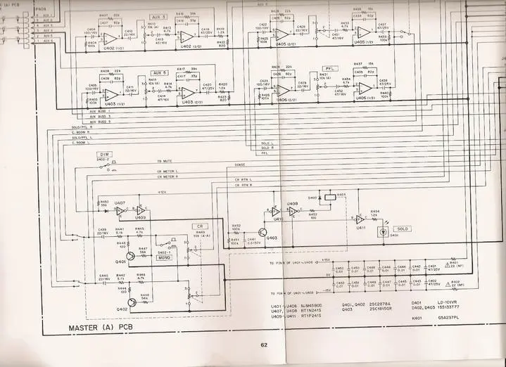

Quick question. Any relays in the master section? My solo function didn't work on my M3500 and almost replaced the relay and all the transistors in the solo section, turns out the fuse for the 8 volt power supply section blew that supplied power to the solo circuit and VU meter lamps.
Huh...I don't think so...any way to put up or link a picture of what they look like? I've worked with relays on Tascam r2r amp cards as well as Ampex 440 electronics (bigger cube-type relays on those) and I don't see anything like that on the master section PCB's, but maybe there are and they just don't look like that. I'm suspecting a transistor or transistors at the moment. Definitely green in that area and evm1024 has given me some pointers to get my knowledge a little deeper on those types of components.
Hey Sweetbeats, not sure if this would be any help to ya but I posted the Mute section on my M3500. Seems it's kinda similar/kinda not to your section. Maybe it would it help. I also posted the Solo relay data sheet of the one used in my board. The relay plugs into a standard DIP socket (like a op amp) and is just a little taller than a op amp. Some have a clear case, some are solid black, it's just a 2 pole switch with a electro magnet that "flips" the switch. I'm not a expert, just know enought to be dangerous!:eek: Hope this helps, even just a small bit.
Gerard...sorry I never followed up to that last post. No relays in the M-___.

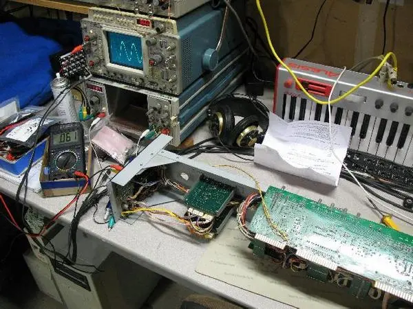

Oscillator working
Sweetbeats tone generator uses a quadrature oscillator. I had it on my bench and found time to spend with it the other night. It was throwing a curve in that one of the parts I suspected (C3, 4.7 nF) tested OK in my multimeter. In the end I just went ahead and replaced it and that took care of the problem.
Here is a photo of it generating a 61 Hz sine wave.
--ethan
