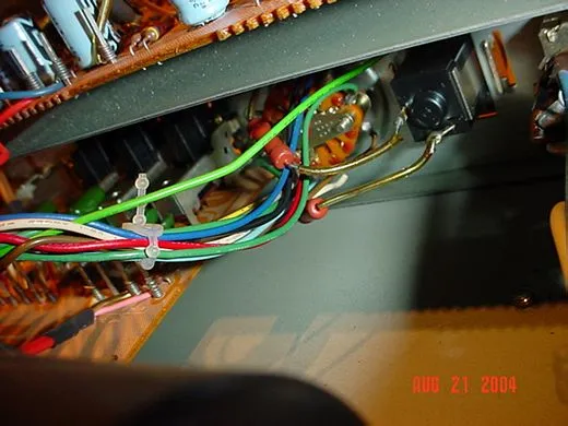

I've found a "Caig" distributor here in Burnaby (BC), almost next door, so that's the good news. What I would like to know is which of the following Deox-it formulations do I need ?
Please click HERE to see what they have.
Which one would you suggest I pick up ?

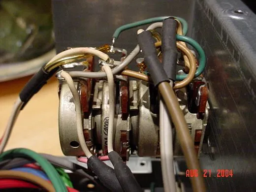

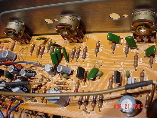

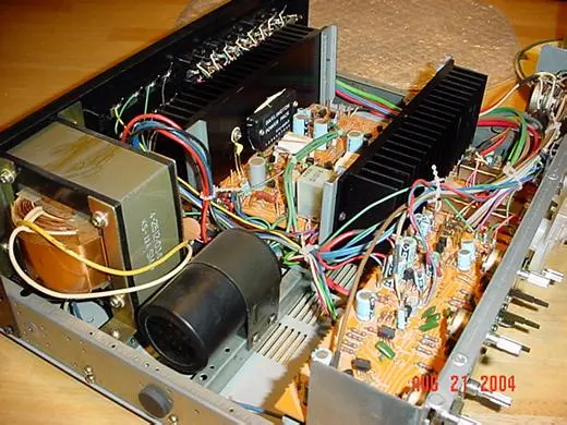

I've enclosed several picts of the Amp and photos where the knobs get turned (sorry, don't know the proper names) and was wondering where and how do I exactly apply the Deox-it ? Thanks again!!

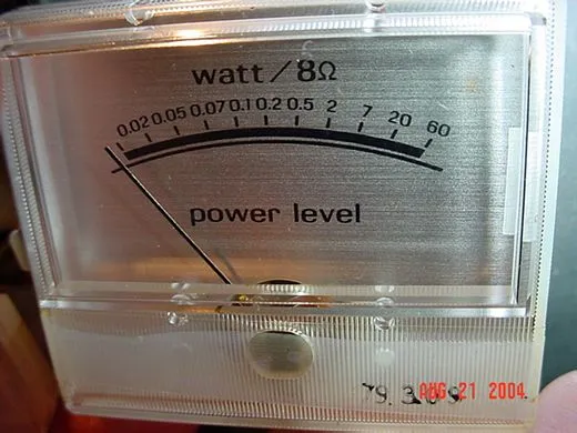

Oh, btw, the VU meter problem was fixed. It seems that the glue that was holding the plate to the plastic gave way and fell on the needle! :eek: Nothing that a bit of scotch tape couldn't fix ;)
Here's a photo attached of the meter with the tape barely seen on the right side:

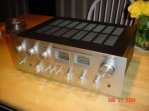

Oh, what the hell ... attached is a nice photo of the Amp, fully intact! :D
Poor thing wasn't used since '79, or at least most of that time .. all it needs is Deox-it. :)
