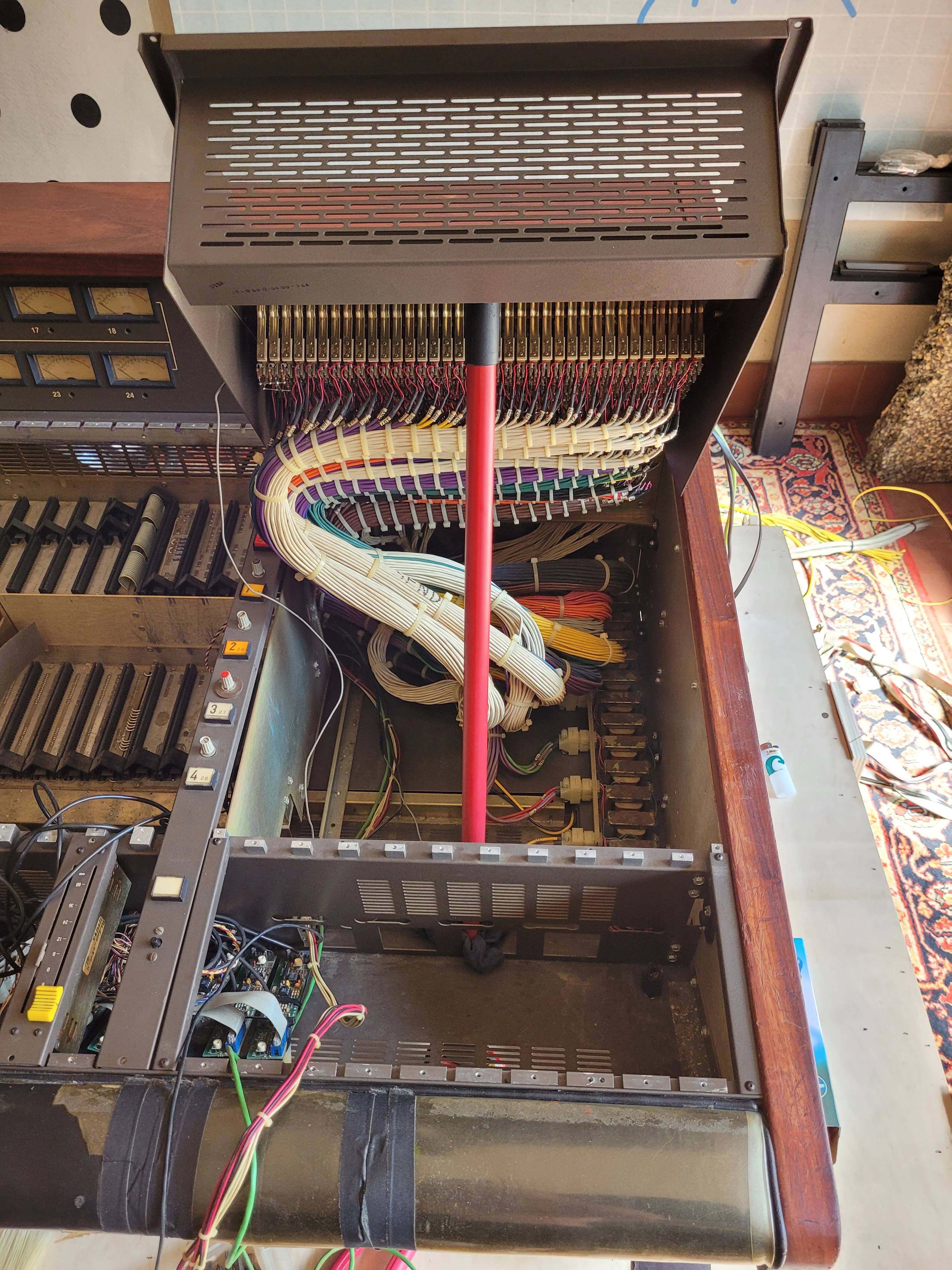

Hello everyone, I'm coming back here to give some news on this titanic project for me who is not a real electronics engineer. I had time to dismantle it completely. All cleaned, And the faders clean. I am in the process of making a measuring bench so that I can work on the modules on the bench. This will allow me to do sweeps in each module and see the response of the signal once the module has been recaptured.

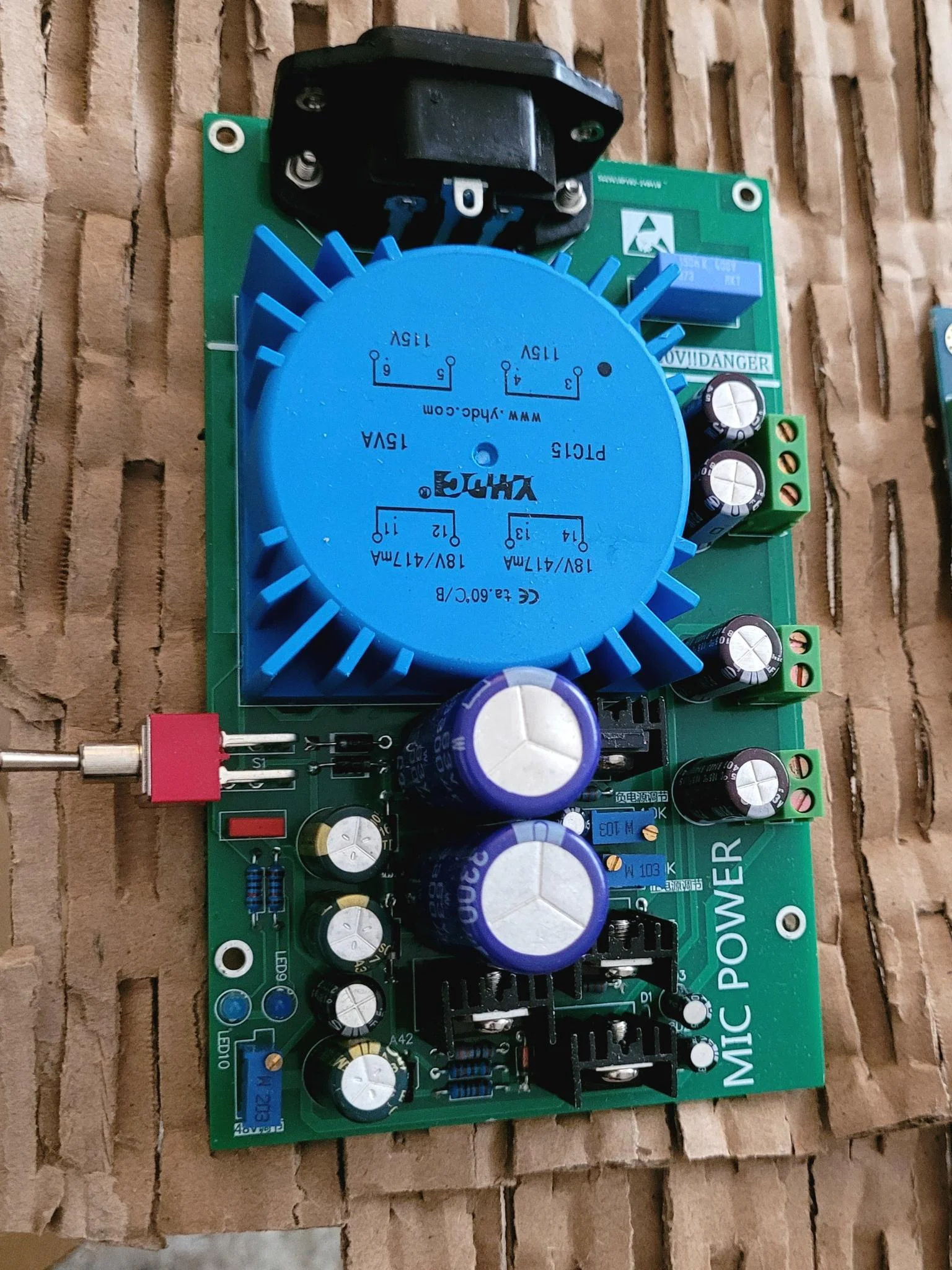

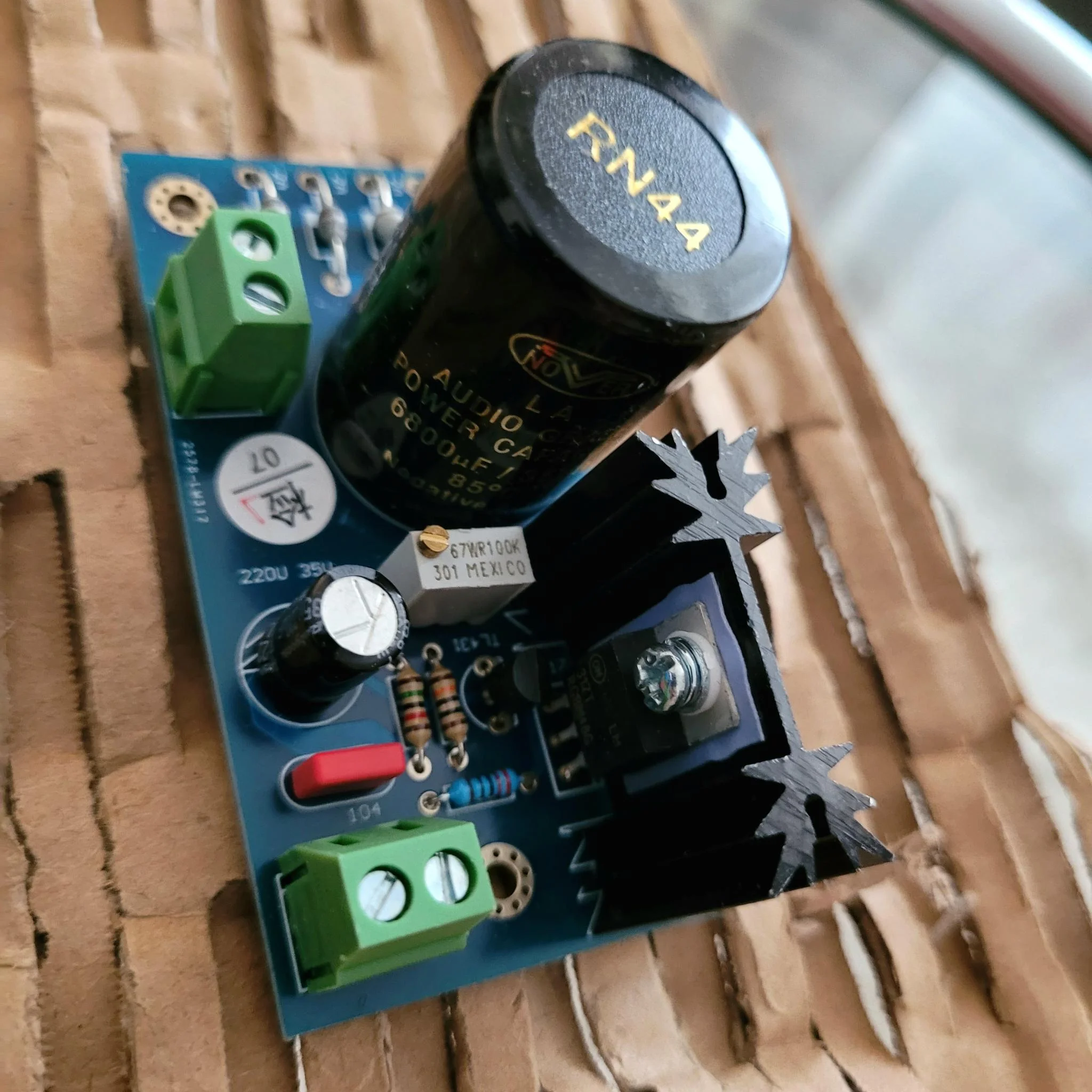

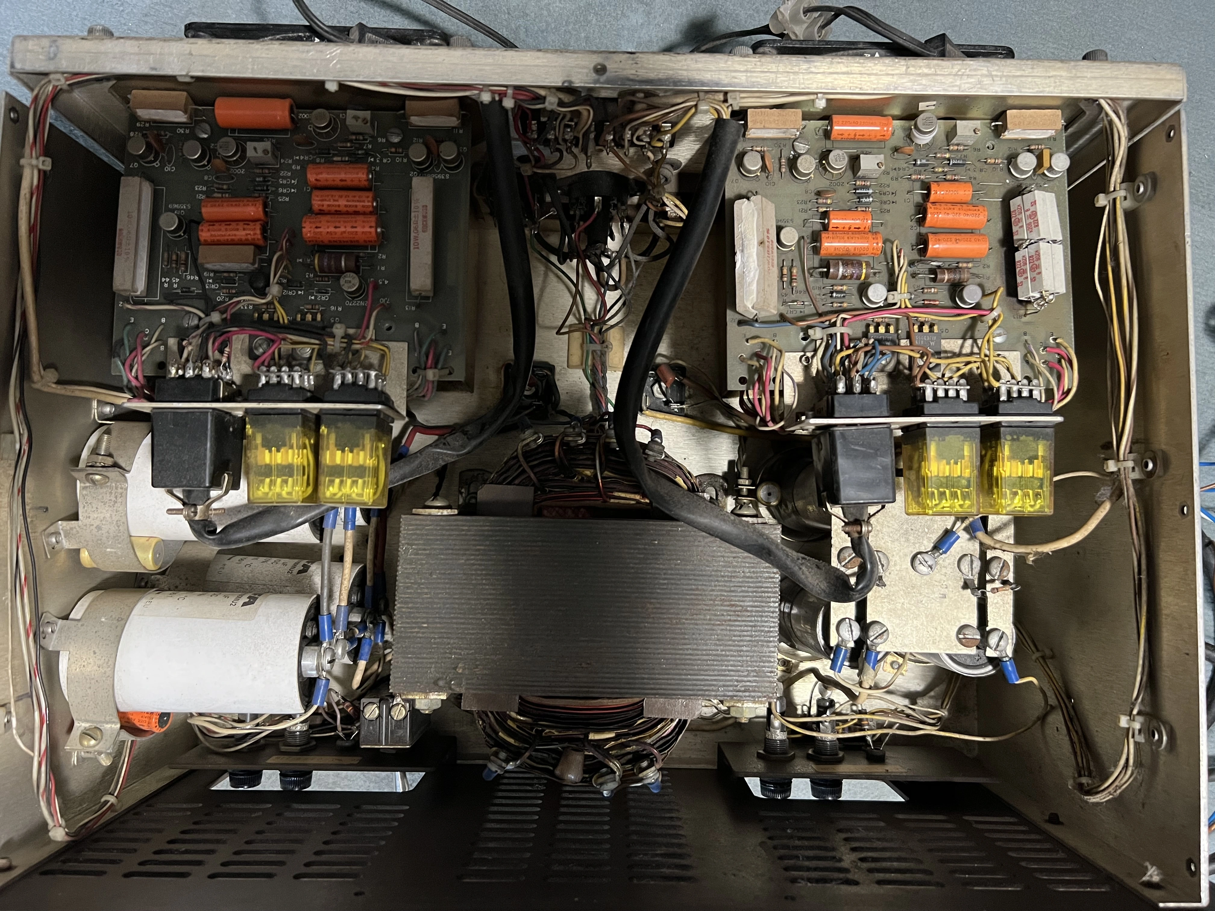

here are the power supplies that I was able to have to make this measuring bench.
The first is for +18V analog, +5V for logic, and +48V Phantom To be modified to raise it to +18V because it only provides +15V for the moment. The second will provide me with 24V for the lamps. It may be oversized, but the more the less.

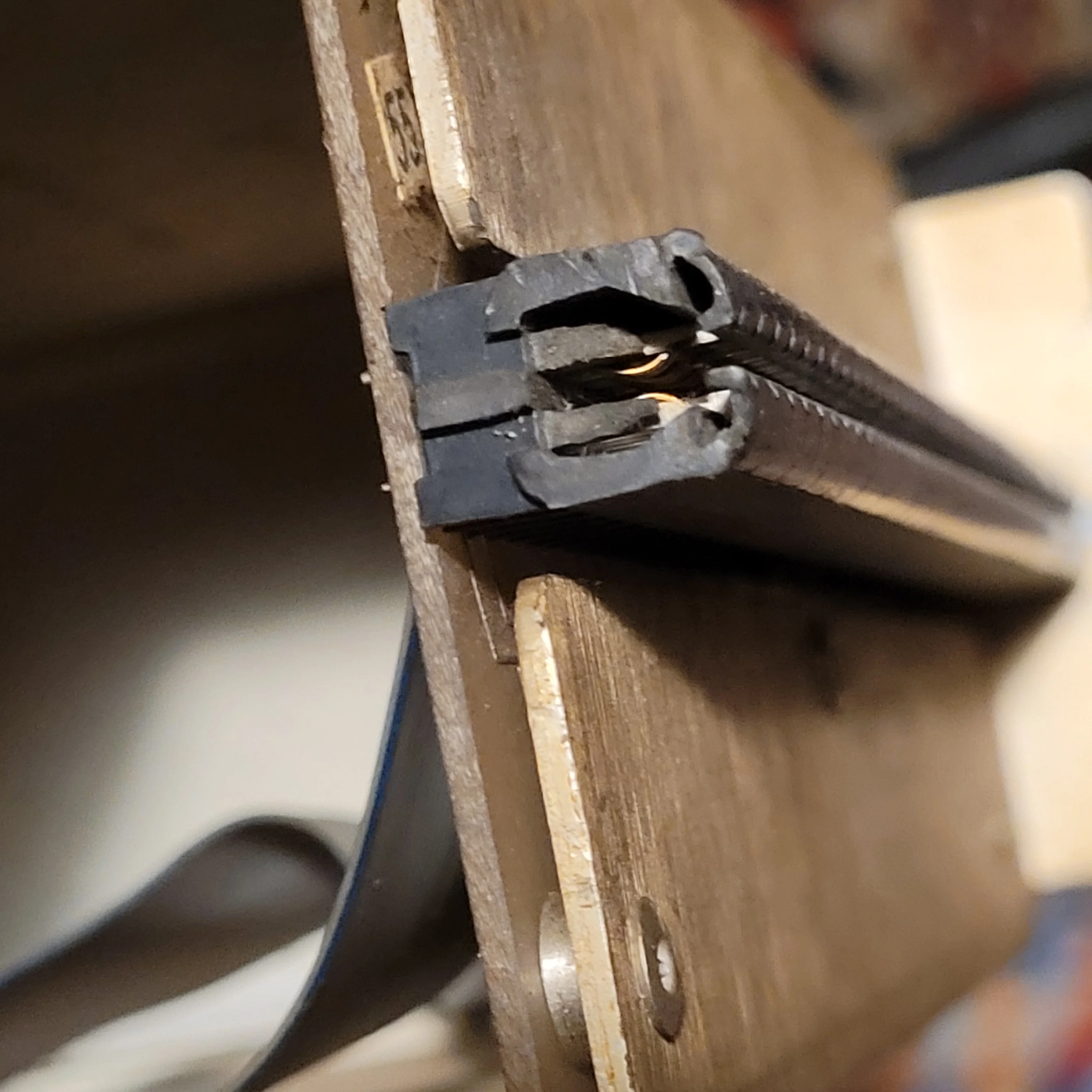

Except that I have been looking for some time for the exact Ref of the EDAC 40 pins linear port at 3.81mm
If one of you had this reference it would really be great. Thank you very much for your enlightenment to all of you
This is the one I'm looking for.

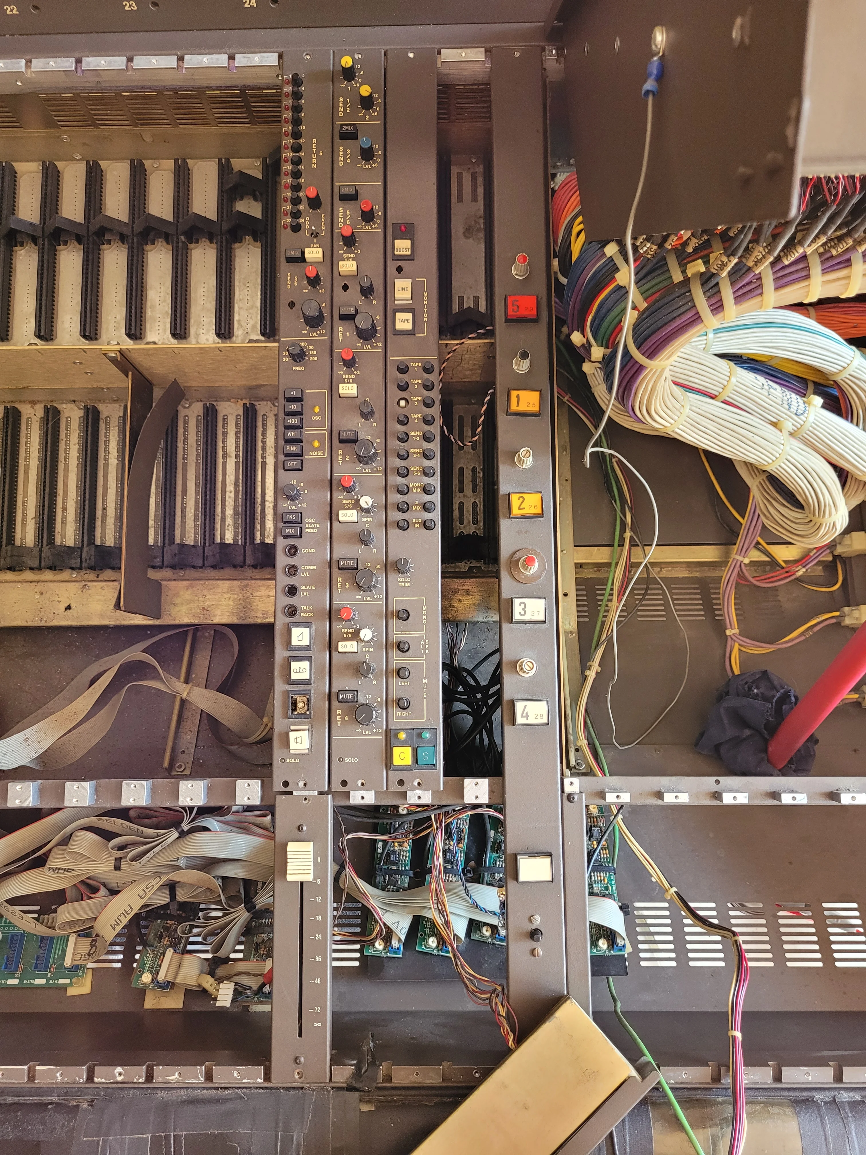

Here is the clean console.

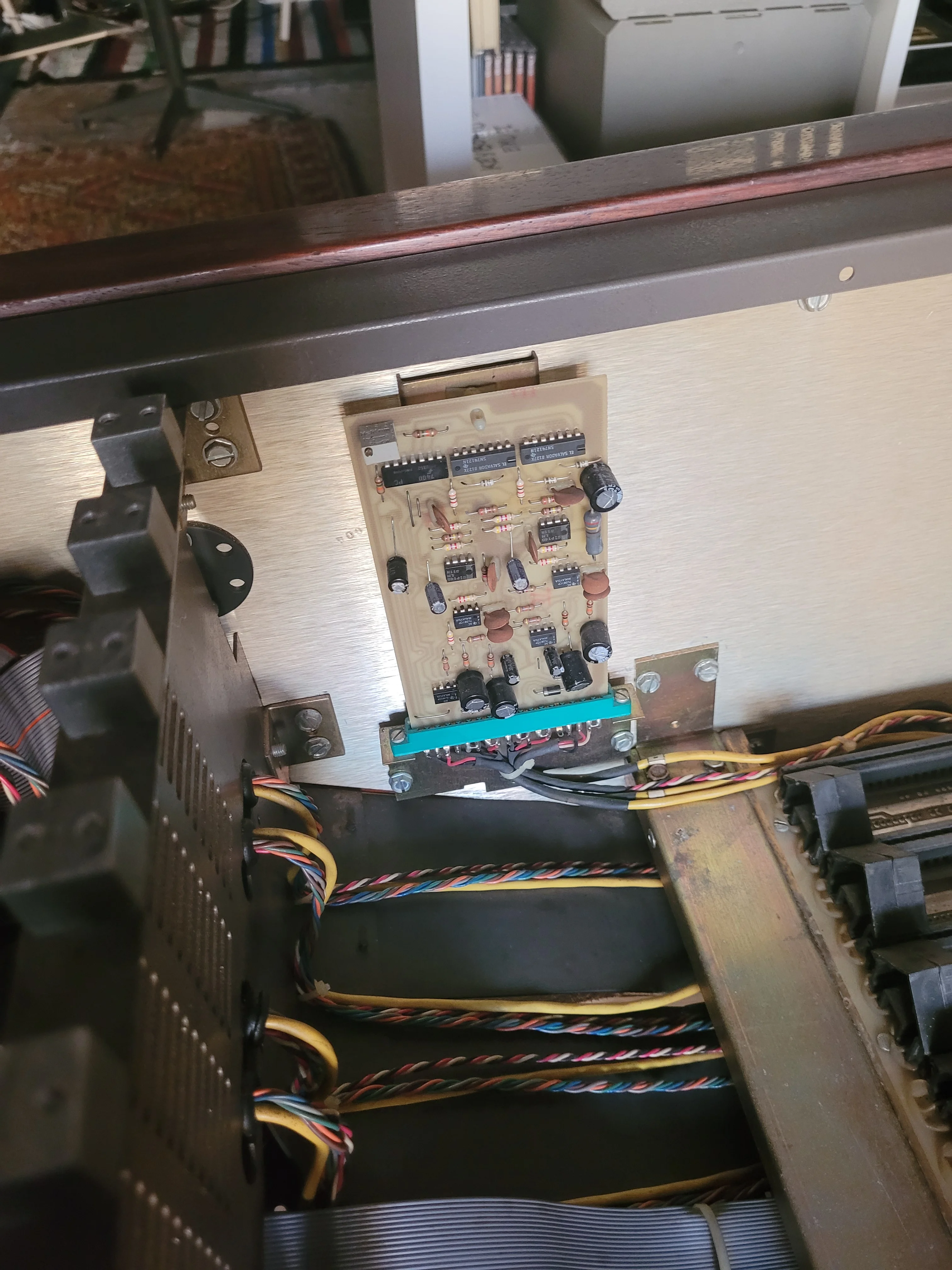

What if someone had any insight into what this card is on the left side of the console? It would be 'Bizance'
What about the -18V rail?
For bench testing purposes you really don’t need to modify the +15V supply to +18. The additional +3V is only going to provide a little additional headroom which is not necessary for function testing.
