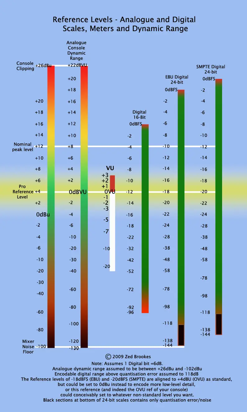

It's a gain structure/staging thing and knowing the difference between the different metering standards.
G
THank you for the conversion chart but posting it doesn't really answer the questions here. On the focusrite ISA 2, you can choose 16dbu = 0dbfs up to +24dbu = 0dbfs so if Im turn this knob all the way anti clockwise I am telling the ISA 2 that I want 0dbfs on the meter to be the same as +16dbu. BUT, after doing so, when I record something, if the meter on the ISA 2 is barely touching -18dbfs the signal is already peaking in my DAW. What else does this have to do with conversions?

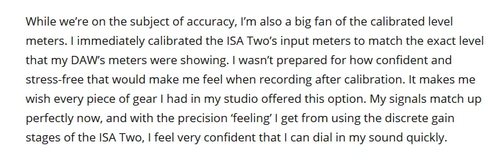

I found this on a review of the ISA 2
0db" on the meters is absolutely nowhere near 0db on the digital scale, the internal bias is so far off that the meters are unusable. Even accounting for the adjustment knob on the back turned all the way up, the meters internal bias is still set WAY too low. If you're near clipping on this unit's meters, everything else in your chain is being clipped to hell and back. 0db on this unit is like 15db in your DAW, straight distortion.
but I still want to understand this better because maybe this guy doesn't know what he is talking about or maybe he does and focusrite is to blame but then again, why are you posting conversion charts? !
This review found the complete opposite.

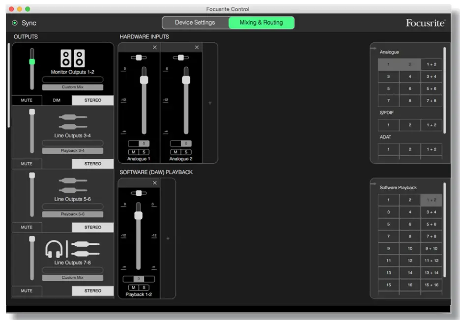

Also difficult to calibrate if final metering has no unit of measure.

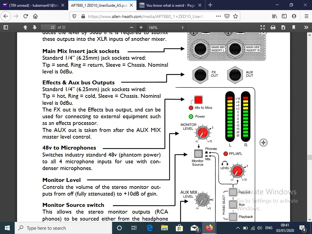

Several years ago we had a ZED10 mixer setup to drive an M-A 2496 card.
The card hits 0dBfs at about 1V rms in but the mixer has a maximum output of +21dBu (marked as +16dB on the attached meters FKs why!) Zero 'VU' on the meters is smack in the middle of the range and equates to, I guessed +4dBu out.
Thus we could not use 80% of the mixer's meter scale and it just blinked the bottom couple of LEDs to deliver an average level in the DAW (Samplitude SE8)of -18dB fs. So...I fitted two multiturn 22k presets in the 2496 inputs so I could get ZED and DAW singing from the same song sheet!
If it is desired to drive that pre amp close to its maximum I do not see any alternative to a similar fix?
