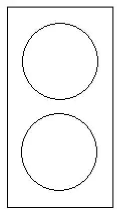

Yes simplybassy I wish to use my computer to simply convert to digital.
I just looked at the back of my computer and there is a 9 pin connector on the back with a symbol like this on it. is this my line in?
The line-in on the computers I've seen are 1/8" stereo jacks (same size as 1/8" headphone jacks).
It'll look the same as your 1/8" microphone in, but the line in is stereo and set to record at line level.
I have no idea what the 9 pin thing is.
it's not Line In, it's the connection for your serial port - what folks plug external dial-up modems into, for example.
if you tell us what your computer is, it could help a bit in guiding you.
if that's not it I'm positive I do not have a line in. I have a mic input. a speaker output and a headphone output. that's it as far as 1/8 inch.
Any more suggestions on how to go from analog to digital?
