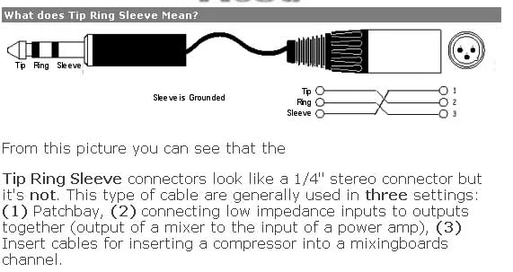

2) With a straight 1/4" plug into a TRS jack, it can send the signal to ground, instead of through the input, either at the pre or the soundcard. What kind of connector are you plugging into the soundcard?
