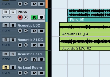

Here's a screenshot. The piano track is stereo, the two acoustic guitar tracks are mono. The stereo track has two waveforms in the timeline while the mono track has only one.
Either one can be panned, the small difference being, if you pan a stereo track you lose part of the audio. Because a stereo track is two different audio signals, one on the right, one on the left, if you pan completely to the left, you will not hear what is on the right channel.

Thanks, Chili!! Yes, I see it now: two waveforms representing the stereo field. Nobody ever explained that to me before.
